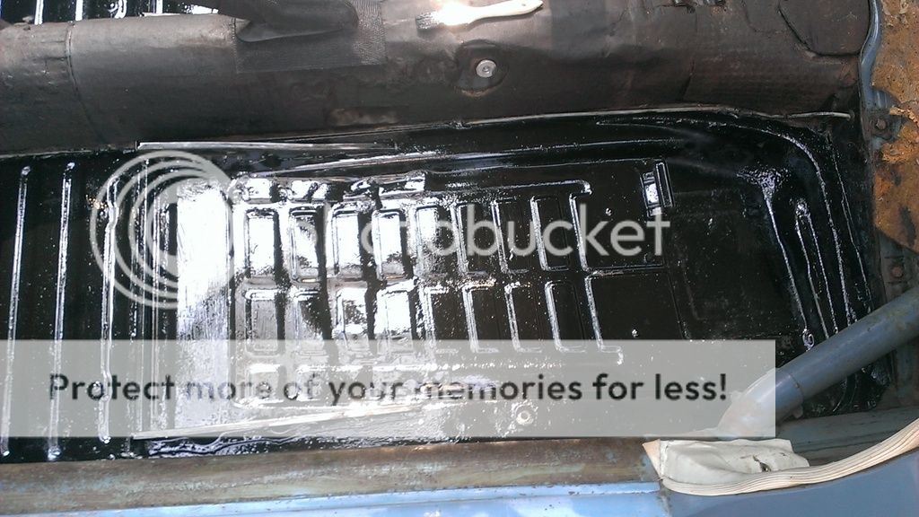

Here is a shot of the POR the heater channels seem solid so Im not planning to pull the body off the pan.

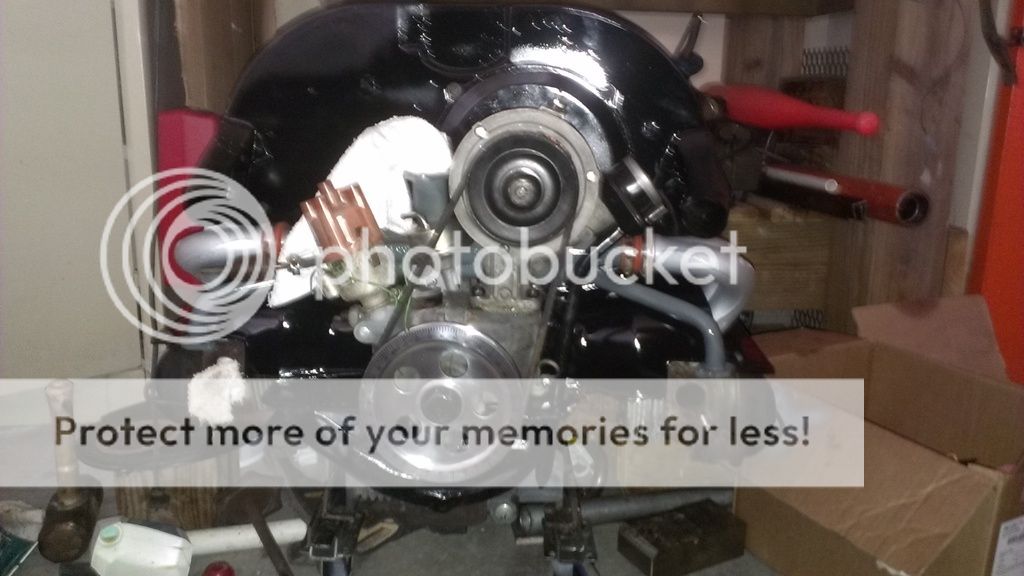

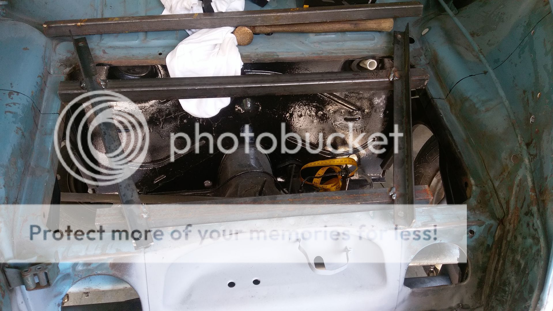

The engine let go so I got this one used off here. Im cleaning it up for now.
Im working on getting all the right finders. both fenders on the drivers side where the wrong ones. I cut the damaged apron off and replaced it with one from WW.

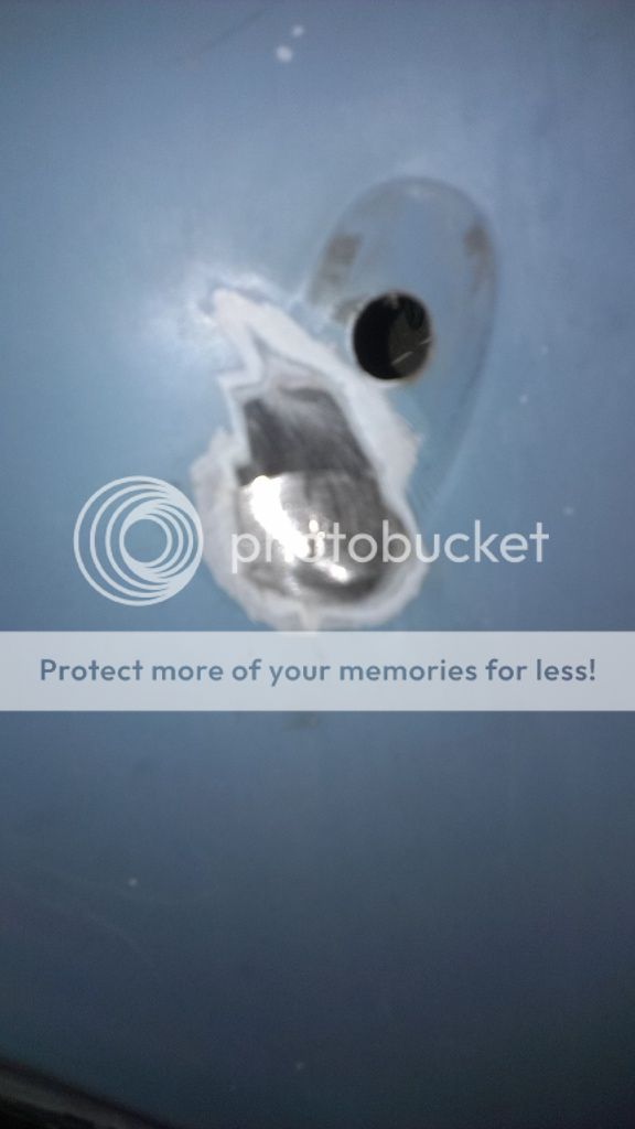

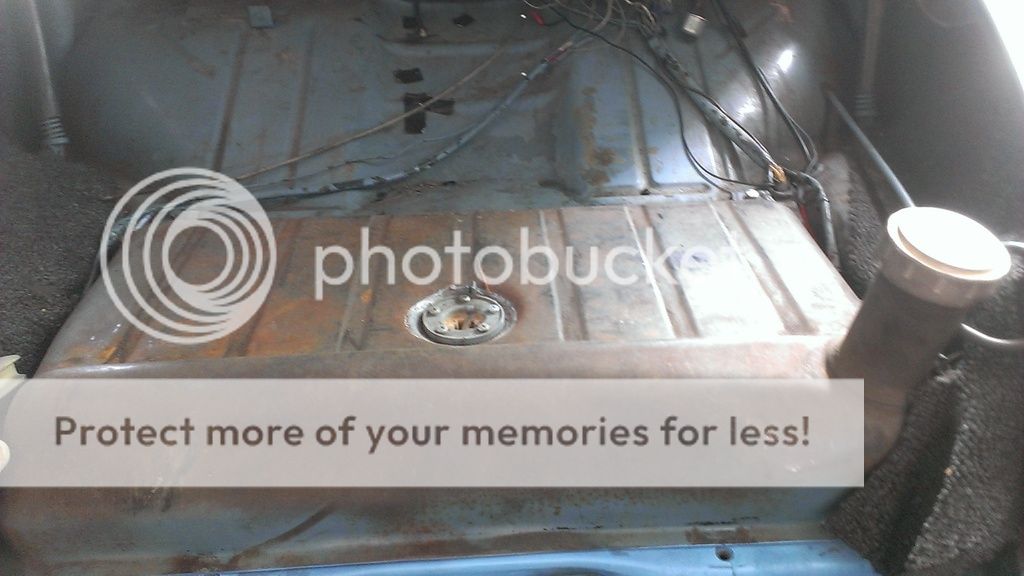

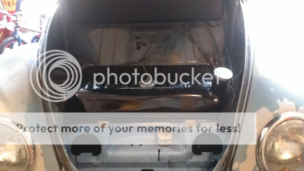

I also cleaned up the gas tank and PORed it. Nickel plated the jack.

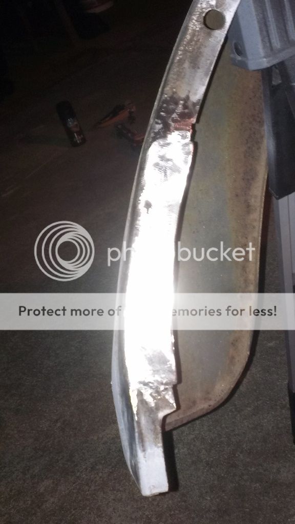

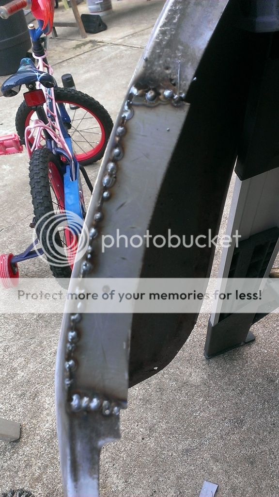

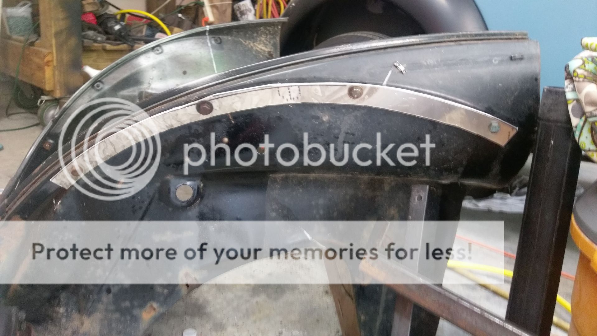

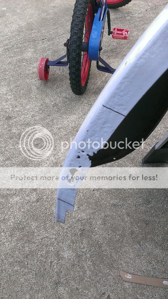

I got a front fender that needed some work. Im not the best welder but Im getting better.
Cut it out and welded a peace in
after I grinding down the welds.

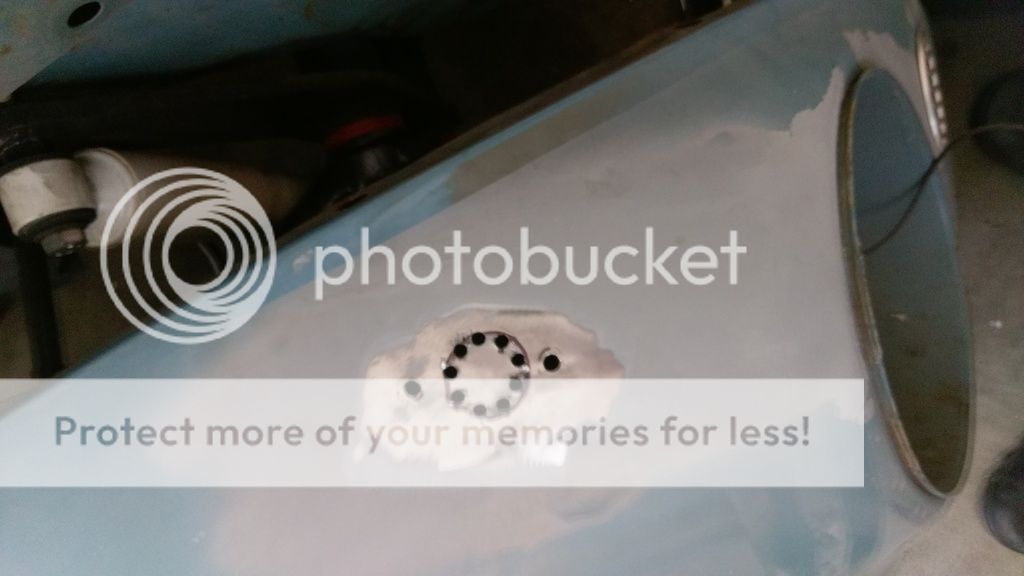

I also welded up one of the antenna holes as Im changing the style.

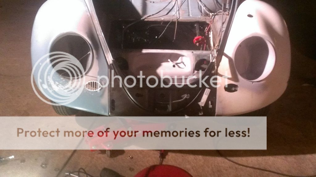

Post by Dake on Mon Oct 12, 2015 1:26 am

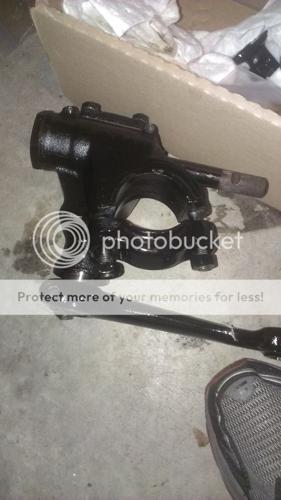

Pulled the sunroof out the rollers where shot and tore down cleaned installed new seals and painted the steering box.
The steering box was full of grease oil mix. The Bentley manual calls for 90W oil. What are you guys useing
Dake
Number of posts : 104
Location : Newnan
Registration date : 2015-05-13
Re: L390 1962 De Luxe sadan with Sun Roof
Post by Attorney Isaiah Loophole on Mon Oct 12, 2015 10:56 pm
Use the oil unless it leaks then pack it full of grease

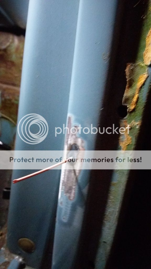

Over the weekend I got a lot of the holes under and on the dash welded up. The holes where not factory but from alarm and radio installs.

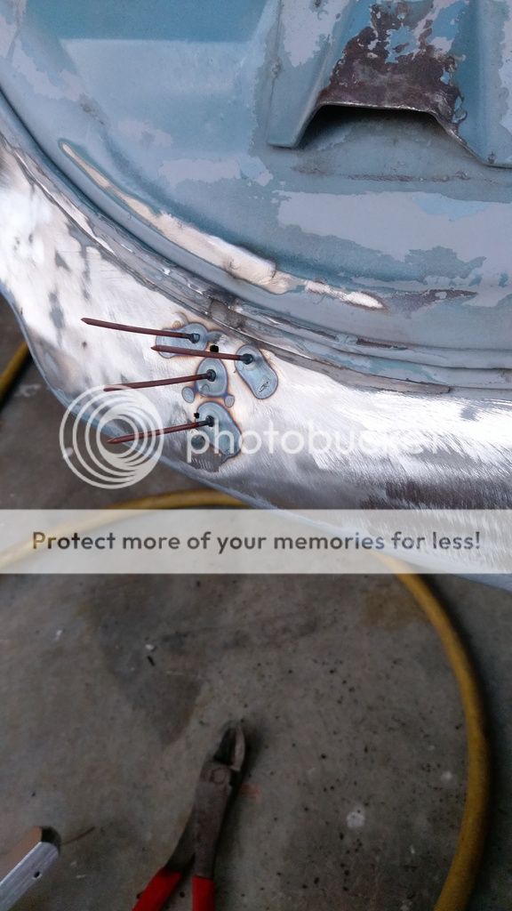

Today my pop out from Koch arrived. Still welding up the many holes from arms and radios that where installed at sometime. I just keep finding more and more. Got the wiring harness out and other odds and ends.

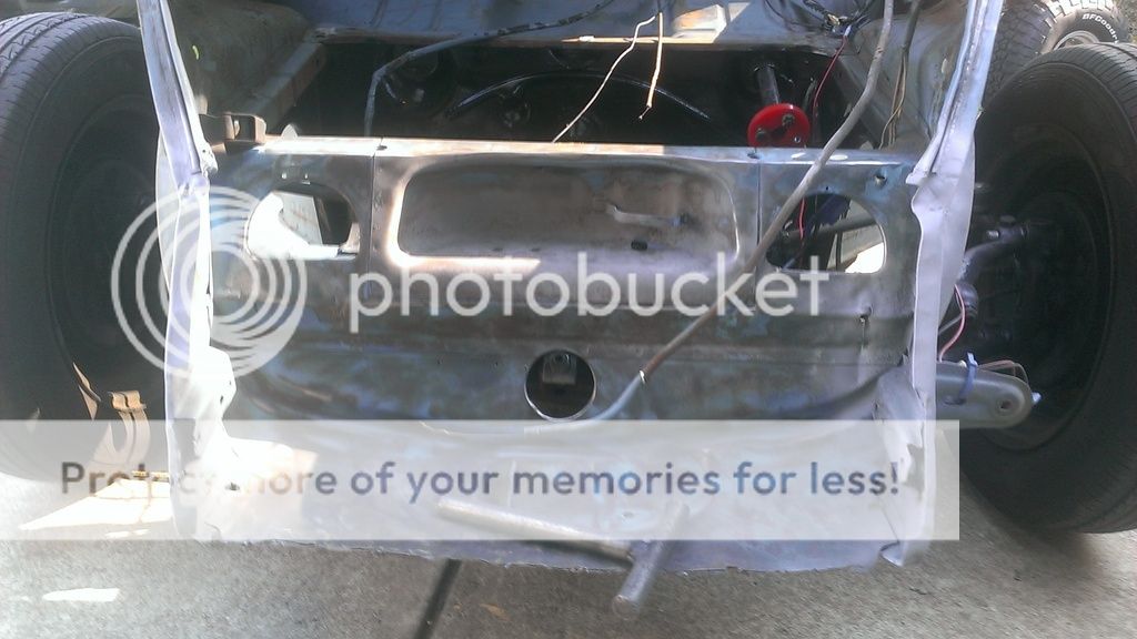

Post by Dake on Mon Aug 29, 2016 1:28 pm
I have been collecting parts. I also cold not get the front end pounded out straight enough. So I picked up a front clip from Bryce and after seeing his cars motivated me to get mine back on track. Thanks Bryce for the clip and washer bottle it was nice to meet you. I wish I had the money just to drop it off with you, But ill just have to do my best here." />

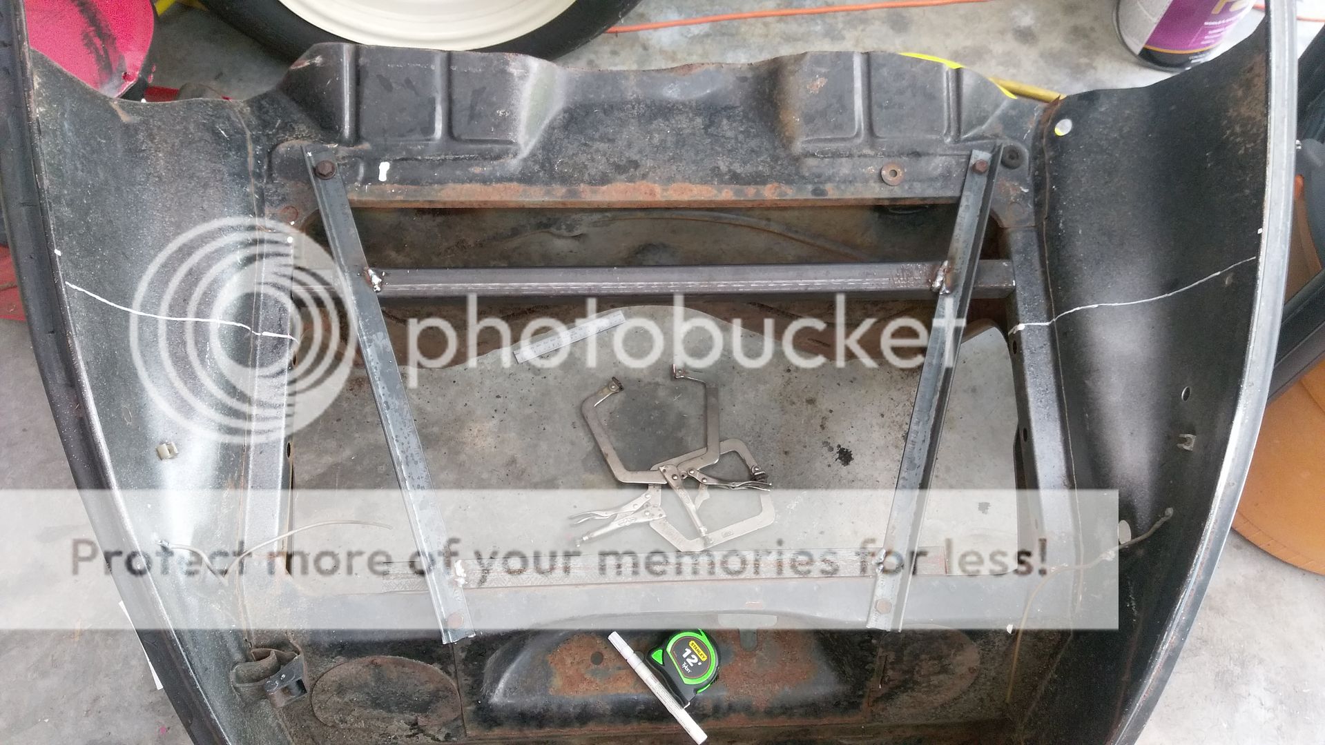

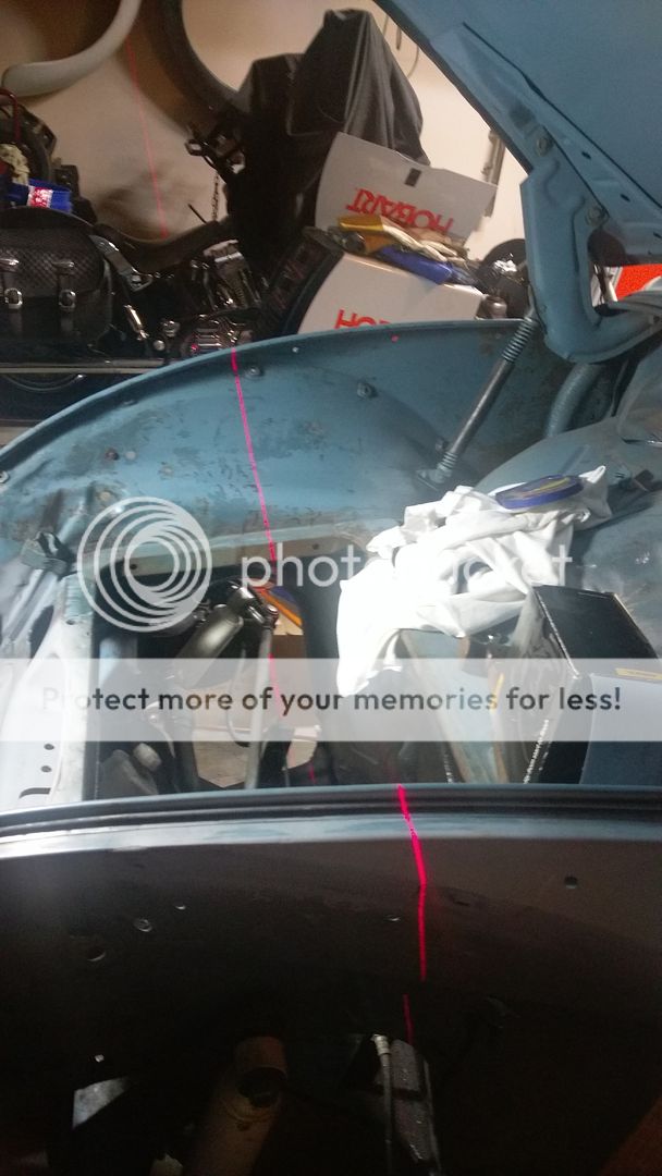

Here some pic's of the clip I got from Bryce and where im making my cut's I am open to any better ideas. [img][/img]

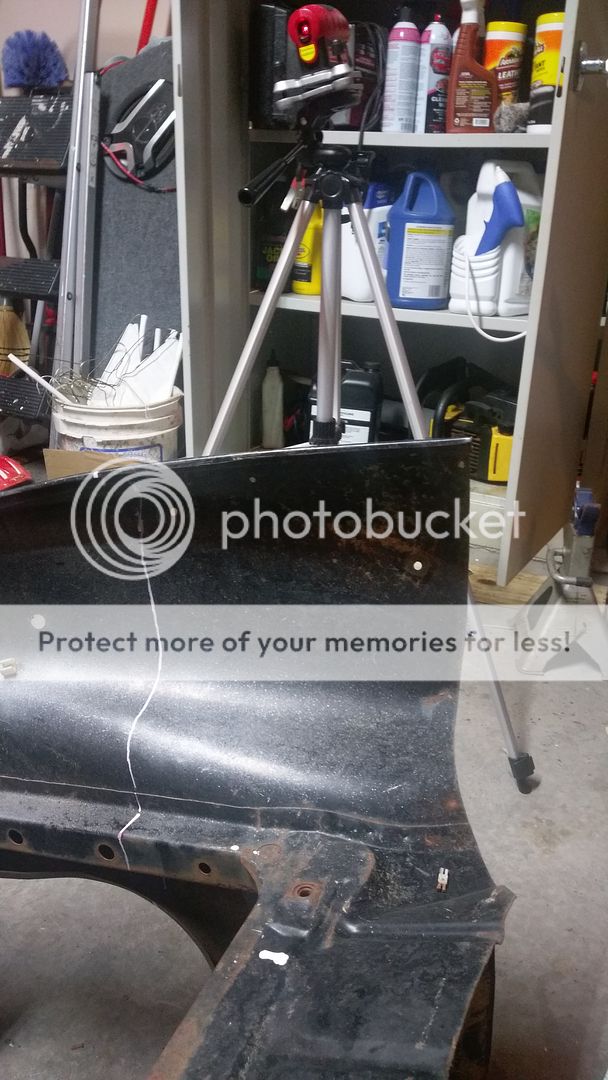

Here is the clip I plan to install. I have been doing a lot of late night measuring. Im using a laser level with three marks to line it up. Two marks on the inside and one on the outside to make sure im at the same angle on each side. [img][/img]

Post by Attorney Isaiah Loophole on Mon Aug 29, 2016 11:30 pm
I saw this thread and will probably be doing Gordon's clip something like this..... http://www.thesamba.com/vw/forum/viewtopic.php?t=610789&start=0&postdays=0&postorder=asc&highlight=front+clip
Number of posts : 4904
Post by Dake on Tue Aug 30, 2016 12:03 am
I saw that one I thought about it. Mine may be a combination of the two. I may cut the side sheet metal long to mark on the car.
