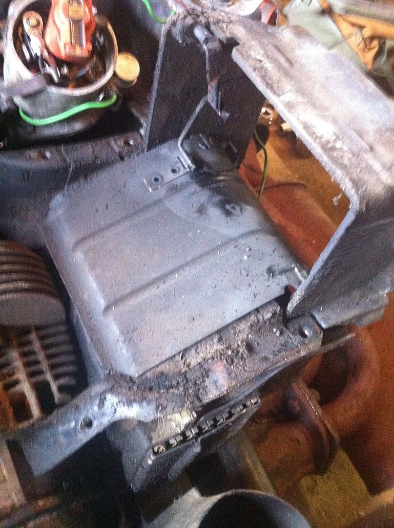

Re: 1700 thermostat/cooling flap help
Post by Greg on Wed Jul 15, 2015 4:24 pm
can you post a picture of the flaps, as they are now. Although it sounds like they are in the hot position.
Greg
Number of posts : 118
Location : Jefferson, GA
Registration date : 2010-07-27
Post by Muffler Bearing on Wed Jul 15, 2015 9:59 pm
This is how it sits when left alone.
Post by Greg on Thu Jul 16, 2015 8:43 am
I believe that is the "hot" position. that's where mine are, if you don't have a thermostat, that's how you want them to be. That way the flap can grab some of the incoming air and force it into the oil cooler.
Greg
Post by Muffler Bearing on Thu Jul 16, 2015 10:41 am
Ok, thanks.
