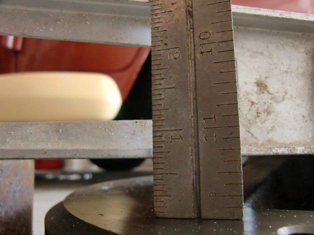

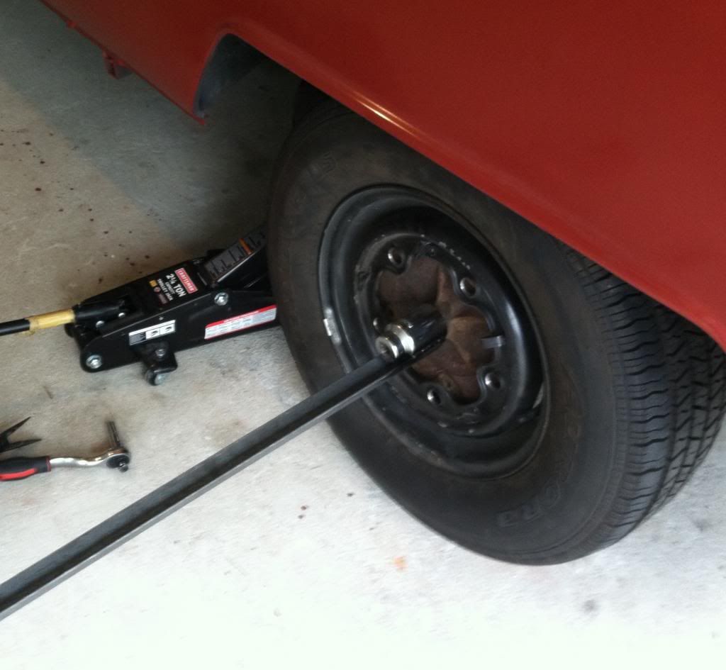

Thanks to the Bugs4Christ guys lending me a Thing drum, I'm now adding Type181 drums to this equation.  I did a test fit with a thing drum today on my passenger side.  It was EXTREMELY tight getting the wheel mounted and involved me put putting a length of pipe over the castle nut and sitting on this pipe to force the axle/springplate as I wiggled and fought to get the wheel onto the drum.  In the end I was very sweaty, but I was successful!  Would not like to do it on the side of the road, but if need be, it can be done.  Down the road, I'll change to 185/75 size tires which should help a little also.
The thing drum sticks out a lot further than the 4 lug bug drum with 3/8" wide five adapter.  Which is great cause it gave the tire a lot more springplate clearance as seen in the picture below.  I forgot to take a side by side comparison of the 4 lug with 3/8" adapter versus the Thing drum, but I did get a pic of the Thing drum vs. the wide5 Type 3 drum.  When sitting them both on spray can caps to simulate them on the outer bearing, the Thing drum stuck out 11/16" more than the type 3 drum.  I'm guessing the difference between the bug/adapter drum and the thing drum is probably around 1/2".   Before I fork over the money for a set of these drums, I'm going to do a test fit on the drivers side, just to make sure that side works as well (don't want any suprises), and I'll get the exact measurement then of all three drums in a row. (hopefully in a day or so).
Thing drum barely visible on left with a straight edge layed on top, type 3 wide 5 drum on right.
Spring plate clearance.

Ok, test fitted the drivers side today and Thing drums have been ordered!  The pipe I had been putting over the axle nut wasn't a perfect fit, so I took a 36mm socket and welded a piece of angle iron to it, and this worked a million times better than the pipe.

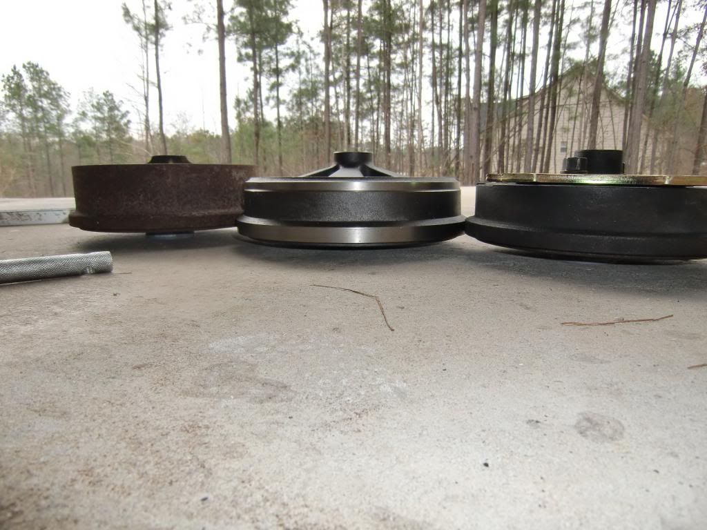

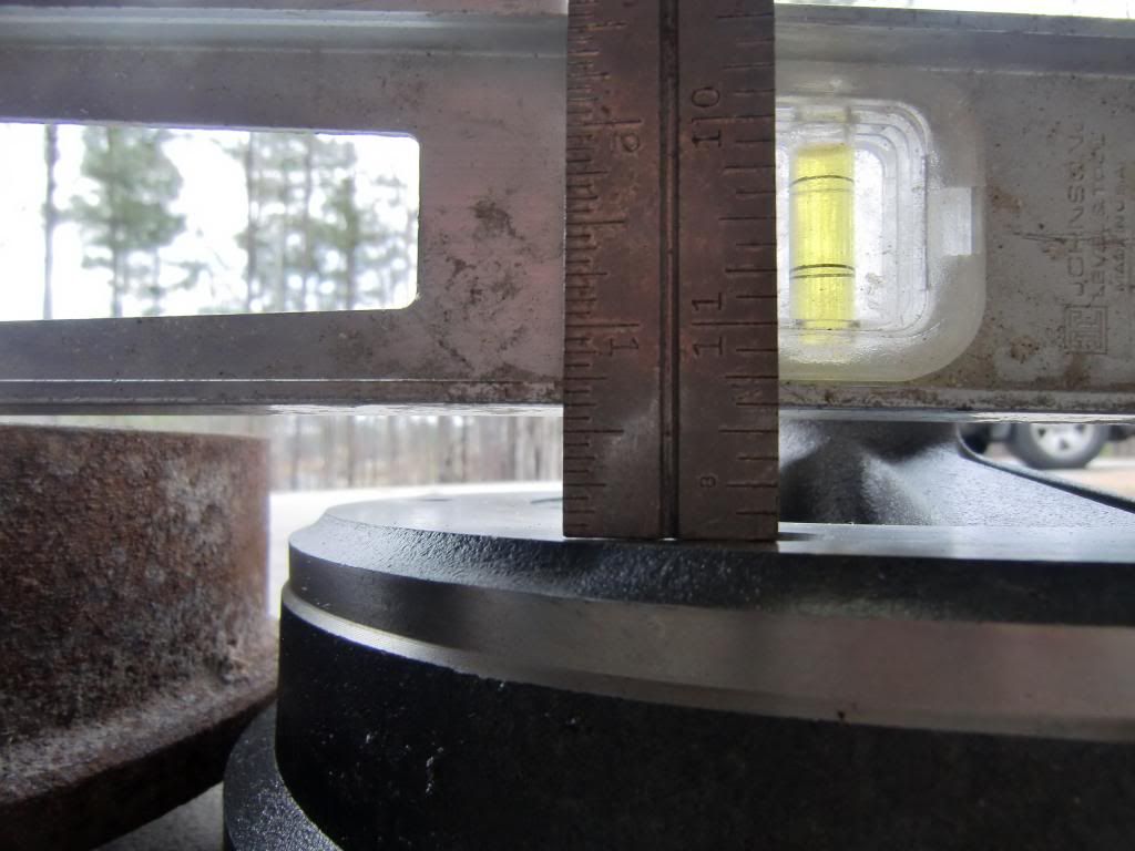

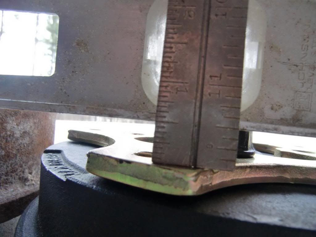

Here's the comparison pics between the 3 drums.
All three (thing, wide5 type 3, beetle 4lug with adapter)
Thing and wide5 type3 - the track of the thing drum is between 10 and 11/16ths bigger.
Thing and 4lug beetle with adapter - the track of the thing drum is 1/2" bigger
4lug beetle with adapter and wide5 type 3 - the track of the beetle drum with adapter is just under 1/4" bigger
Hillbilly drum/springplate force down tool (I need to cut it a little shorter)
