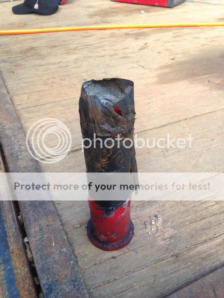

I have held my breath Long Enough. I have recently had tubs installed on my bus  and My 5th front end allignment done on my bus @ x$70.00 a pop!!! Every single person that has handled my allignment and a professional welder or two has warned me about my beam and spindles on my bus saying the welds are not burnt in and are dangerous on top of that my balljoints are falling apart on the passenger side and all these parts are new or half ass built. I have spent damn near $1000.00 on the beam and allignments combined trying to get the bus to drive correct but it appears i am gonna have to replace the entire front beam with one from somebody that can actually build a safe beam that drives straight and true. I really want to stress this issue because everyone who knows me has seen i load my bus down and travel long distances with my 2 yr old and my 10 yr old daughters as well as my wife. Moral of this story is if you cant build something safe then you should not be building beams that can pottentialy break at the spindles and jeopardize lives just so you can make a buck. I cant wait to take this piece of shit out and use it for a Boat anchor but then again its not even worthy of being a anchor its shoty junk and i am stuck with all the expense of it and driving a bus that is flat out unsafe for the road according to multiple people that are non vw realted welders and car repairmen, as well as vw related folks that have done some work on it recently. If you know whats best money wise go with Wagens West because at this point with all the money i have spent i could of had a Beam from them with no issue that was safe and trouble free.

Hello, I am known as Big K. I am a certified WELDER and have more metal fabrication skills than most. This post is not to piss people off, BUT what i have to say needs to be said. The welding done on Kale's spindles is JUNK, no. penetration, too much wire feed, bottom line is NOT a big enough welder. I have to put my foot down and say THIS NEEDS TO STOP, people's (my friends) lives are at risk. If you are going to build something for some one then it needs to be done right and safe. The beam in his bus was built too low for the ball joints to move correctly it puts them in a bind and wears them out. Its ok to build your own like that, but when you are getting paid to do a job you do it right or nothing at all and you tell the customer that. Sorry for any upset .  A welding test is in your near future!                                                                                                                                                                                                                                                                                                                                           P.S.   I could type more on this subject.

peacebug wrote:The beam in his bus was built too low for the ball joints to move correctly it puts them in a bind and wears them out.
Just curious about this? Were the adjusters clocked too much or was the problem that the bus was too low with out doing a beam raise? I mean I am not trying to get in the middle of this as I don't know either side of the story but adjusting a beam down til the ball joints bind and wear out doesn't seem to be a builders problem.....Now if the beam wont adjust up enough like the adjuster(s) is/are clocked too far then ok thats a builder problem.

Beam is adjust all the way up as high as it will go.

Sorry Bud,not looking for sympathy from anybody or being mean. Theres no tactics in trutch and facts. I would rather be the guy that saved somebody in this amazing community than be in a funeral proccesion for any of us. I live a drama free life at 38 yrs of age.Facts are Facts. No exscuses. Wonder if i should pay extra for the duct tape wrapped around my bushings to make them fit? No excuse.

Had A Question. Where can i get bushings that fit for this beam that do not require Duct Tape to fit moving parts? Anybody?.....

Empi, Bugpack,Wagens West do not carry 2.5" ID.
Re: Throwing Money at Unsafe Beam Build
Post by Attorney Isaiah Loophole on Thu Feb 27, 2014 10:06 pm
Are you sure that tube is that? Have you measured the od of the tube somewhere in the middle just to confirm tube size?
Number of posts : 4932
Post by Knumb Knucks on Thu Feb 27, 2014 10:07 pm
I called them all directly and spoke with tech support etc.
