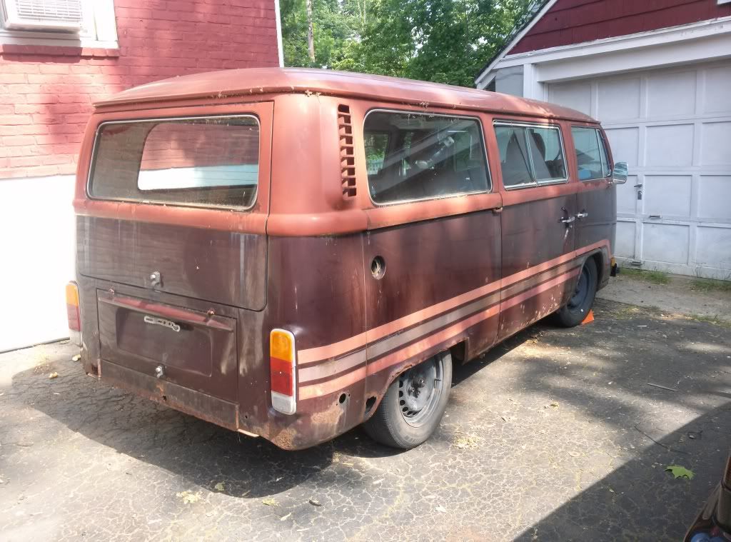

78 CE Bus VR! BVR
78 CE Bus VR! BVR
Post by bansheelos on Tue Aug 27, 2013 9:55 pm

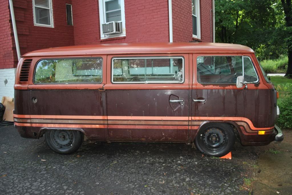

Ok I am gonna get everyone caught up w/ an insane amount of pix right now. I bought the bus wanted to make it faster. I do VR swaps like crazy so figured wth! BVR= BeaVeR or Bus VR. The bus is brown and a beaver is fitting!!! Its busted so... BUSTDBVR is my europlate and this is my build! Crack a beer and enjoy the pix! WARNING PIC HEAVY!!!!!! Didnt get into all the odds and ends just took all the pix of the build.

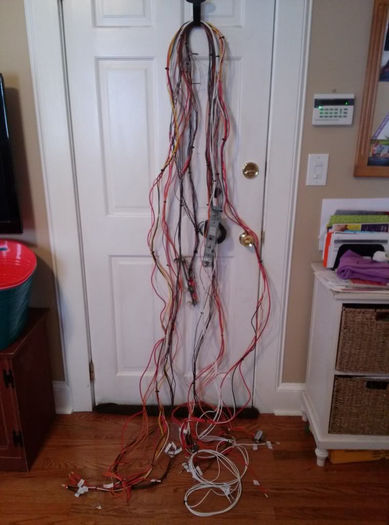

This is what I am left w/ after sifting and weeding out the cancer in that harness! Ready for friction tape!

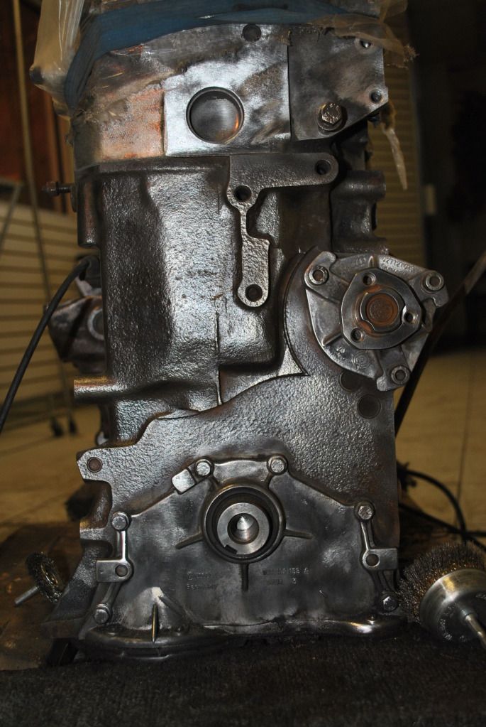

Im getting the engine ready to sandblast, paint and refresh!!!

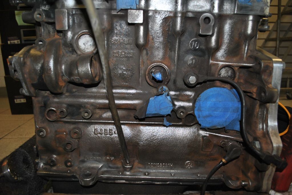

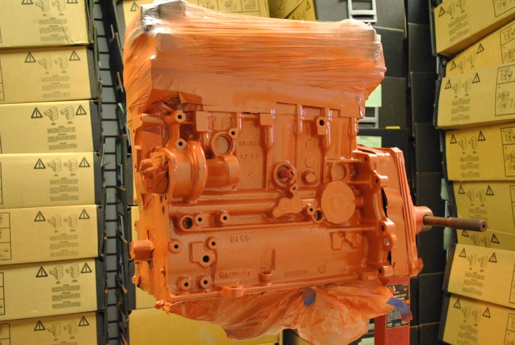

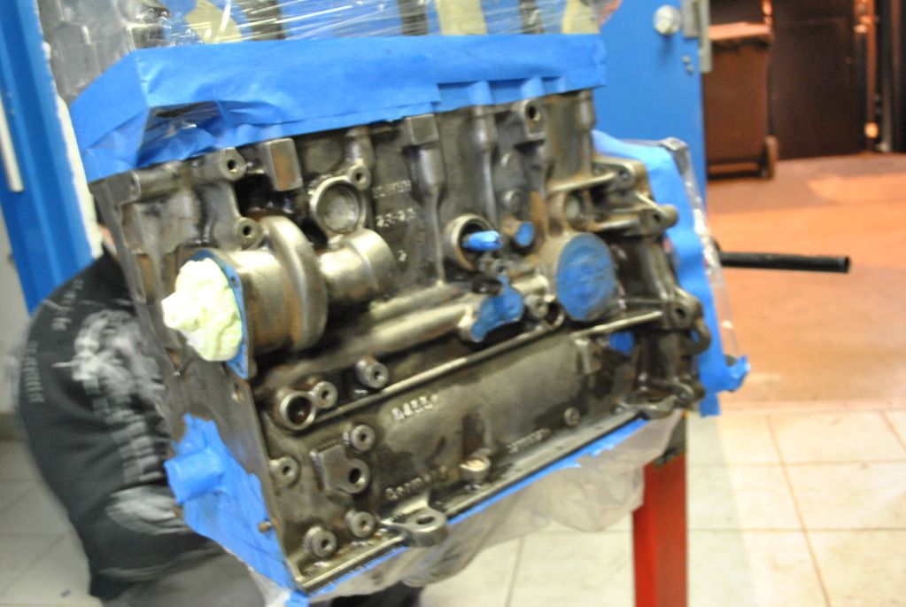

Getting the engine ready to prime and paint!
Hey sexxxy, looking good 2 days later!

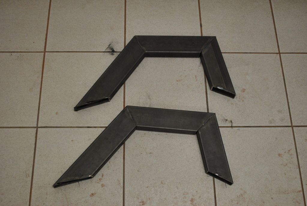

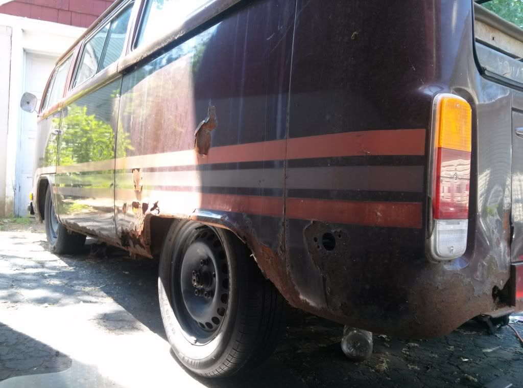

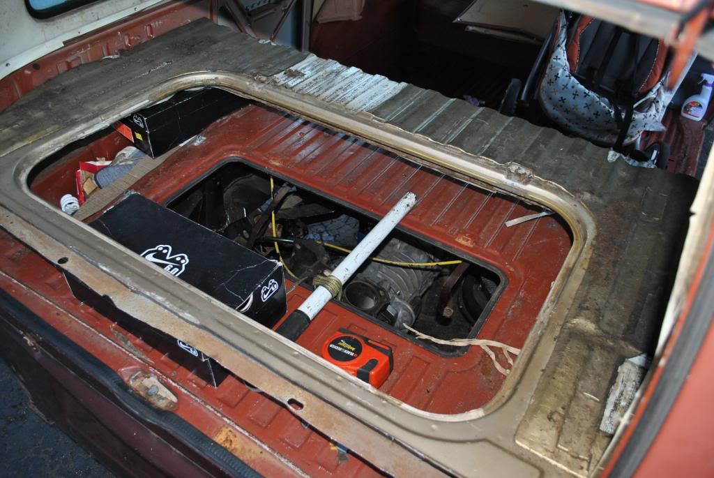

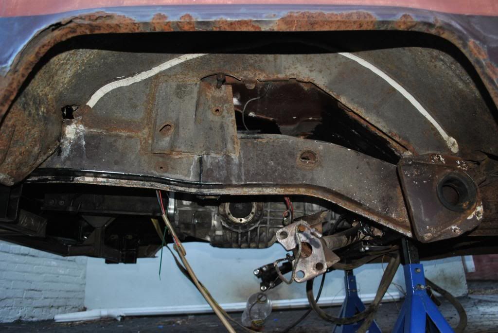

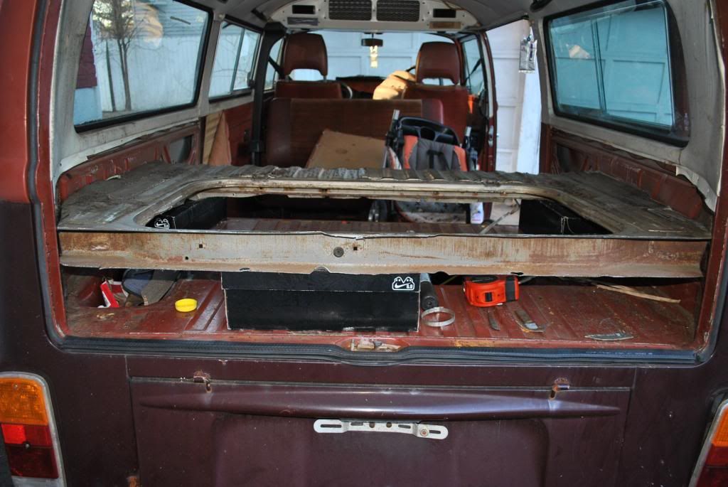

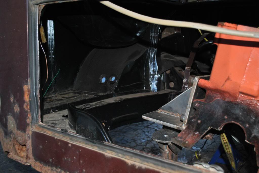

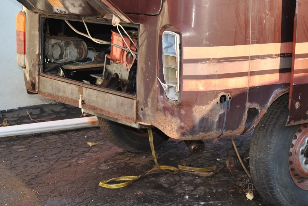

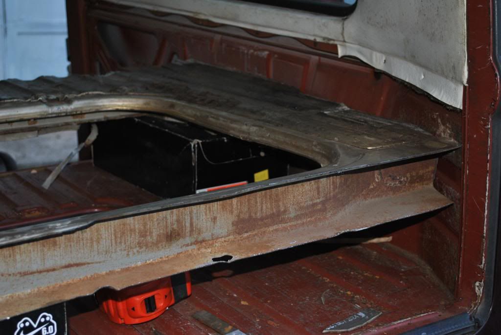

Got my monster notches for the rear cut up, now they just need to be welded up!

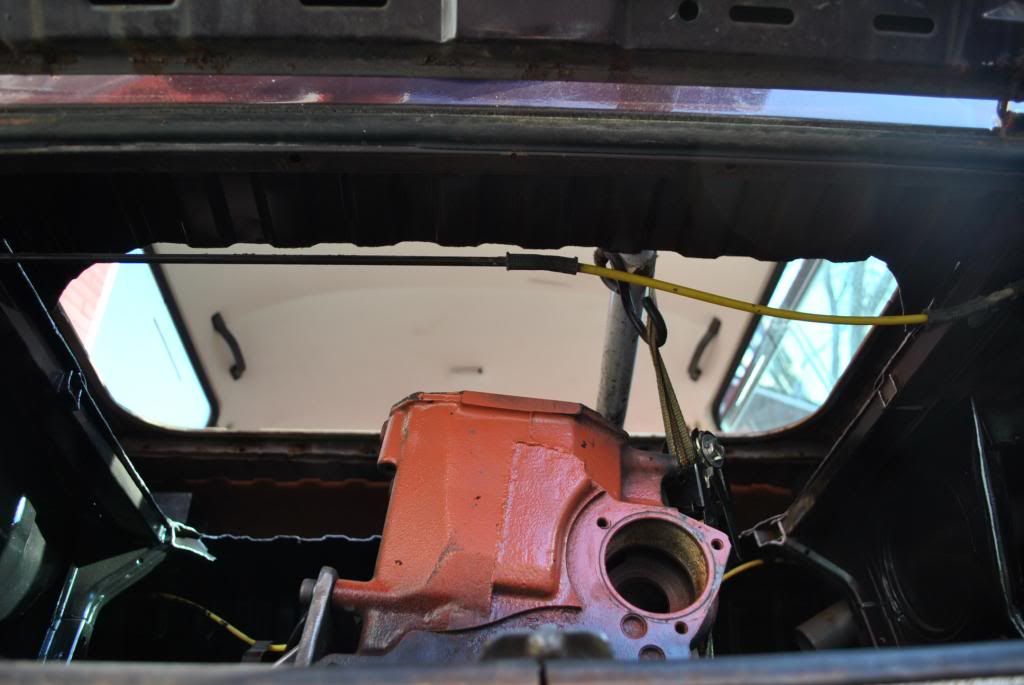

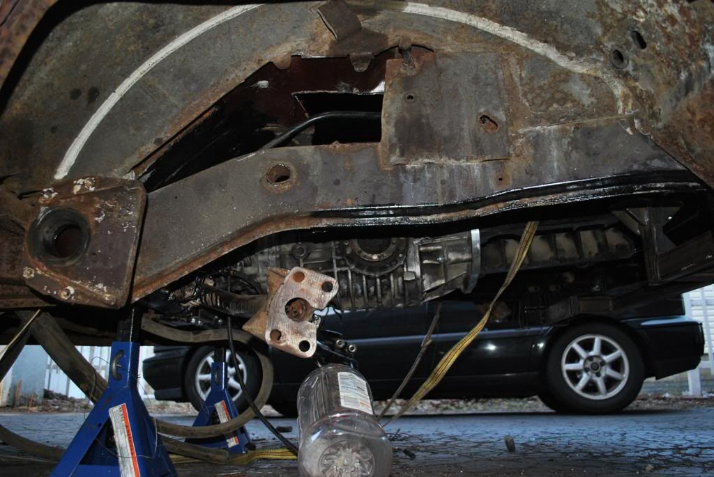

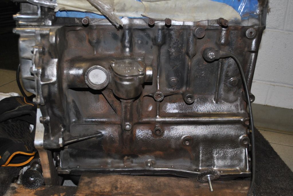

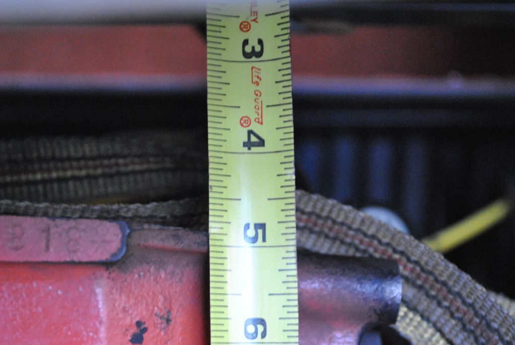

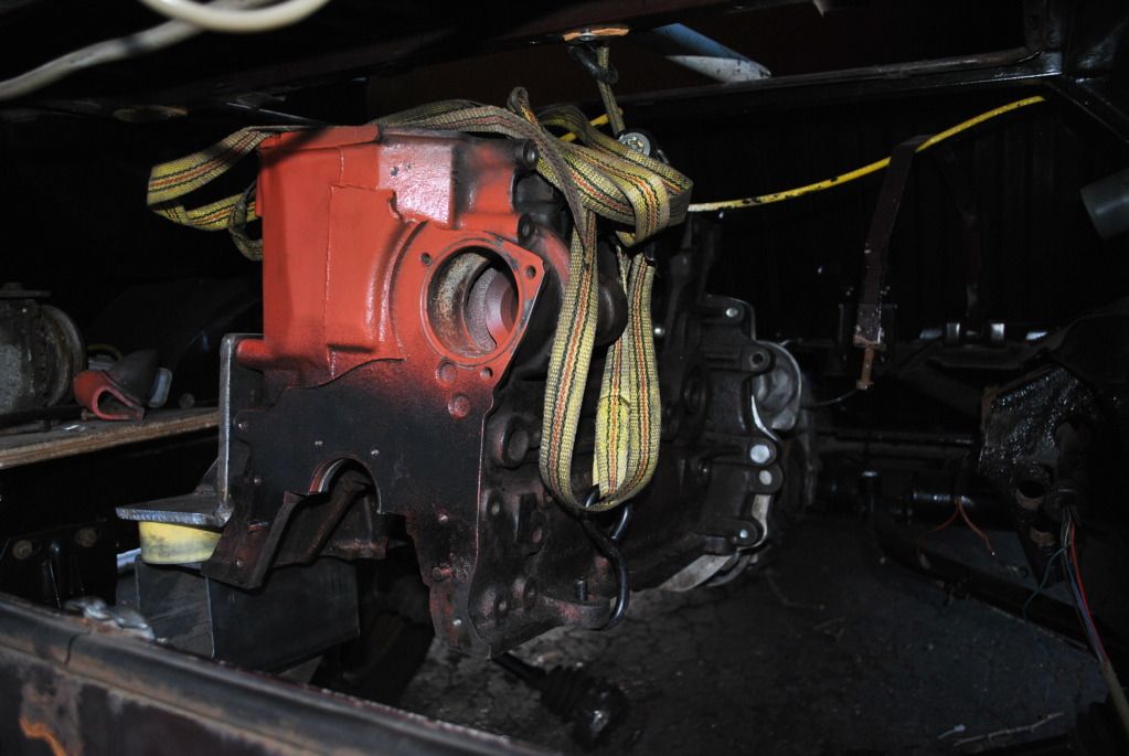

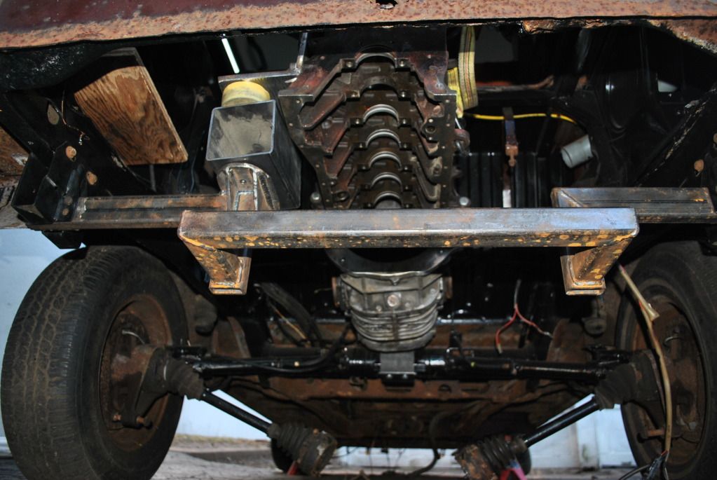

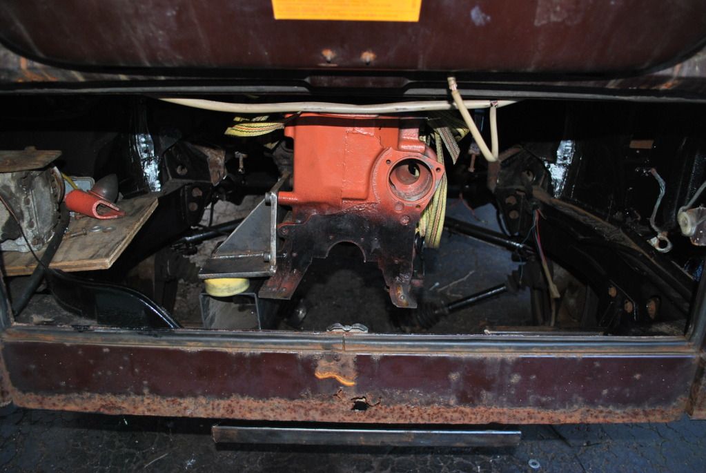

So I got up early on Sat. and started to mock up the engine/trans raise and came up w/ this.
Boogie is not impressed lol

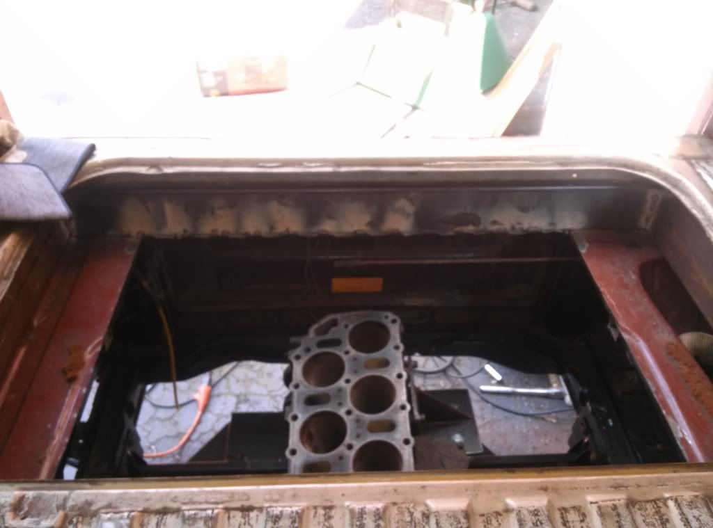

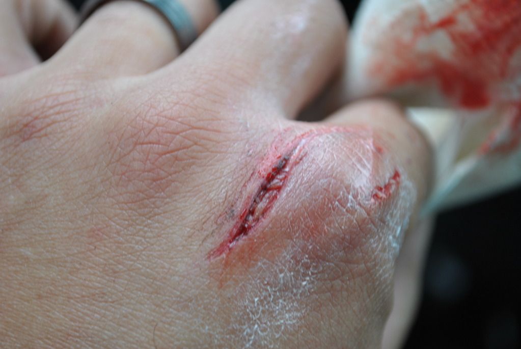

So I got the cutting for the eng/trans raise done so I wanted to get the block mated to the trans and cut up the vanagon decklid, so I figured I would cut the lid first then move on to mating the block. I got the lid cut to size when all of a sudden the angle grinder skipped up and was in my glove and did this.
4 stitches later I was pissed that I didnt get the block mated sooooo I took a vicodone that night, went to the in laws for dinner the next and then slapped the block on the trans w/ 1 good hand lol

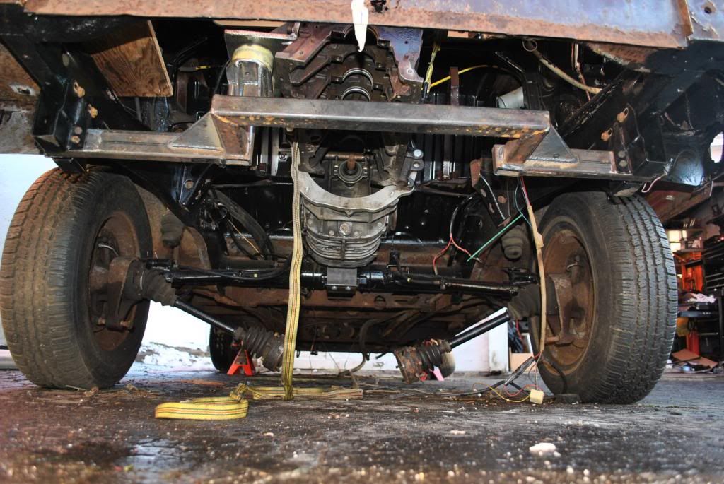

Granted the pan is not on but it will disappear behind the bumper. Gotta cut the moustache bar down.
Just a reference to see where the block comes up to on the stock decklid.
That was the ending to my eventful weekend, full steam ahead!!!

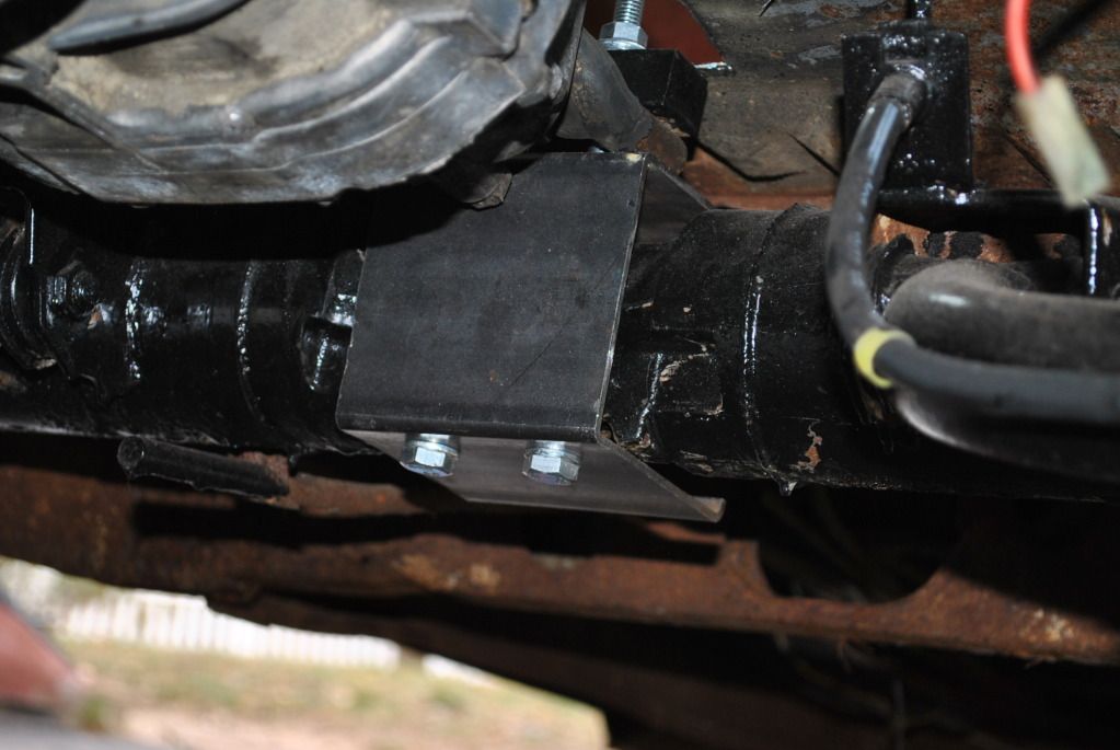

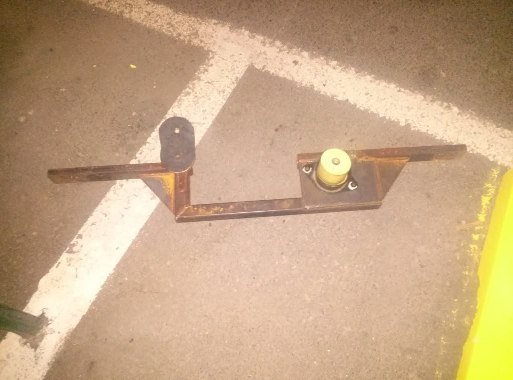

Got the finalized bar bolted up. Gotta make another mount bracket on the passenger side. But looks pretty good!

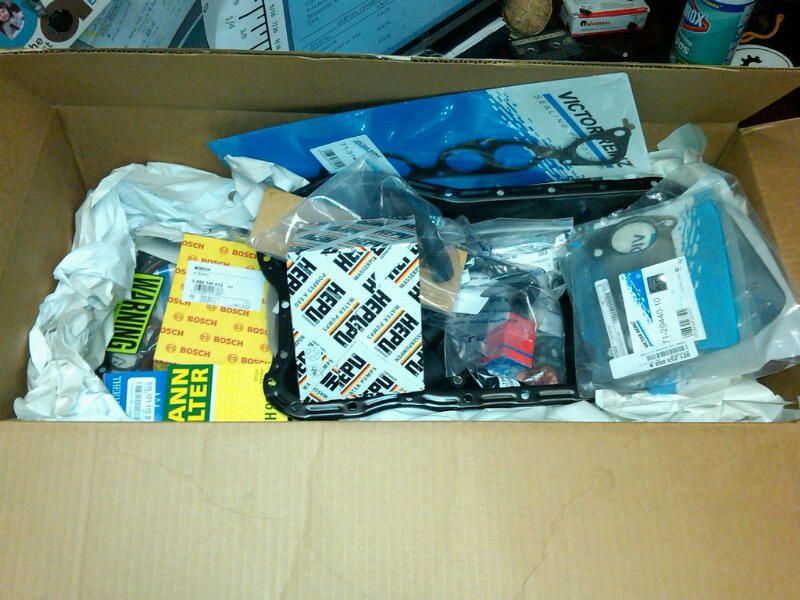

First 2 boxes of goodies came. Delcity on monday and Wagenswest in 3wks!!!!!!!!! 👍👍🍿

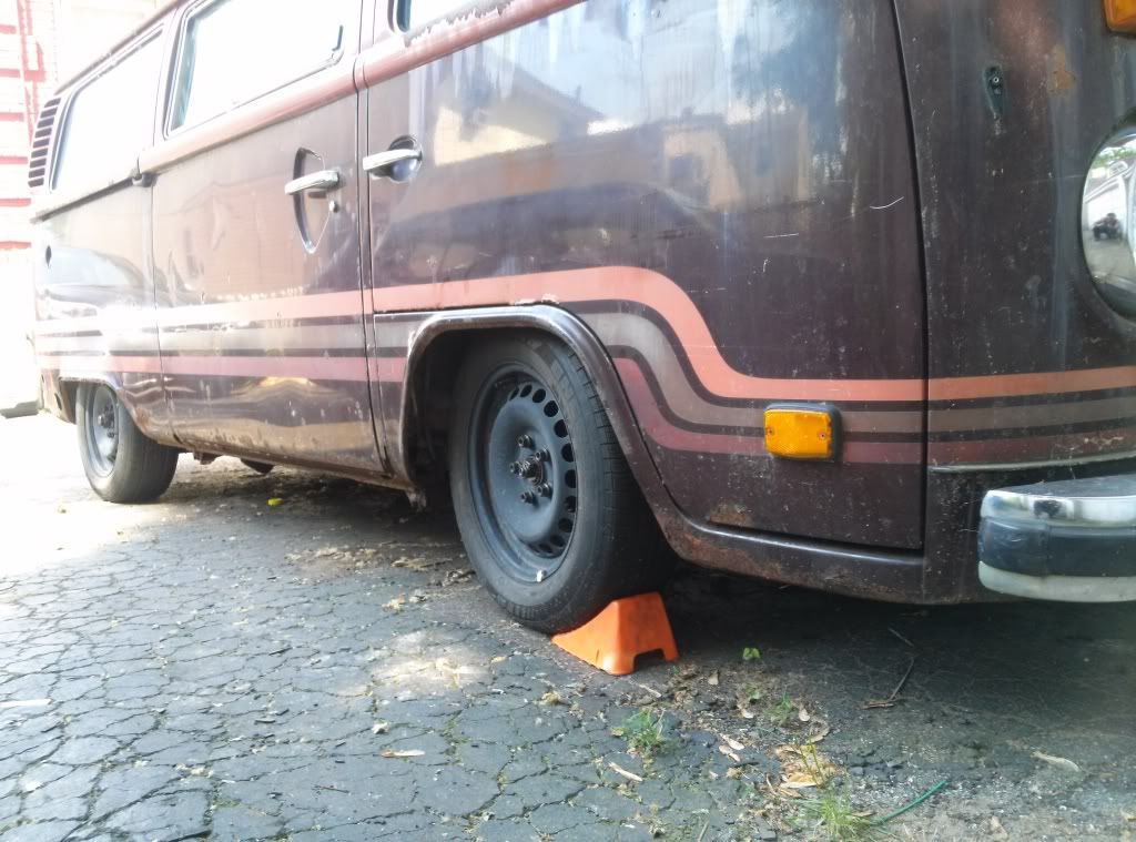

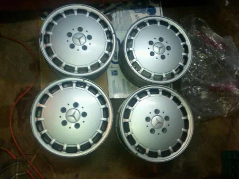

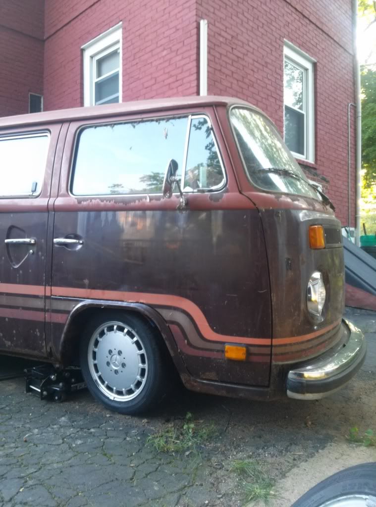

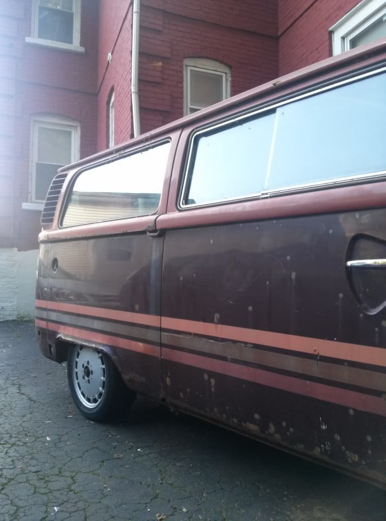

New wheels for the BVR. Thought it was a direct fit but I didnt do enough research. Gotta do some things to make them fit.
4x4 status lol
Driver side ready for the notch
Pass. side is ready for the notch

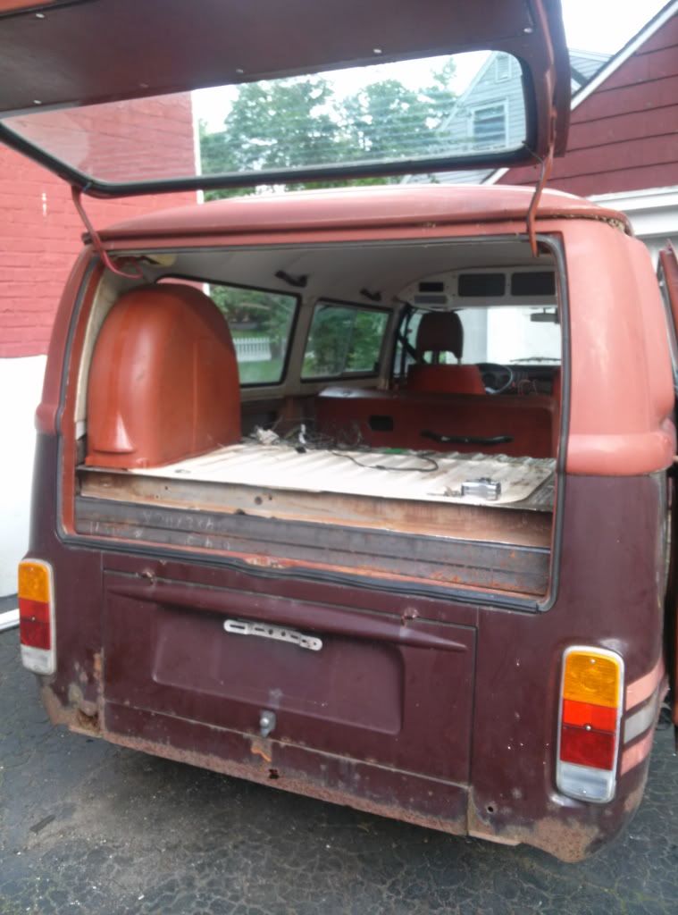

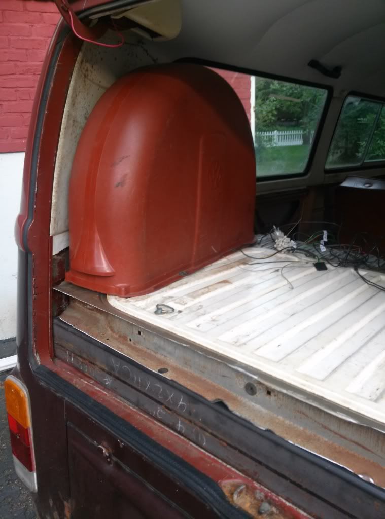

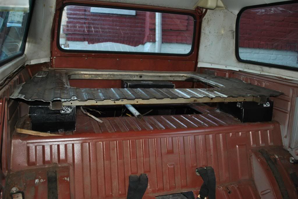

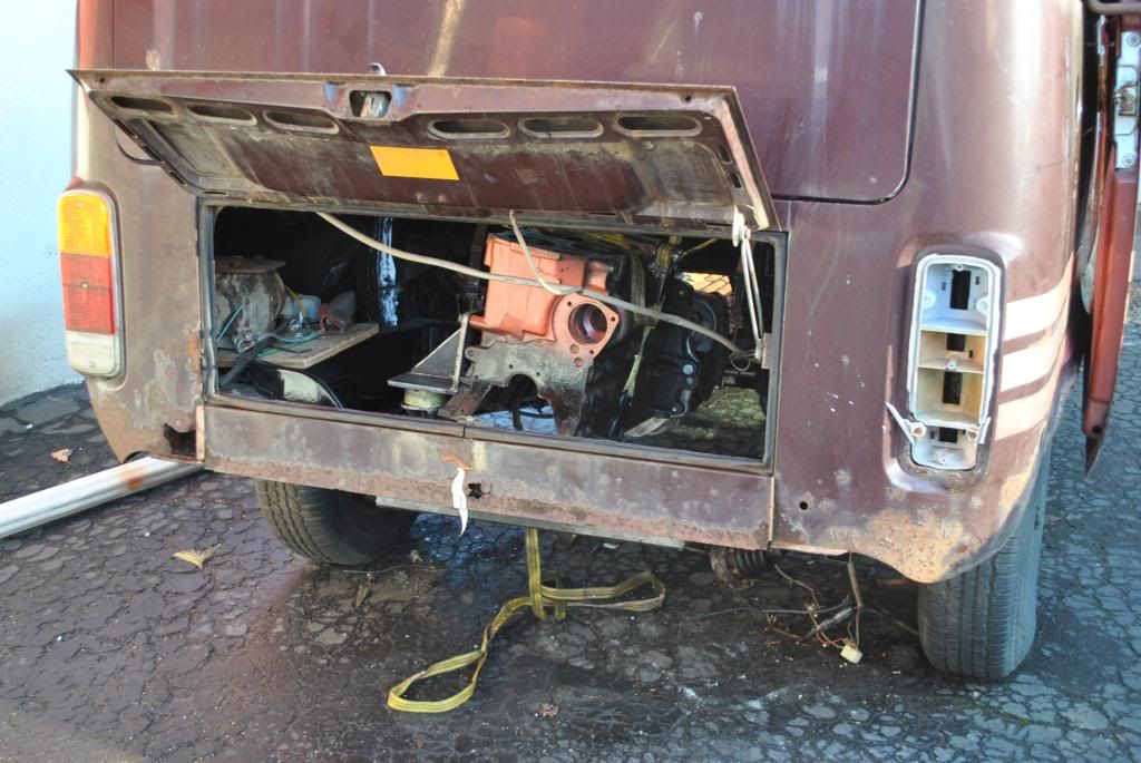

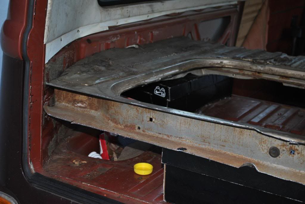

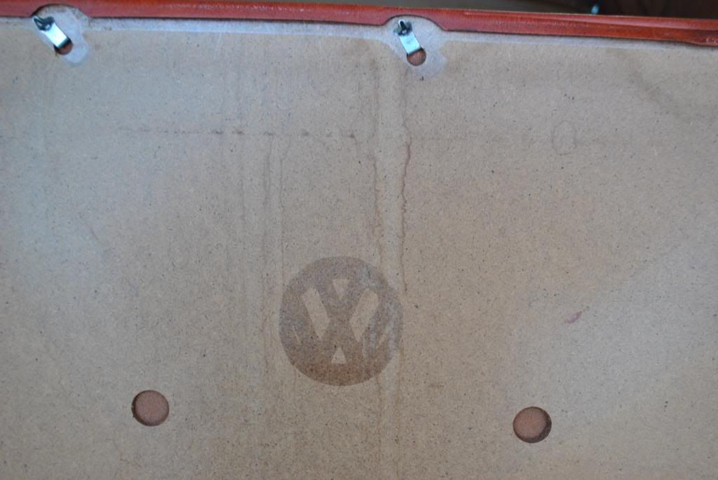

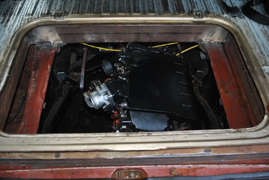

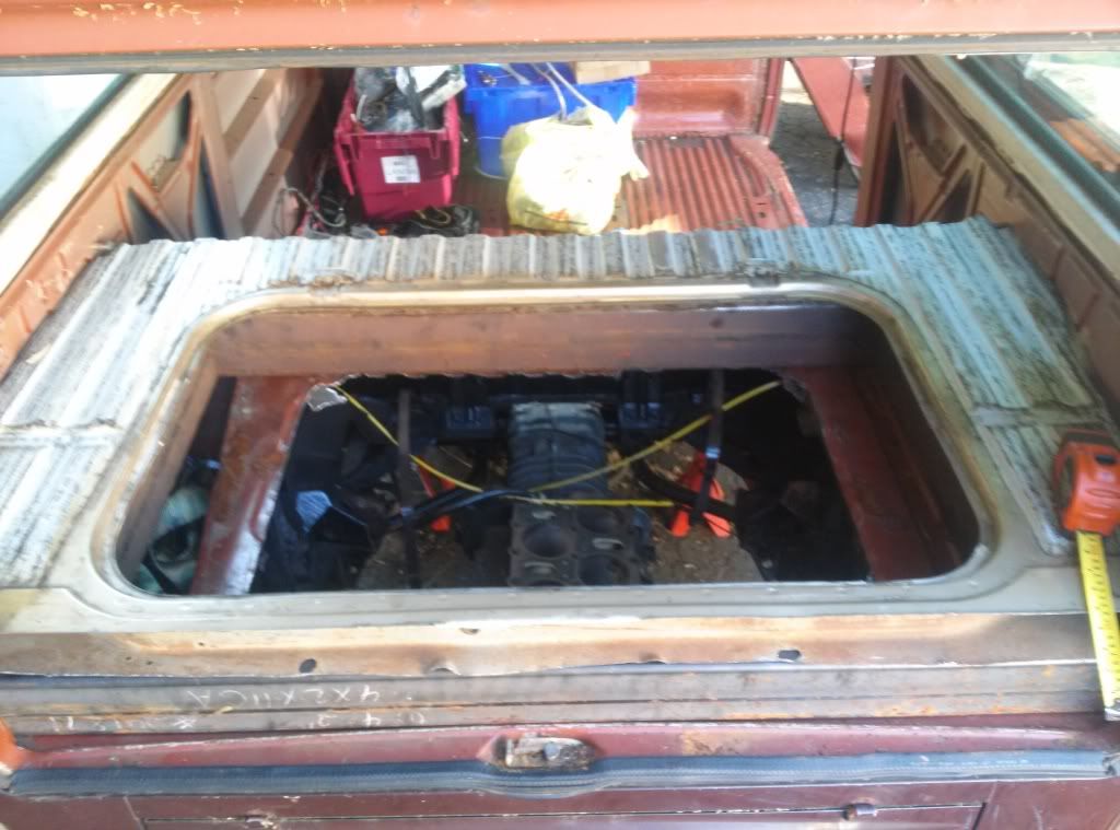

Started to test fit the vanagon decklid and came across these on the back of the panels. Pretty cool I thought!
Decklid

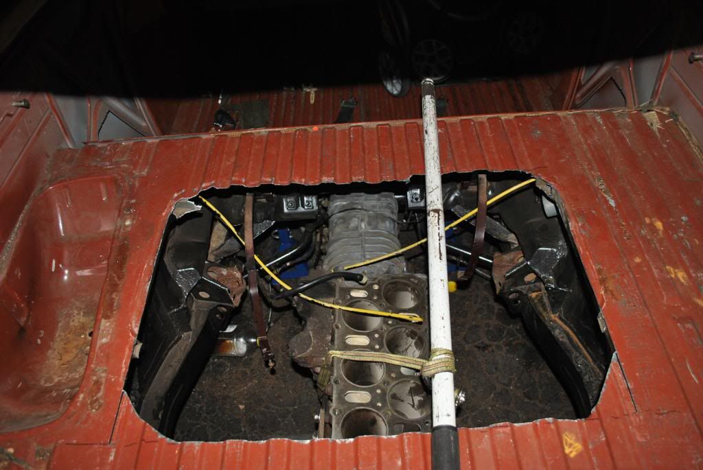

Look at the size of that hole! I went from virgin to porn star status! lol
My BVR is getting dusty!

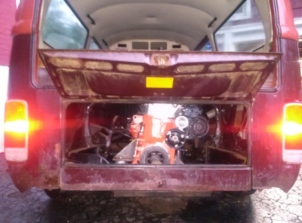

I cut it Gilbert!

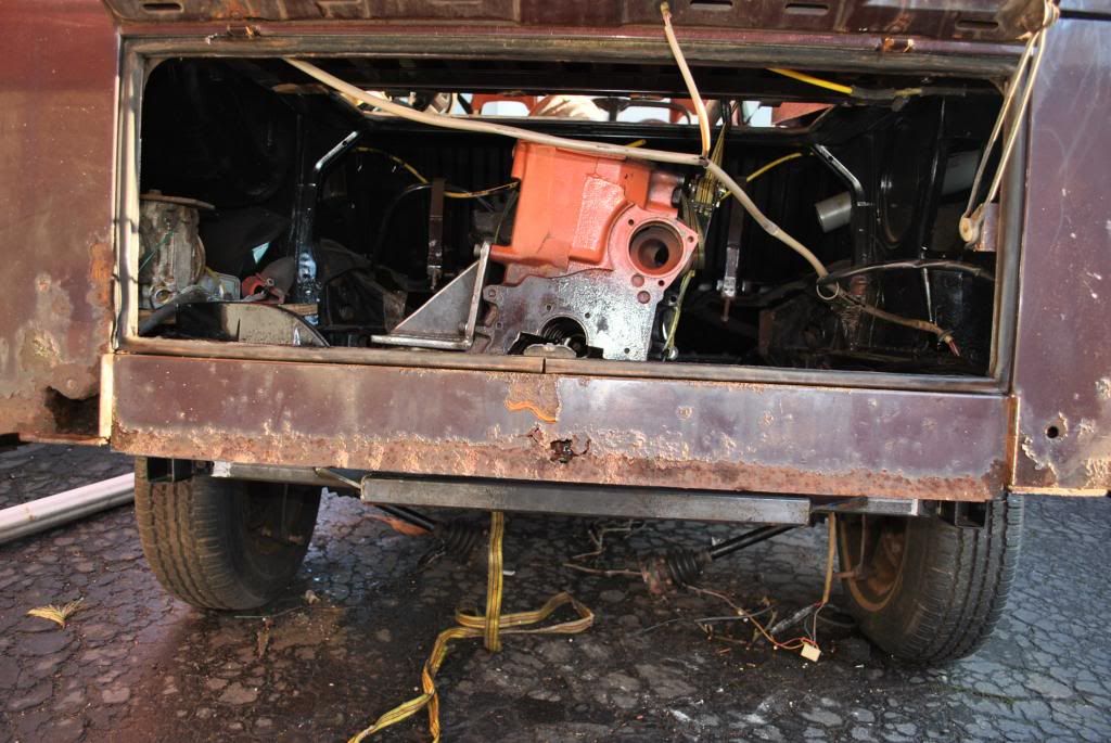

Back end

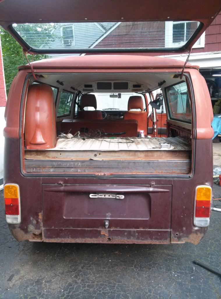

Got the seat in and...
Fits like a glove!
Soon

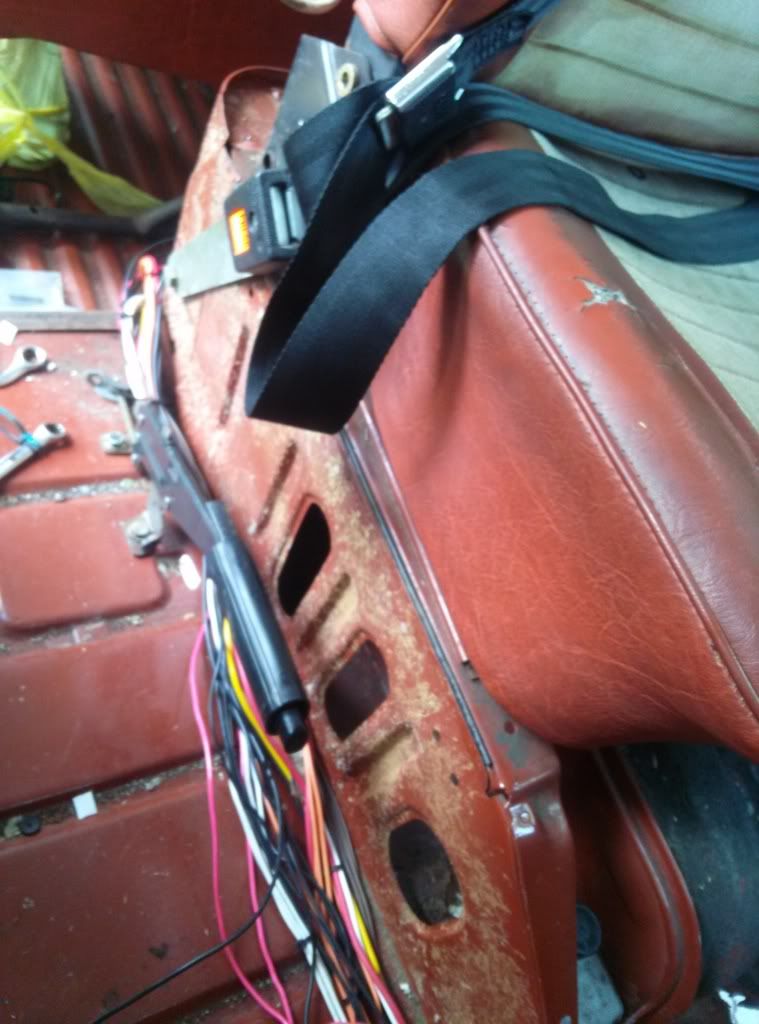

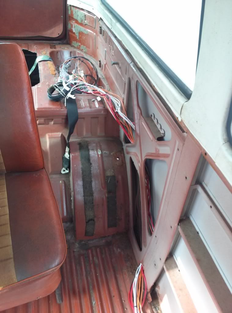

Harnesses are a go. Over.

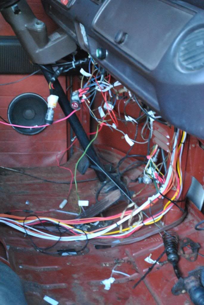

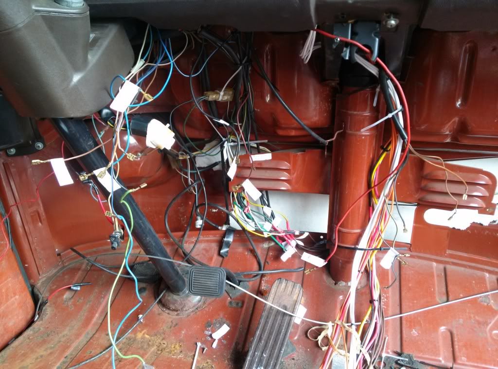

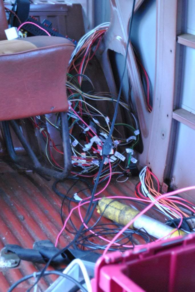

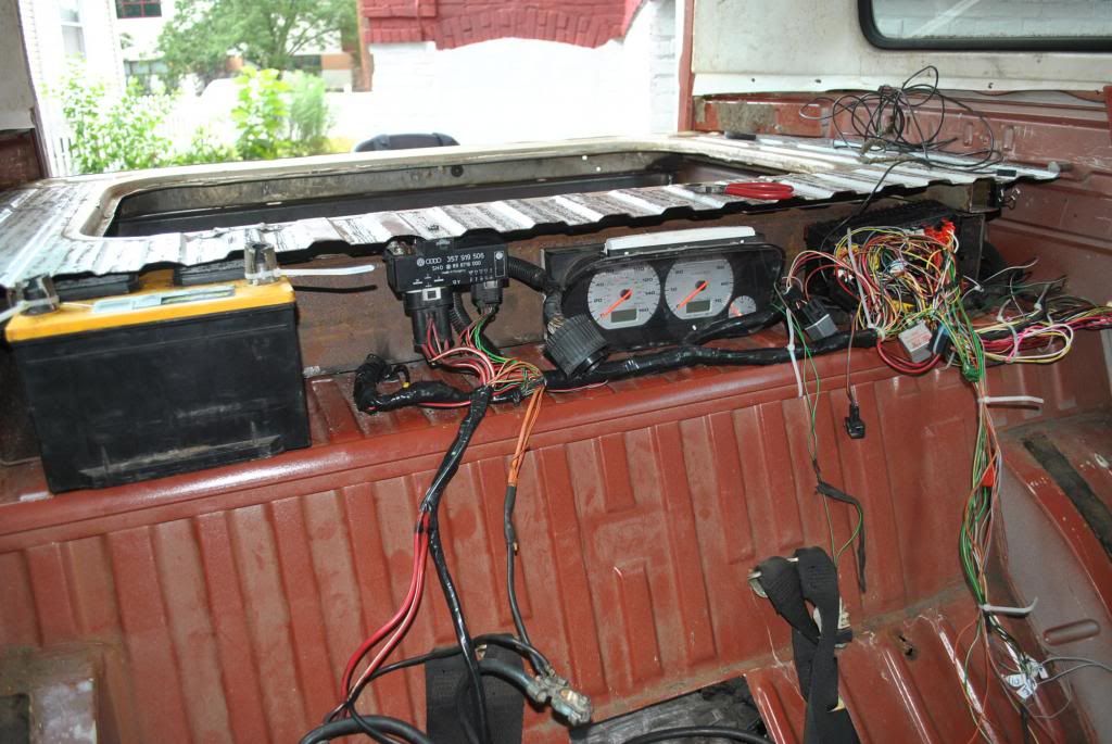

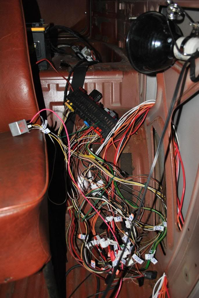

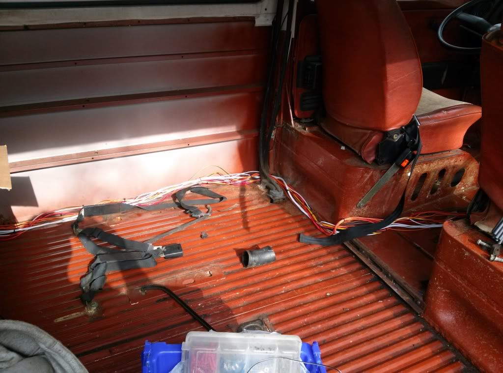

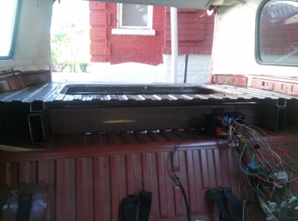

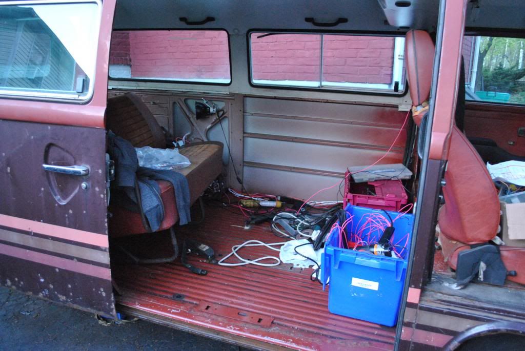

Wiring this weekend was a beach but I got the majority of the wiring ran from the front to back!

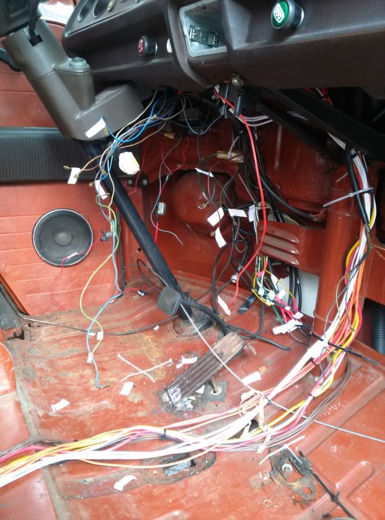

In the lab w/ wiring! Got the headlights (low beam), parking lights and hazards working. Onto the high beams and turns.
The Lab.
Makin' it happen
The rear
The product!

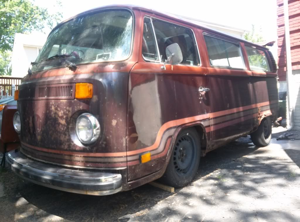

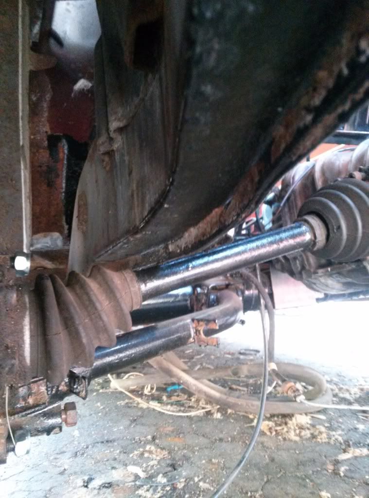

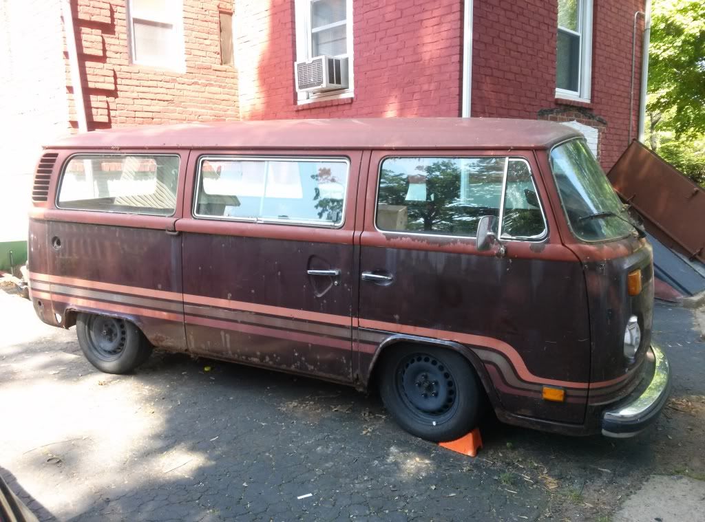

Before (stock)
After (beam and dropped spindles)

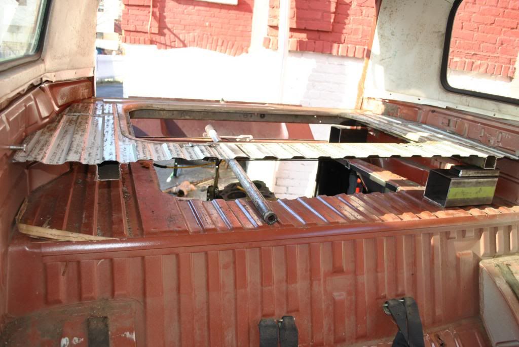

Productive day. Got her on all 4 wheels and started the box out for the decklid
Gonna need that notch stat lol
Boxing it out!

Almost done w/ the bar!

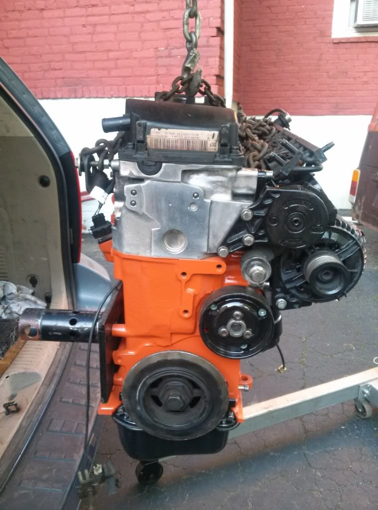

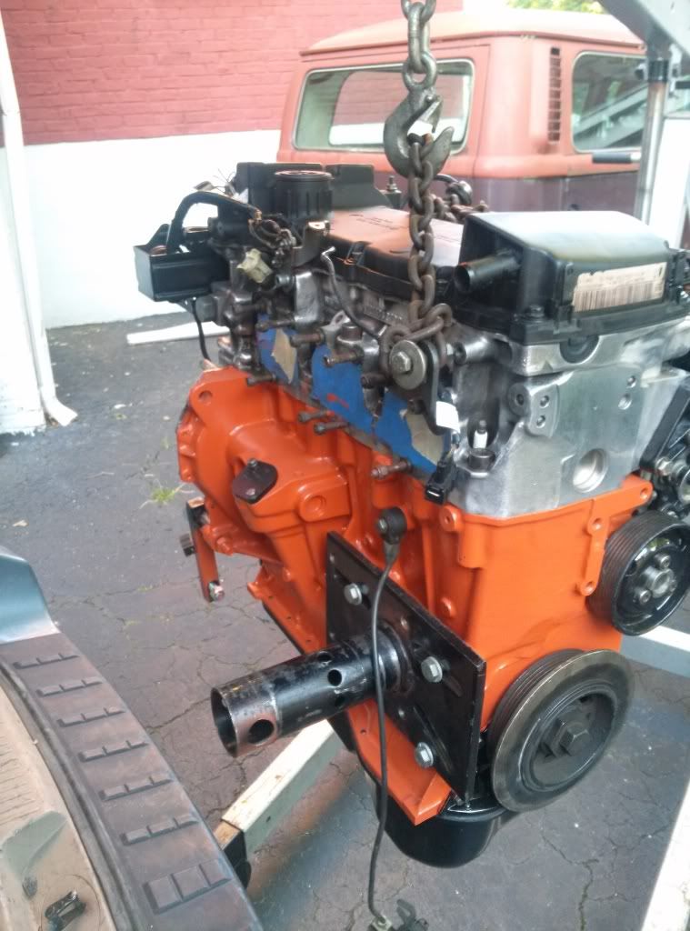

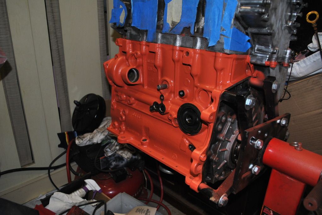

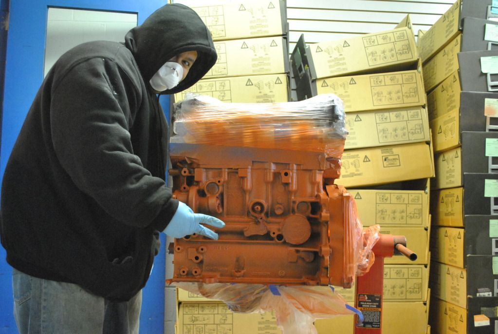

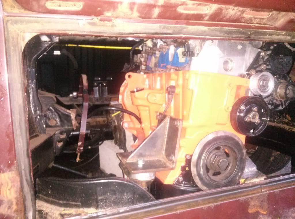

Finally brought the heart home!
Orange is a little more vibrant than the bus lol

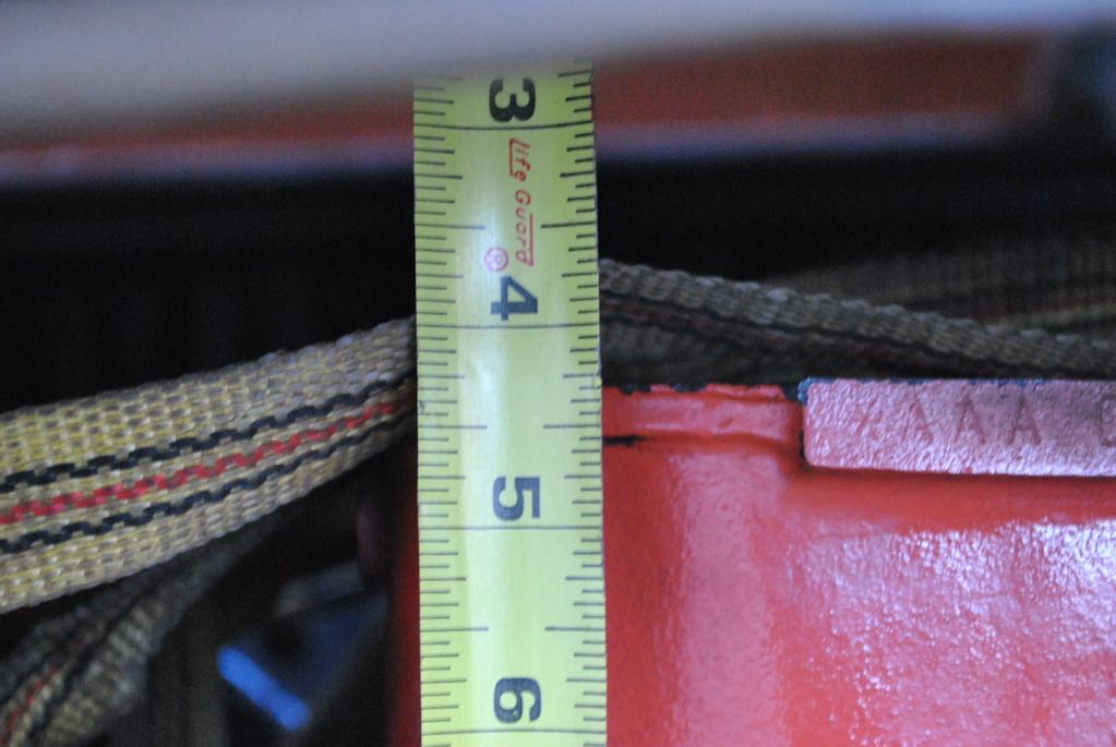

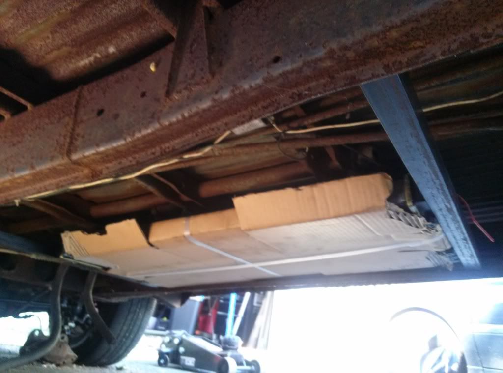

Started mocking up the radiator underneath the bus. Gonna have to run the slimmest fans ever know to man :laugh:

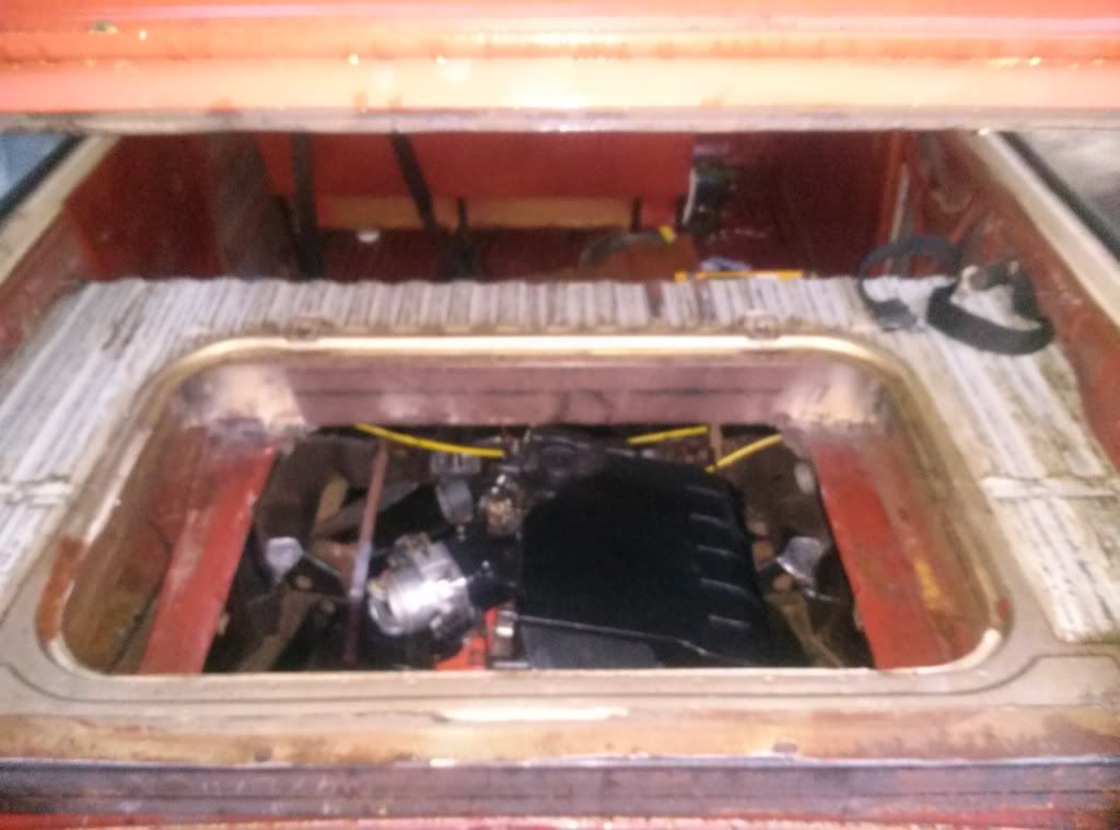

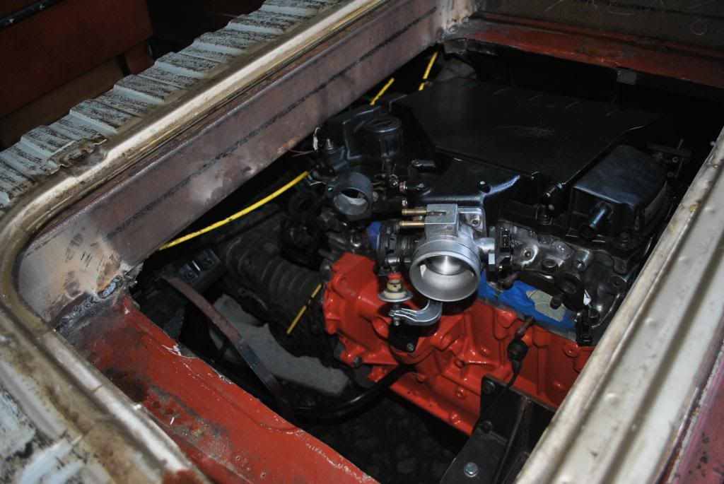

Also got a little weld time in w/ the raise. Better than I expected. Def is a solid piece back there! Gotta grind down the bottom of the decklid so it will sit flush on the tubing.
Put in some good hours today.Test fitted the wheels.

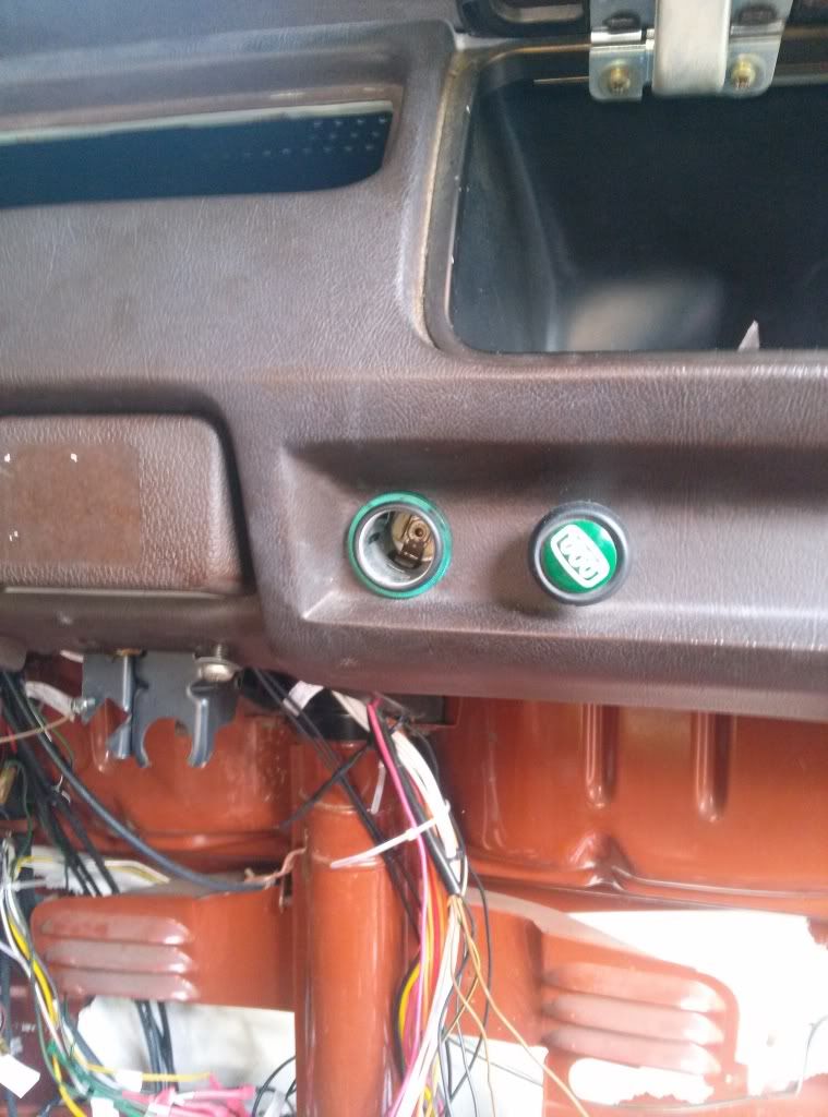

Added a cig lighter.
Relocating the ebrake.
Slapped on the KEP plate and flywheel on. Gotta get some new pressure plate bolts. Any ideas?
Finalizing the rear decklid, got the tubing welded up to the body now I just need to weld the decklid to the tubing.

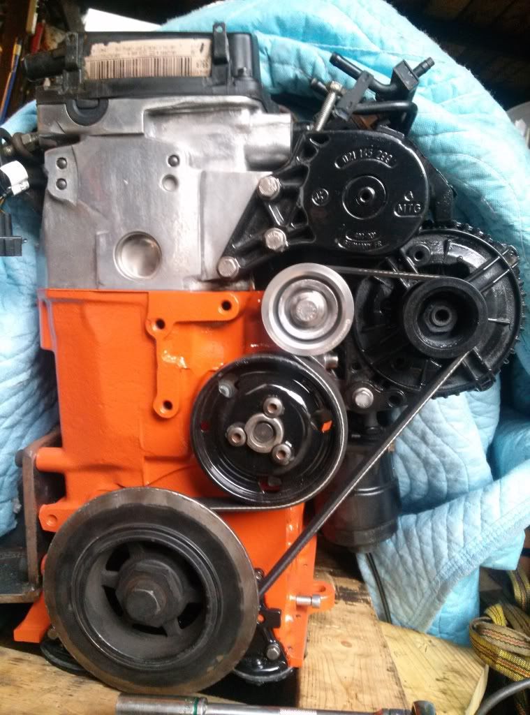

I got my shortened belt in today also slapped on my aluminum pulley. Crank pulley needs to be touched up lol

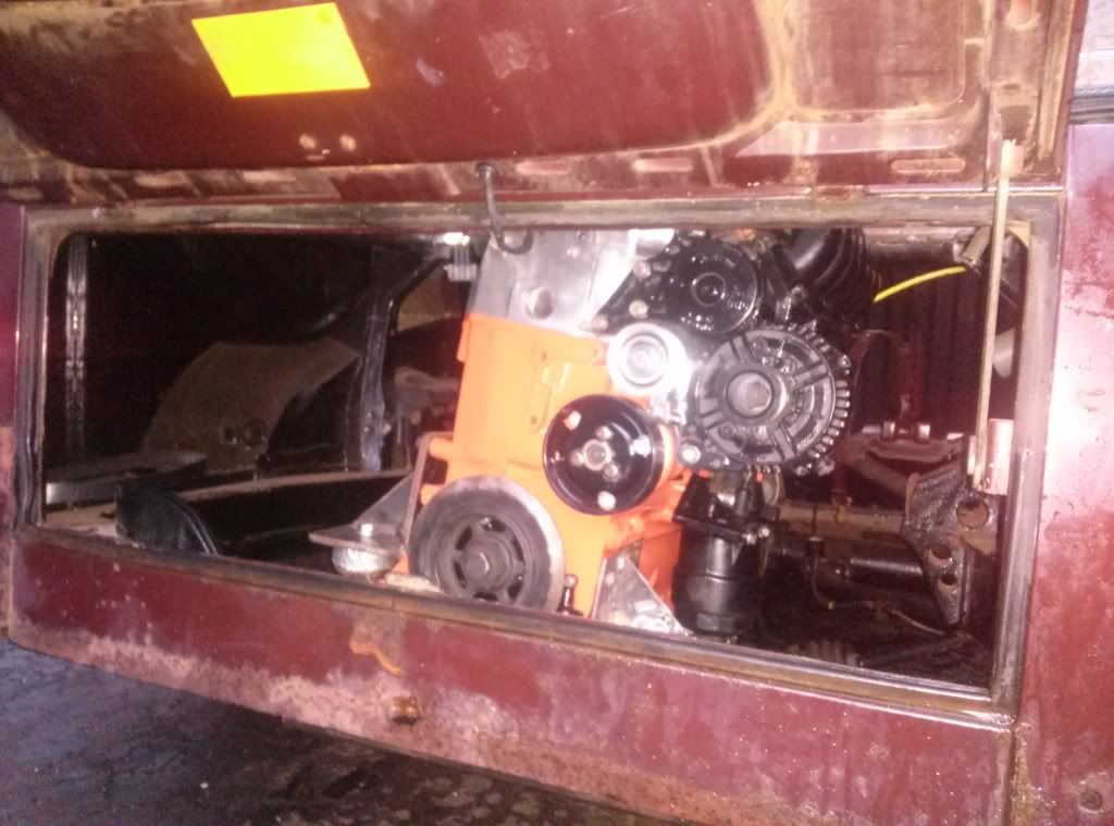

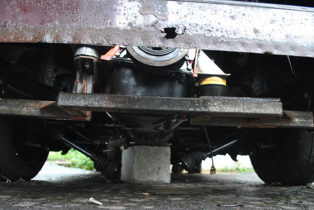

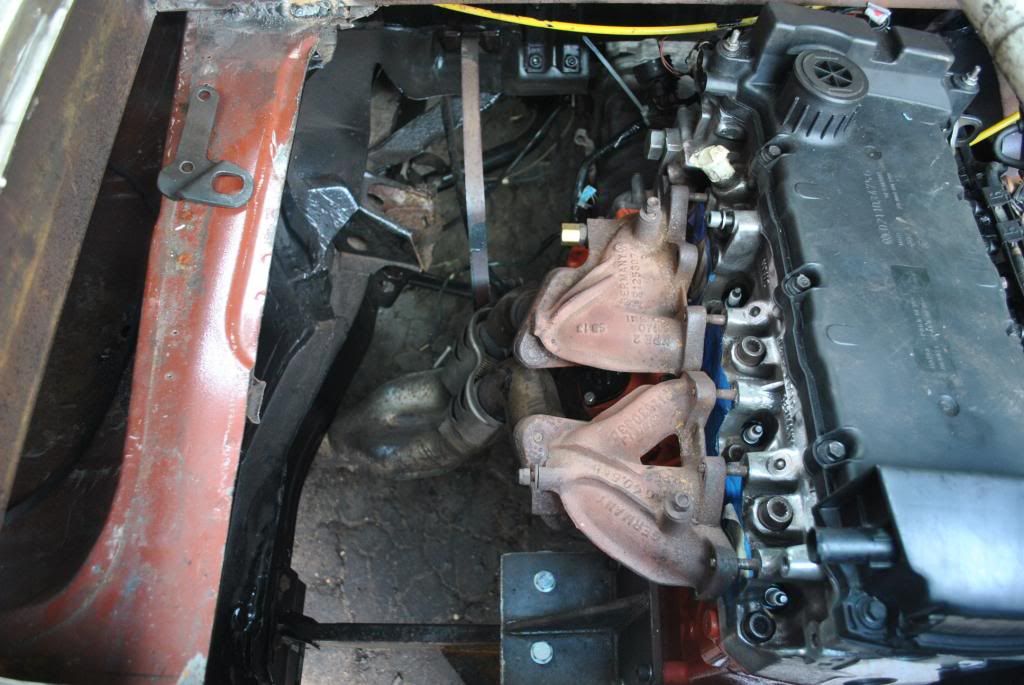

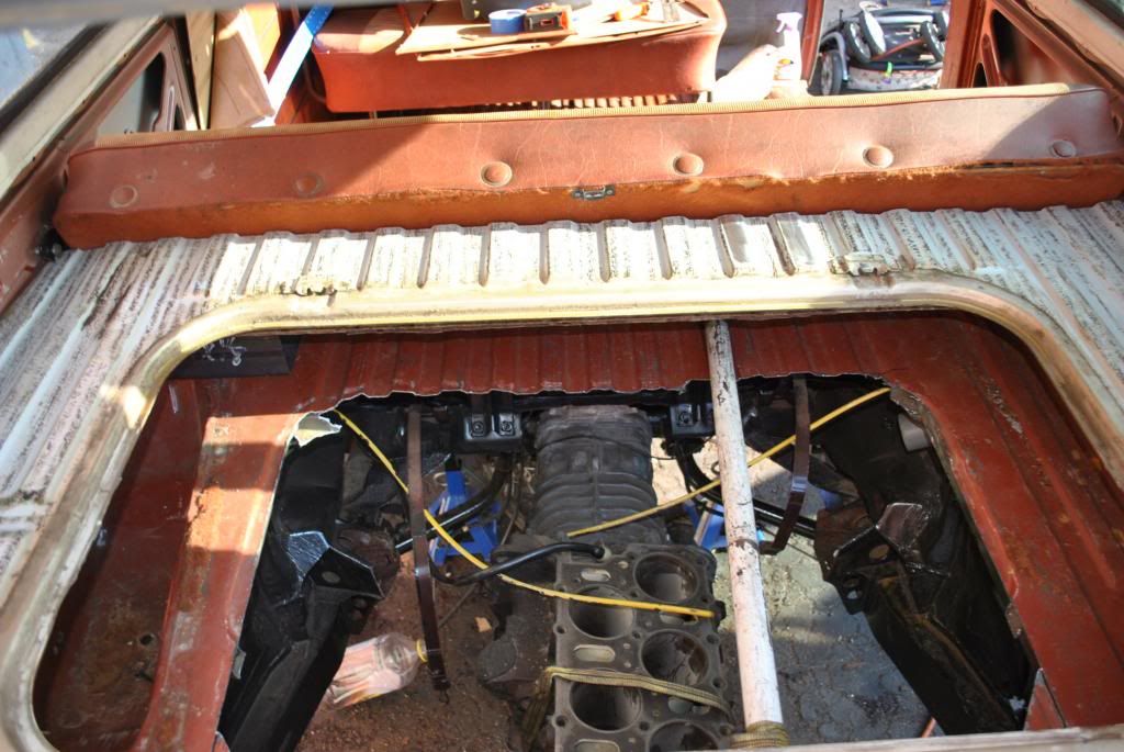

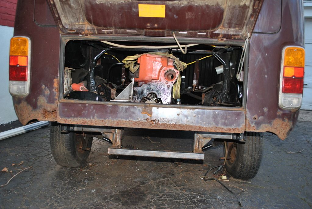

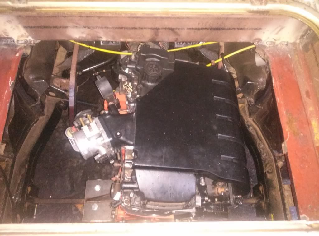

Rainy day just didnt stop me test fitting the motor!

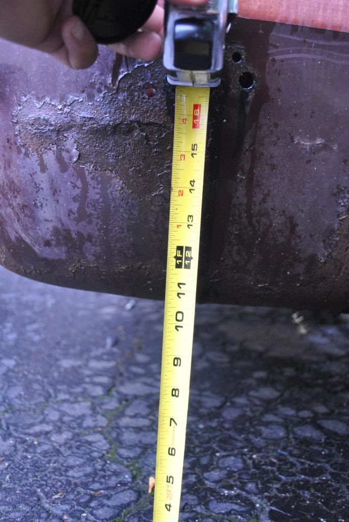

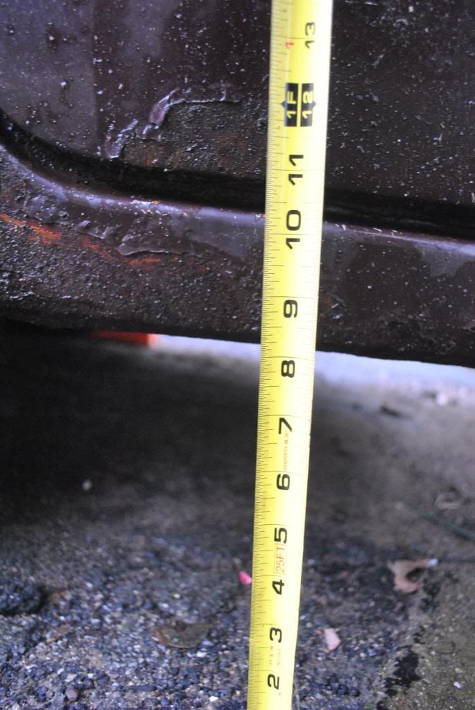

Ride height w/ the motor in! Lovely
Front height
Rear height

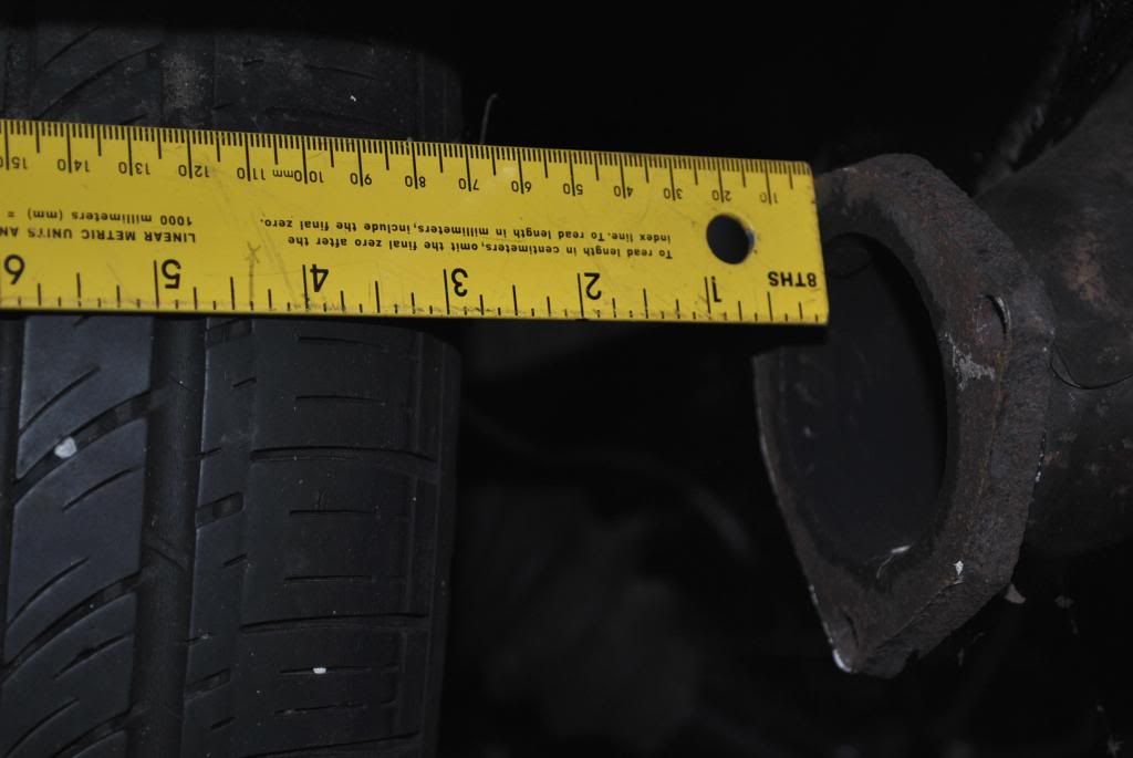

Tried to see if I can manage the vr stock downpipe and nope lol Gonna have to make some custom piping. That should be fun.

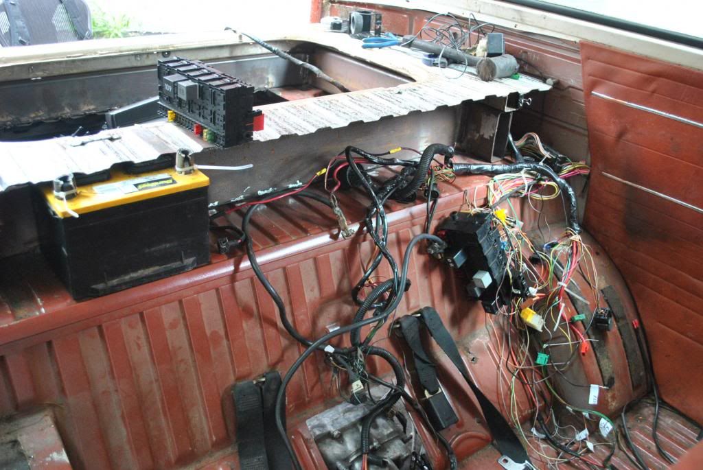

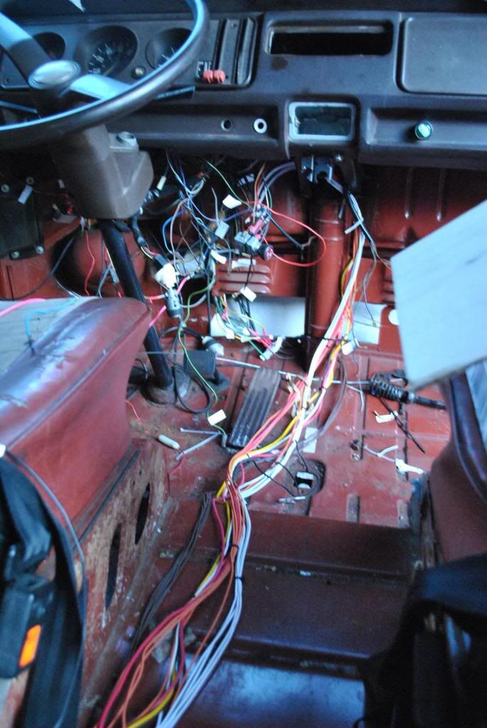

Wiring part2. Brought the rest of the wiring to get it situated.
And this leads me to where I am at today w/ the bus. Main concerns right now is my cooling, fuel storage/location, shiftrod setup and rear notch. Gonna slap the rad underneath the bus between the frame rails and fabricate a duct. Basketball

The gas tank is probably my hardest task. W/ the motor/trans raise I have cut down the size of the stock location. I was looking at first using a vanagon tank but thats not looking promising. A fuel cell looks good but it would probably have to be 10 gallons or less to run in the stock location. I would like to get something custom and use the VR pump/sender. Thats just dreaming though. Any ideas?

Im a fan of wiring but I gotta say it took longer than expected. Nights walked in the house and I couldnt even see straight b/c of the diagrams and numerous connection for the wire extensions. But 80% of the wiring is done so on to turning the wrench again!
