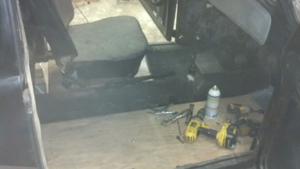

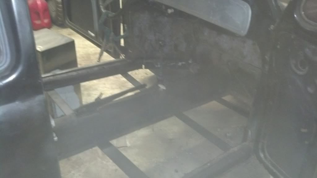

When your bottom door hinges float and the heater channel can be removed with a hammer, channel locks, and tin snips...its time to rebuild. 2x2 tubing, angle, flat bar.
H yess that's plywood floors:) guys they're temporary. Will make a great template when I buy sheet metal.

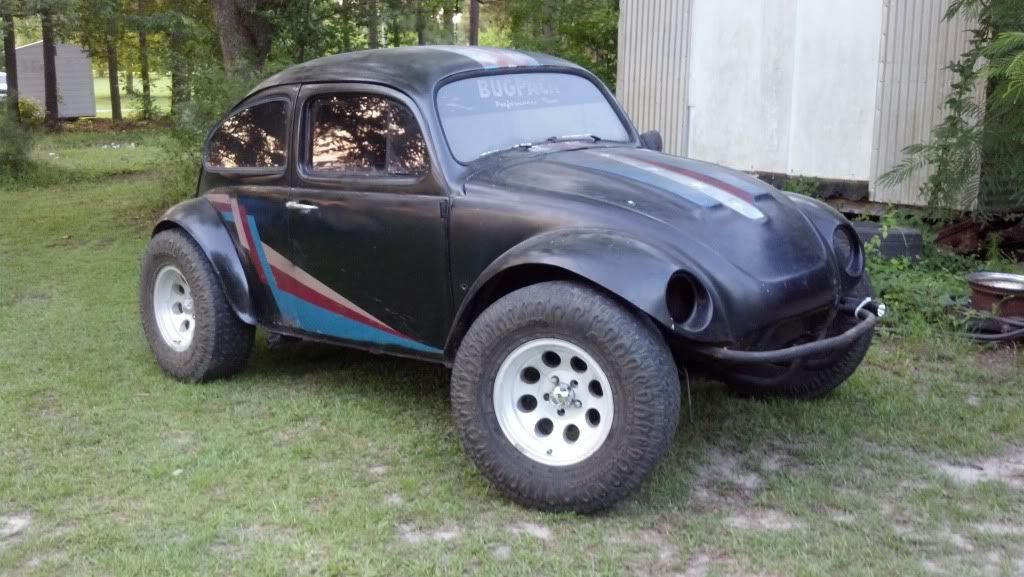

Post by redneck_davis on Tue Jun 18, 2013 1:50 am
Its getting there.

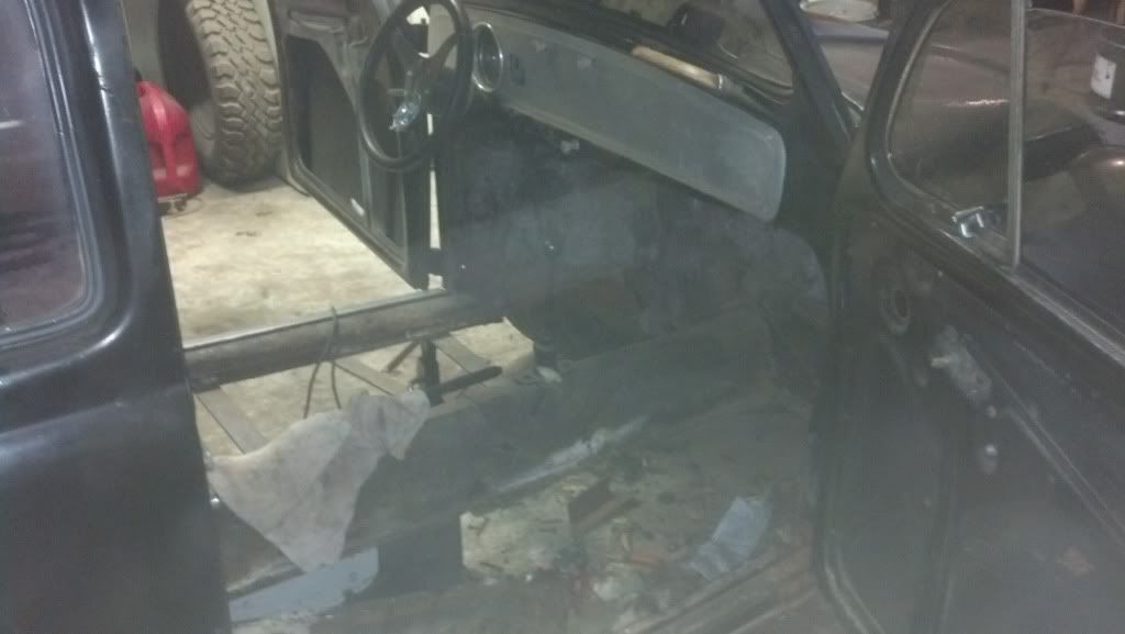

Started back at it. . had to move from my house i was renting with the shop to in town. So the car is now at a buddies under his barn.

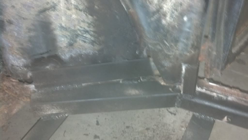

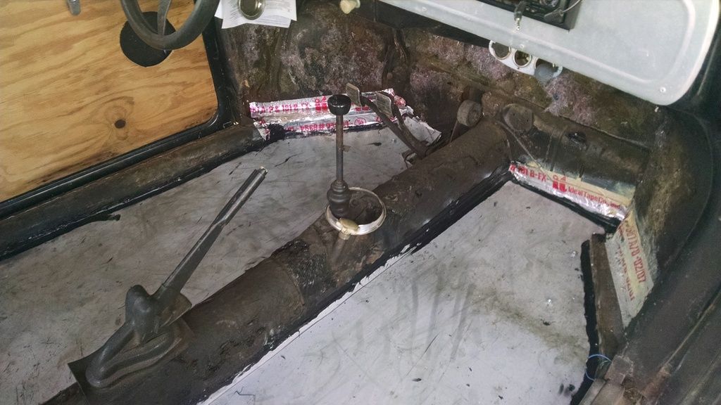

I know the engine ran in the previous car. And a little in here. But first things first is the new floors and panels, bed line the interior, then the wiring, new fuel line, 2bb carb, wheel bearings, exhaust, brakes and on from there.
Here's some progress on the new pans. galvanized down first, an insulator/noise resistance then another layer of metal to paint.

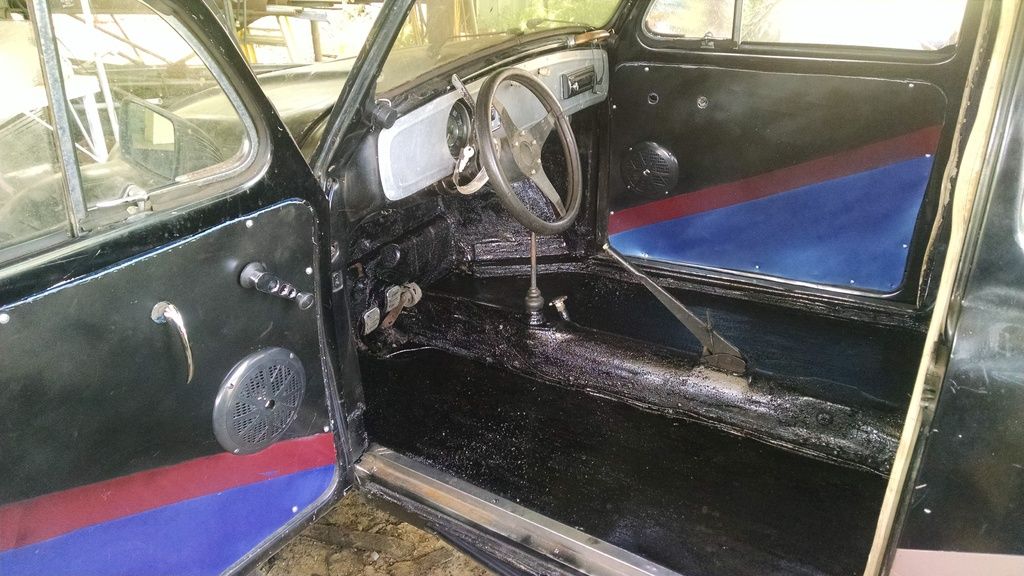

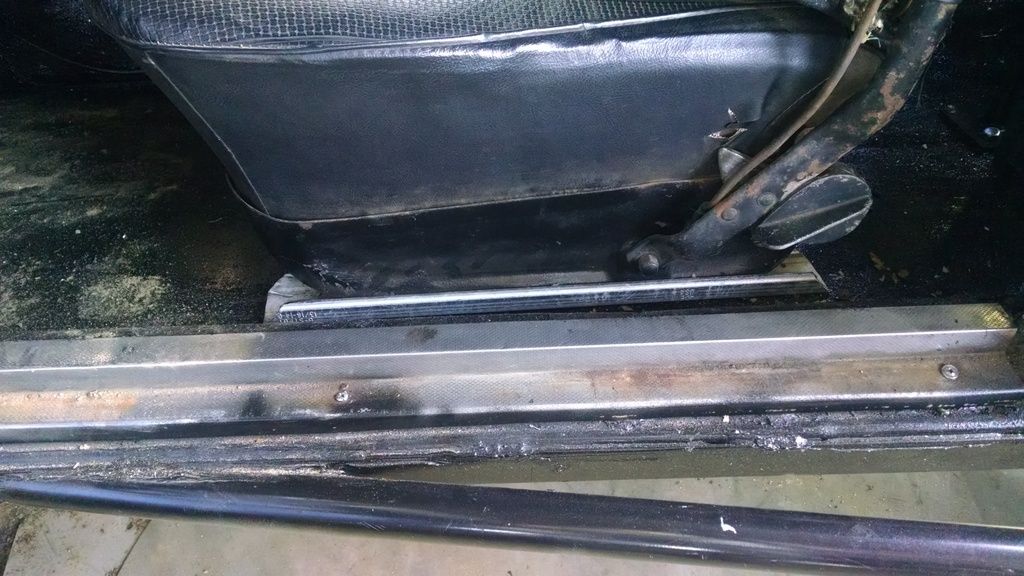

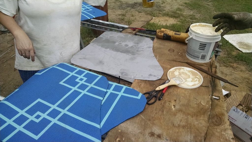

Got a Lil more work done today. Finished the floors(unless we fab a drop down battery box). Also cut out door and rear panels.
Put galvanized down, cut 1/2in thick foam board for insulation/ sound deadener, then put a "paint grip"sheet down. It has primer on it already.
Used a yoga mat for pattern then for a noise canceling background

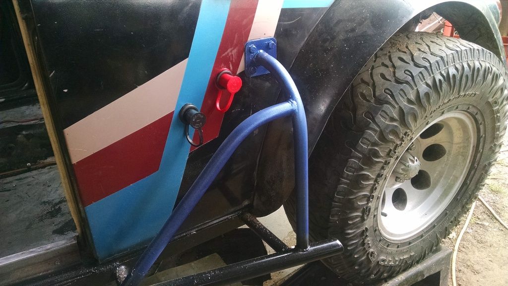

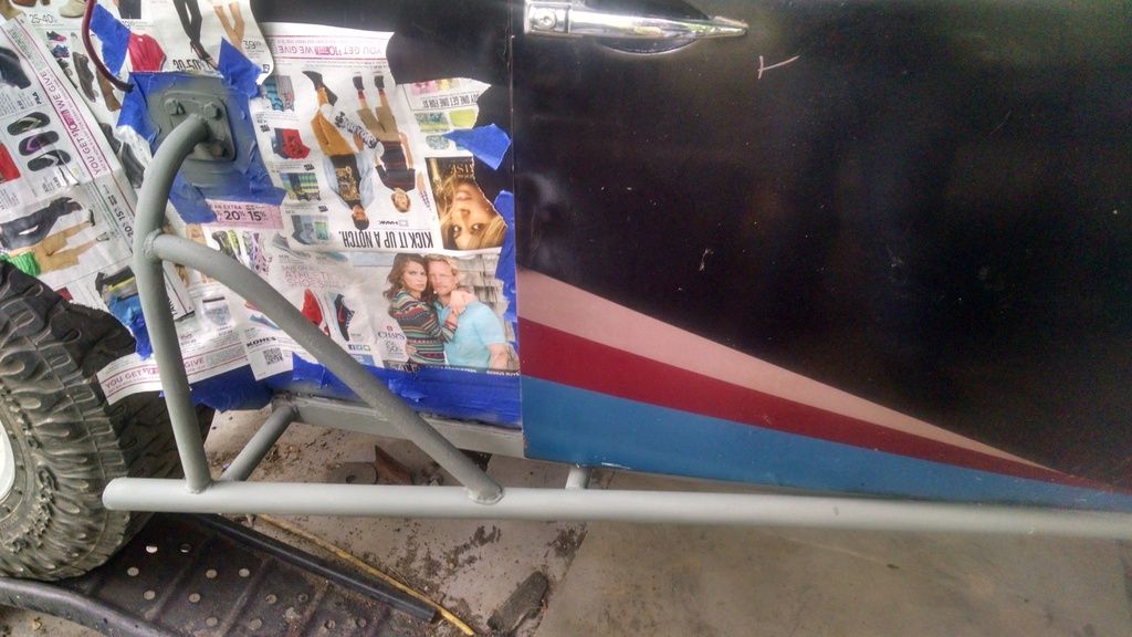

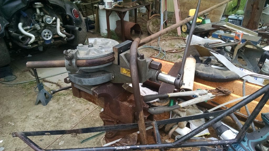

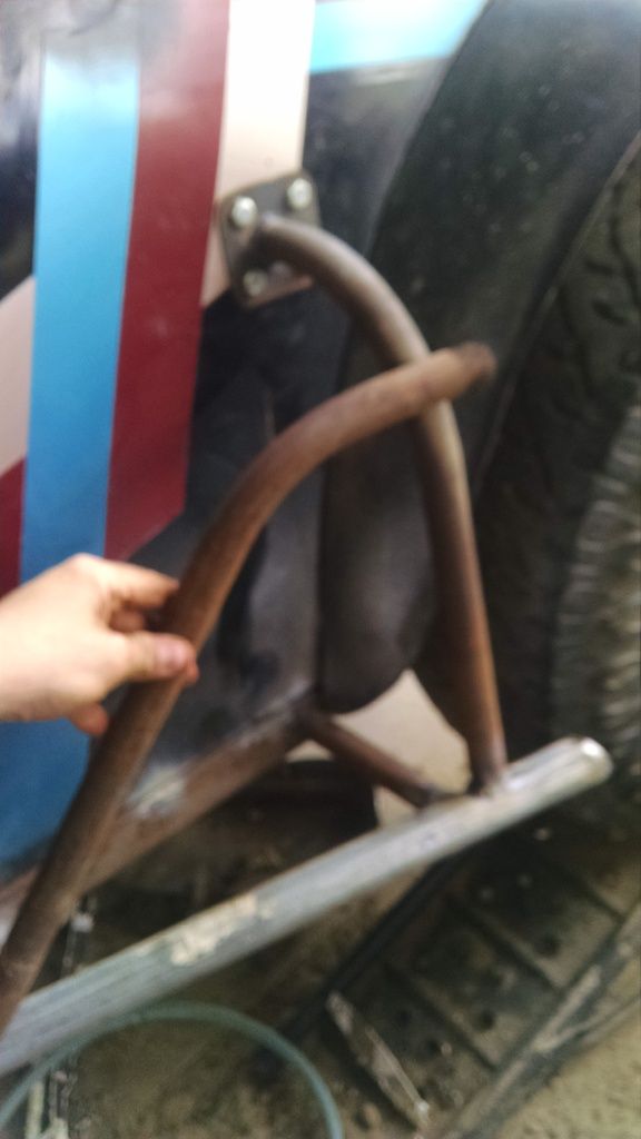

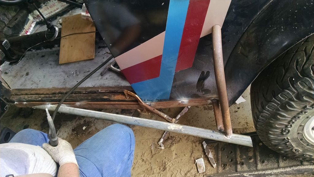

Also took off the el cheapo Nerf bars and built custom ones.. Whip didn't have any solid bar laying around so I got a better idea
We tried out the new pipe bender.
These are ridiculously strong, and also welded solid to the car at the bottom. The top is bolted
Next week I'll probly get to the paint. Will have completed pictures with the paint then.
Going to add handles to the door panels and put some gloss on there
The floor and rear panels will receive roll on bedliner, and the Nerf bars too.

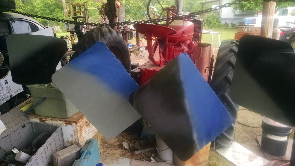

More progress on the Nerf bars
Primer
And some color

Also progress on the door panels. Added some paint.
And put some duplicolor bed armor on the inside, ran out out paint, will have to do the floor and front areas later
I had a full back seat from an Ford expedition. It was gonna be full width and also a little high for my preference. And with my seats being installed so far back there would be NO leg room back there. So I scratched that plan. . Smile were going to modify a metal park bench to fit. 3ft wide centered.

With a custom seat being bolted in there, I'm going to use a key switch main disconnect in the center under the edge of the seat. Make sure I can cut the juice off easily and from either side of the car.
Protected by the Nerf bars, will be a set of jump points on the outside of the car. (The ones like you see on a dragster). That'll let me jump it off or charge it with out accessing the battery itself.

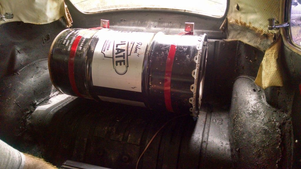

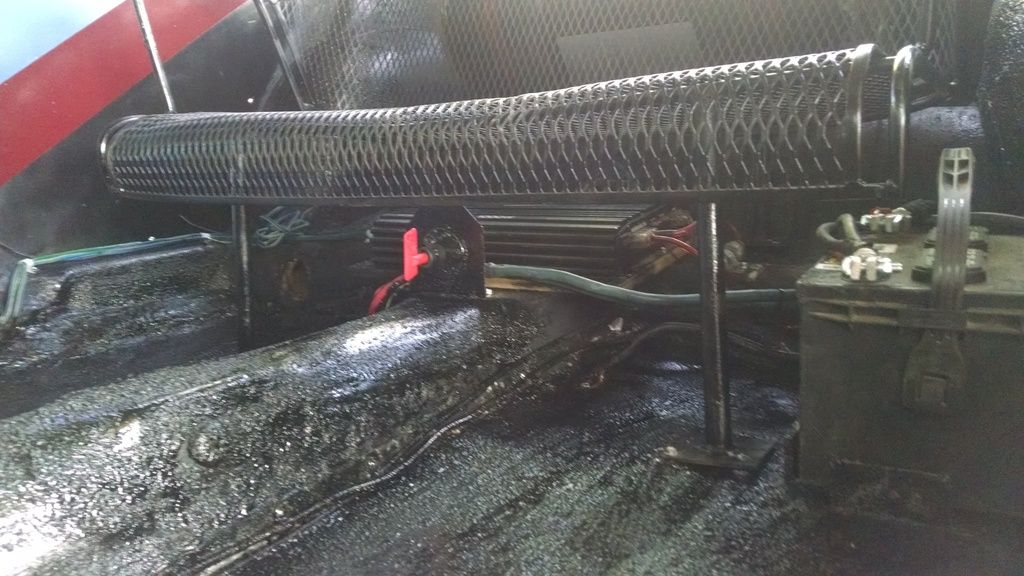

Behind the backseat is going to be a 30gal metal drum with a 12" subwoofer mounted in the lid.the ultimaye Redneck bass tube.

Here's the jump points

Put Herculiner in the floor. Ain't my brand of choice but not too bad.
I wish the paint turned out a little better up front. But it'll work. Can always be re done later.

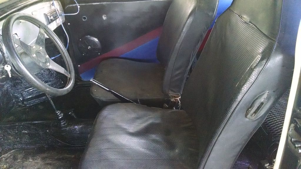

And here's the seat completed. I'll bolt it done next weekend after the paint dries

Here's a better look at the subwoofer.. Surprisingly a very clean hit. No rattling b/c the drum has no flex in it.
And here's the main disconnect. Used welding leads for wires and soldered all the connections. Tucked it out of view and possible harm but yet close enough for convince or emergency

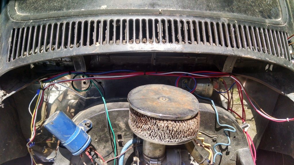

Also decided to tackle the wire harness. Been dreading that. I have to say it wasn't as bad as I thought.

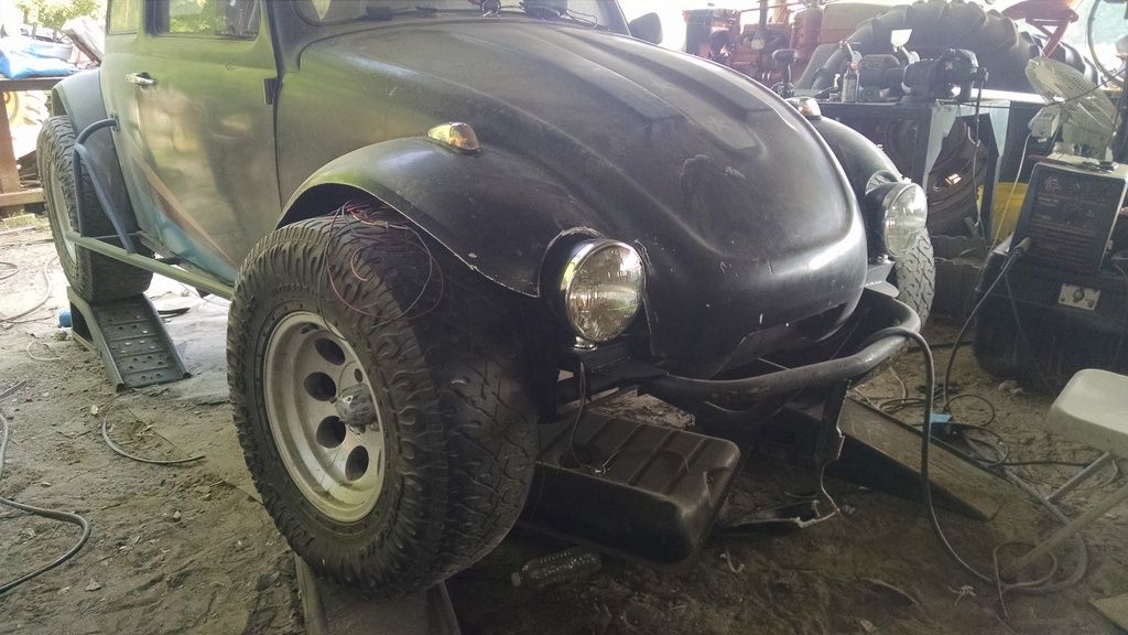

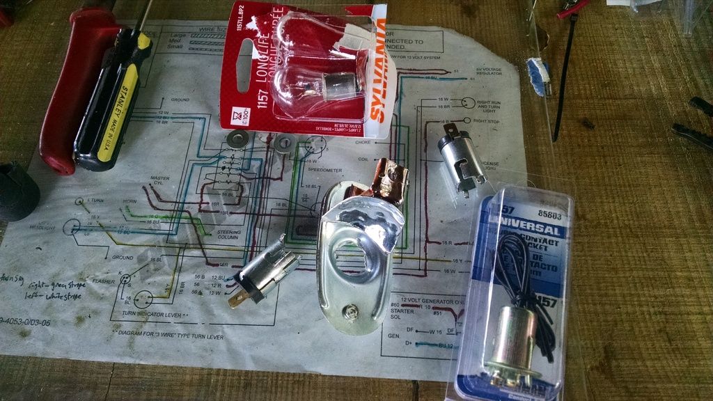

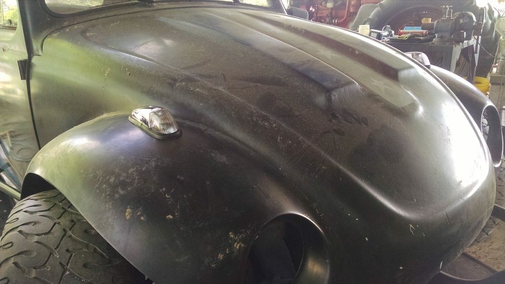

A little late, but here's what got done this past weekend. Rework on the front turn signals and hood pins.
The old style lights I chose came with single 1156 bulbs which would not work to run park AND turn both. So I bought new 1157 sockets and tore into them. You can see the master plan in the background (a wore out, highlighted mess of a wiring schematic) I think you could make a killing selling a colored version:).
redneck_davis
Number of posts : 188
Location : Toombs Co,GA
Re: my New Baja
Post by redneck_davis on Thu May 14, 2015 12:18 am
Surprise surprise, found even more bondo in the car. And a helluva lot thicker than it was when I drilled the holes for the jump points.
The old hood pin was completely bondo'd in. After drilling the rivots I snatched it out with pliers.
That's all of an 1\8in thick. Close to 1\4. Lol and why did they cut such a big hole? So I put a small plate in back, rivioted it to the body, then drilled my hole and mounted the new pins.
Small victory, but still a win. And I also received word that bunch of parts arrived.

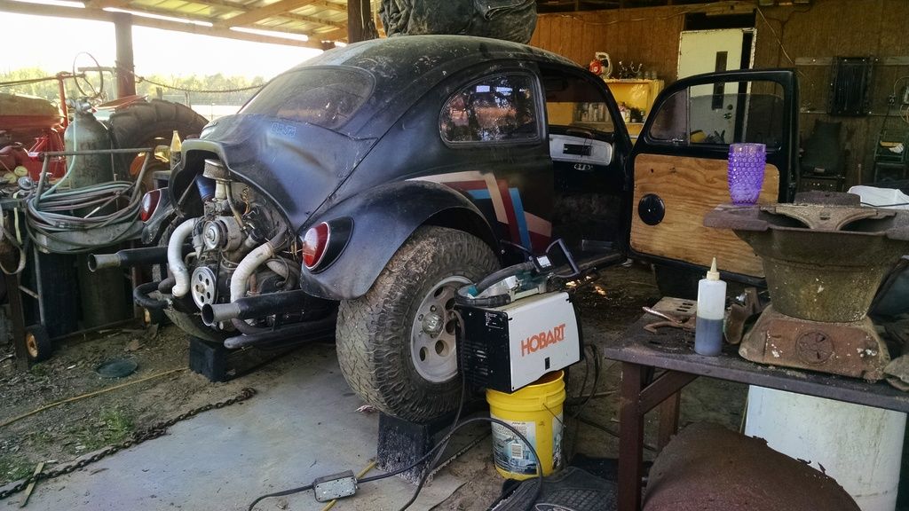

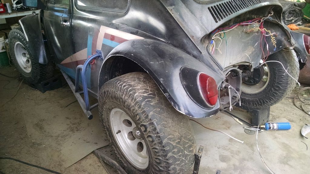

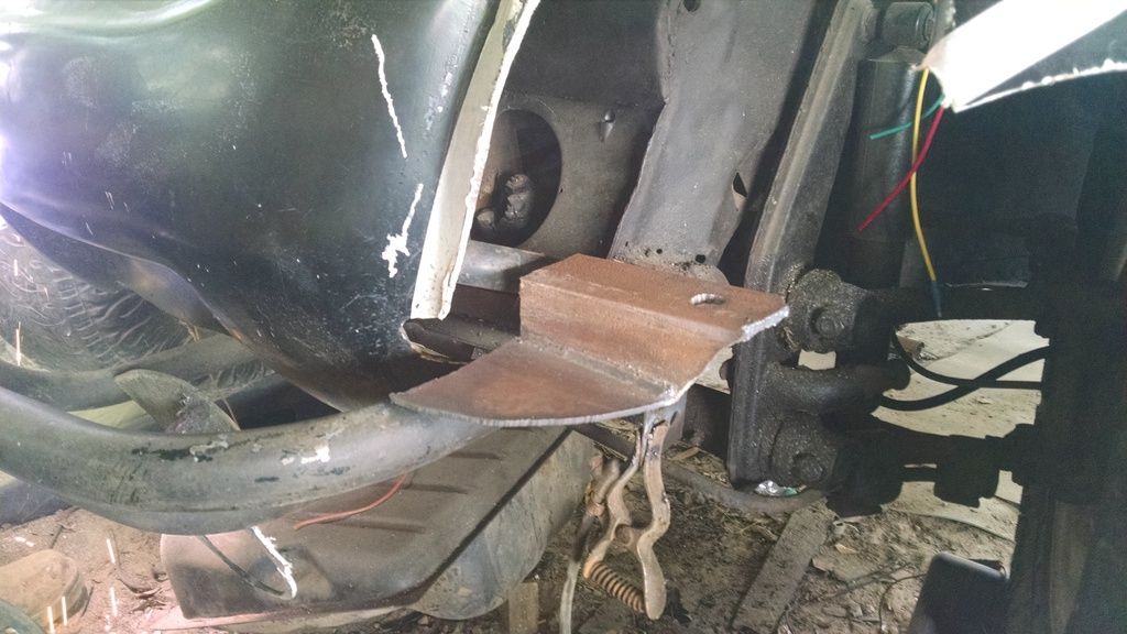

Well. This weekend we got the engine out, I can't wait to put the new exhaust on. I haven't found any pictures of this style on a Baja. And the chrome tins and shroud are gonna stand out awesome.

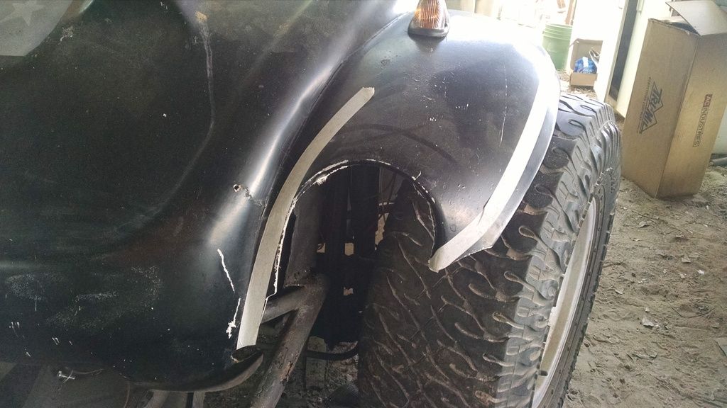

But now for the pics of the rest of my weekend. Man I hated to do this. But I had to slice and dice the $700 hood. Turned out decent though.
:/ had my fingers crossed
I was thinking just the angle, but my buddy was all about using the plasma on decorative plate
End result... I didn't think too bad. Couple reasons we went this route, I didn't want to fiberglass the hood, or have the extra weight of them on the hood itself. So I went with bucket lights. My original plan was a set of 4-6in mounted behind the openings on the hood. Turns out when ytour looking for a street legal hi/lo beam setup, it narrows your options. Could not find any smaller or cheaper than these. . so with the 31s on the car, they had to go forward and also up. Had no choice but the cut the crap out of it

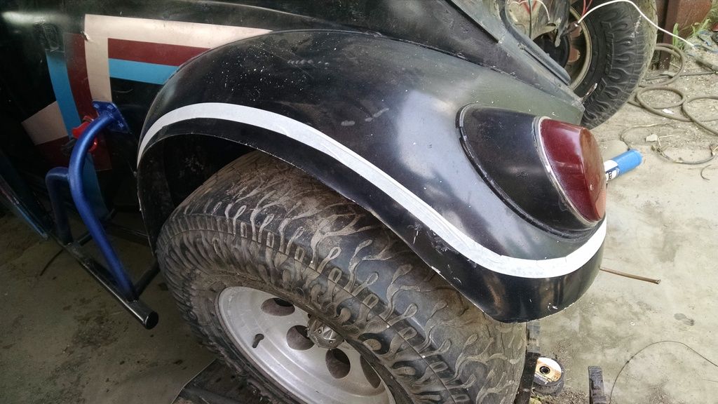

Post by redneck_davis on Mon May 18, 2015 11:59 pm
While I was cutting, I figured my the heck not. I took a few inches off all 4fenders, but a lot on the very rear
I also took the rear lights out, cleaned the sockets and replaced the wires, and new bulbs. . I have a little surprise for the spoiler, some tag bolts with a lit LED head on them and also going to tuck a LED strip in the top to shine off the engine chrome and backing plate. Installed a new roller throttle pedal w a new cable, new key switch, and some Joe dirt footprint pedals(forgot to get that picture)
Here's the rear after the slicer.
