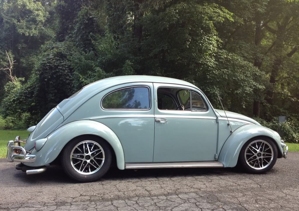

She ran under her own power today! And had brakes. Still need a new exhaust and going to have to raise the rear back up slightly.
Number of posts : 893
Re: 57 coming out of hiding. Time to work on it
Post by bakertim2 on Sun Jul 14, 2013 8:36 pm
I think it's perfect. Don't change a thing.
Post by vw57drvr on Sun Jul 14, 2013 8:49 pm
It squats hard with two people in it. Gotta figure it out. Thought I went down one click but its super soft.
Post by 56rag on Sun Jul 14, 2013 10:05 pm
looks killer,love the stance

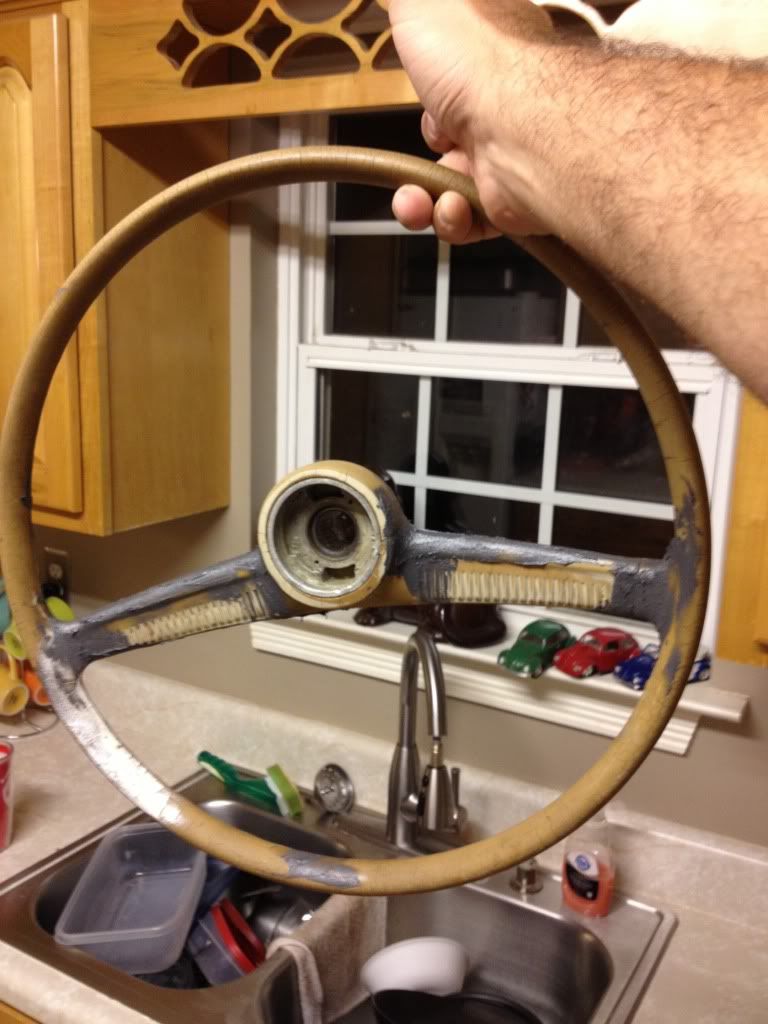

Post by vw57drvr on Thu Jul 18, 2013 11:06 pm
Reindexed the rear again. Still low but has a little more spring tension. Pulled off carbs and intake to fix an intake leak. Back together now awaiting synch. Started working on the old cracked steering wheel. Never tried to fix one before so this should be interesting.

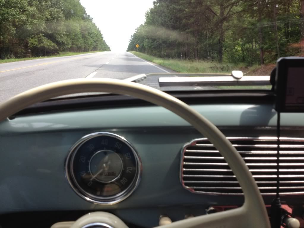

Post by vw57drvr on Mon Jul 22, 2013 3:34 pm
So I drove her for about 45min to an hour of solid driving. The engine needs tuned but she ran without any issues. Well, other than the exhaust hanging too low and the Berg shifter driving me nuts.
Fueling up with my wife and daughter aboard
Cruising the highway
Post by Grifspop on Mon Jul 22, 2013 7:05 pm
Did you get the speedometer all the way back around? Very Happy I've never done that
Post by vw57drvr on Mon Jul 22, 2013 8:49 pm
Haha. No. It's not hooked up. I'm using the GPS for now.

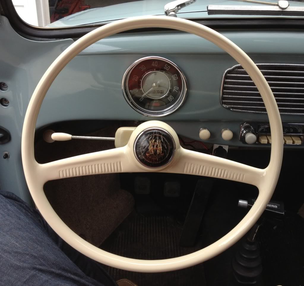

Post by vw57drvr on Mon Jul 29, 2013 12:19 pm
Far from perfect
Post by Gabass on Mon Jul 29, 2013 12:53 pm
That looks great! How did you do it?
Gabass
Number of posts : 350
Age : 19
Location : Watkinsville, GA
Post by vw57drvr on Mon Jul 29, 2013 1:03 pm
I used PC7 two part epoxy. I got it a little too thick in some places because I tend to be impatient. It sands down ok, but it doesnt sand as fast as the steering wheel, so you have to be careful. I am having a hard time getting the paint to dry though. Not sure why. Now if I could only figure out how to fix the cracked horn button.
