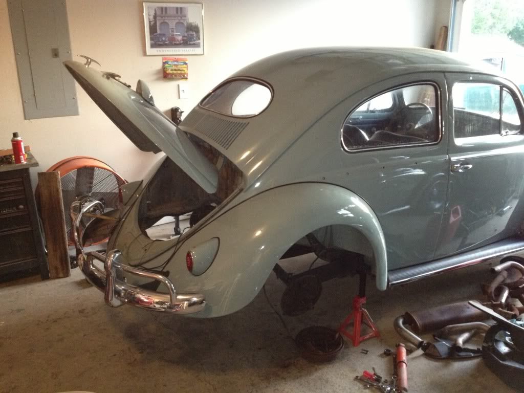

Rear end on its way out. Old split case tranny has seen better days.

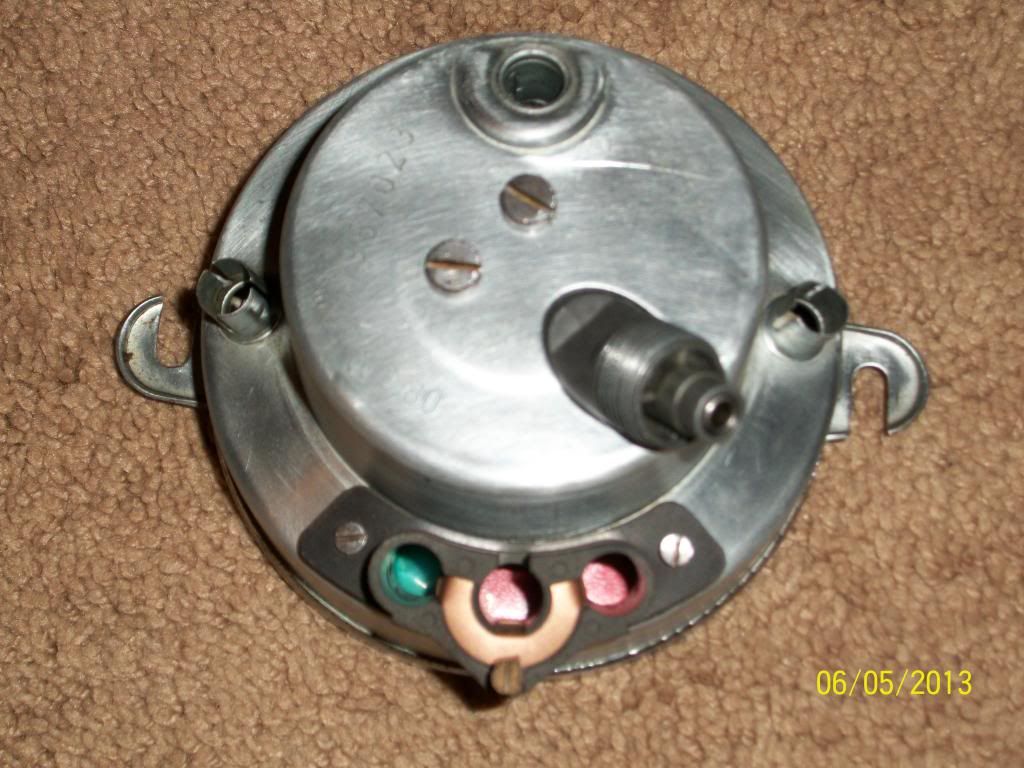

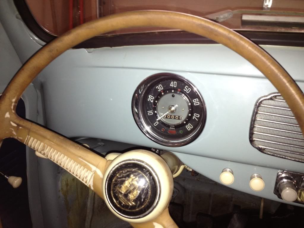

Are they 165's? If not then what is the circumference? Working on calibrating the speedometer for it right now.
Also, since you're going with a 1776 would you like me to replace the 80 mph face with a 90 mph one?

Finished and looking as good as the car Cool

Nice! That was the second time that needle has broken. The first time, somehow I was able to actually take one off an old speedo and put it on mine. Probably weekened it as most of them break before they come off.

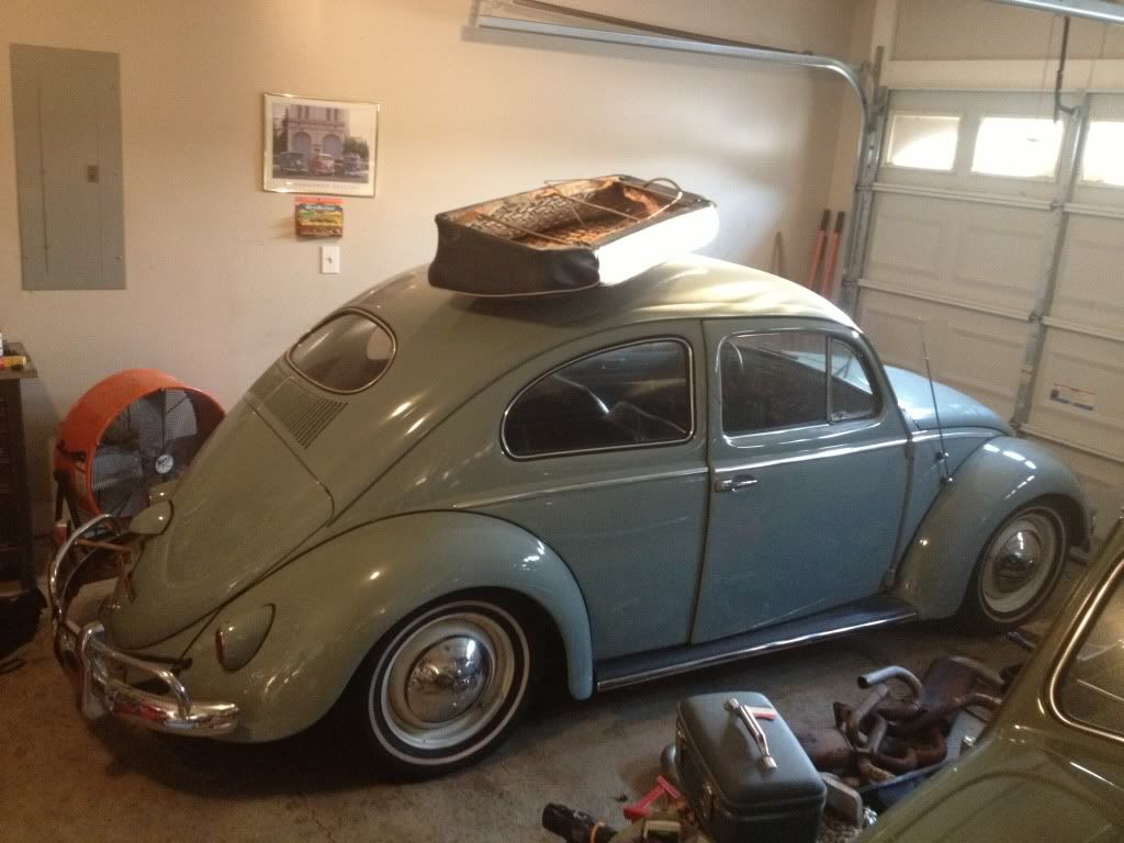

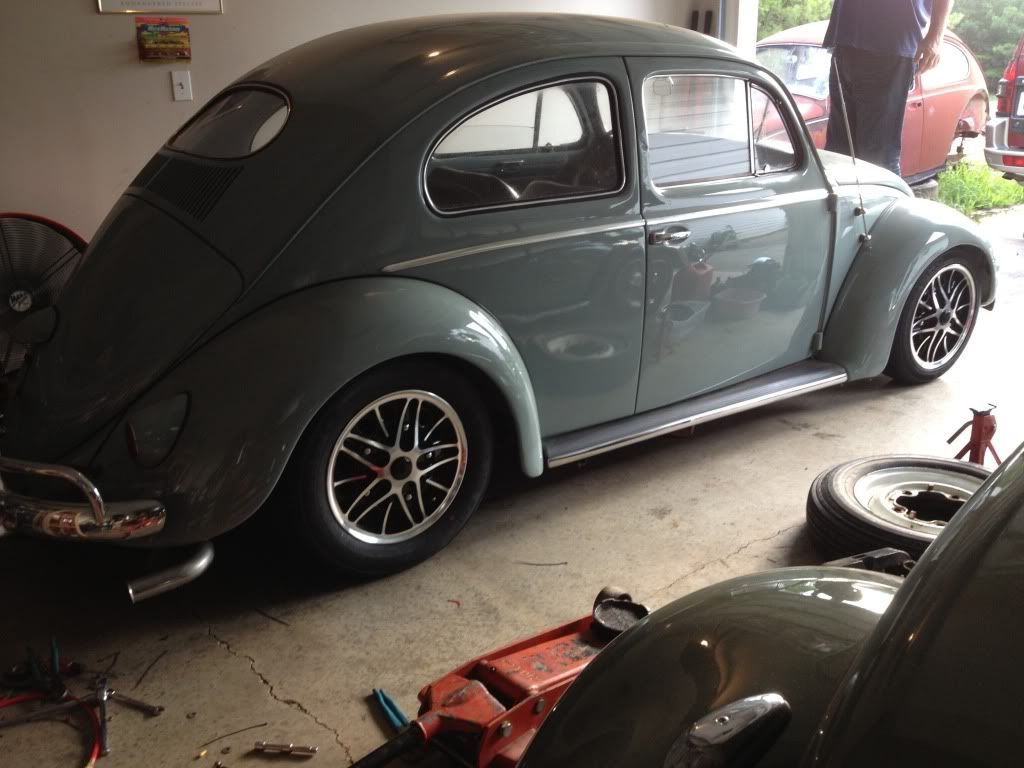

This project is taking longer than I wanted it to. Finally got the tranny swapped. Pulled the axles out of the old split case, which requires splitting the tranny. Put on one piece boots. Took me several hours to get the torsions apart to lower it. They have never been apart but finally got it down one click. Sure looks low with only one click down. Never lowered an oval so maybe they are different. Here it is back on its wheels with no engine. Rear end sat right down. I hope it's not too low.

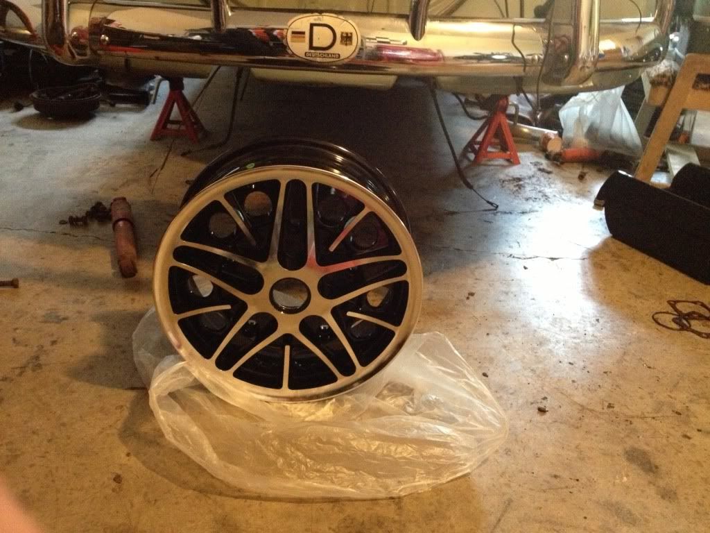

The cosmics (cosmos) came from moore parts in california. They are made by empi and are nice quality. $109 each with free shipping. Here is the link for wide 5's

Finally shoe horned the engine in. It's really in mock up but it's there. Dang is it low in the back now!

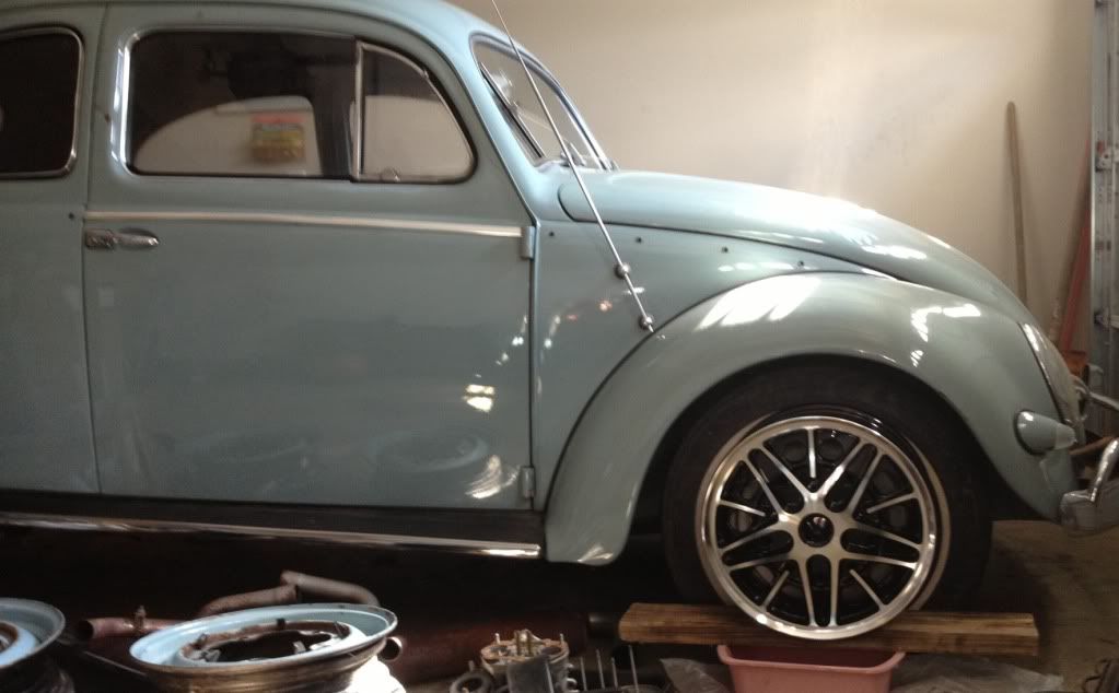

Engine is in and wired. Got my new tires today. Got the cosmics bolted up and the lug bolts hit my brakes. Ugh. Always something.
