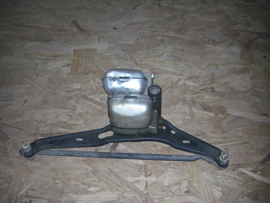

So to the swap. Here is the original 6volt assembly and behind it is the 12volt Volvo motor. Both motors are made by SWF and are in almost identical boxes.

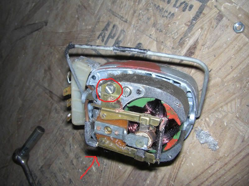

Slide the wire strap to the side and take the tops of off the motor boxes. Then you will see the brushes and the armature. The brushes are held on by two small screws. One is circled below, and the other is out of the picture so there is just an arrow pointing to it.
Once the brushes are off, you can just pull the armature straight out.
Then just put the volvo armature in the VW unit and put the Vw brushes back on it. Very easy. Took maybe 5 minutes tops.
