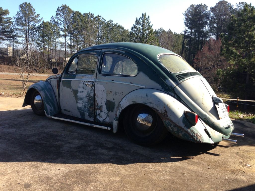

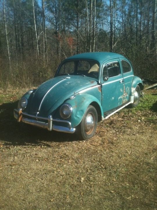

I guess I'll finally make a build thread about my beetle. I bought this car just over a year ago now and it's come quite a ways. I got it from Steve Scott who had found it in a barn. He fiddled with it for a while, but never got it road worthy. Thanks to Drew and Tim Baker I've had a place to let this car blossom.
We've redone all of the brake system. (With the help of Mr Wildo.
All new steering components.
5" narrowed beam
Drop spindles
4" jer fab drop plates one click
145/65 up front
165/80 in rear

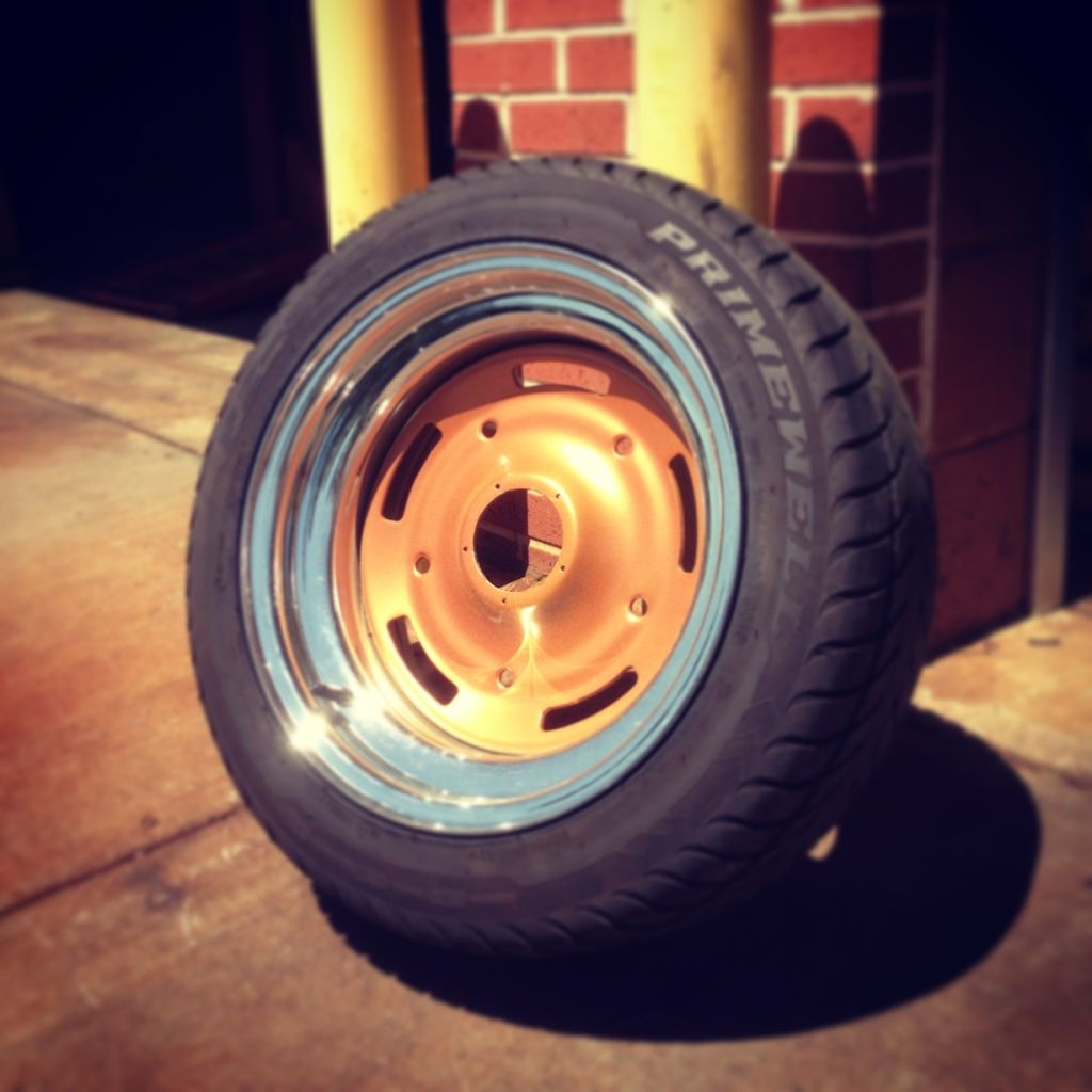

Hope to be doing some business with Chadd and get some new shoes for this dirty hobag.
I tried to get it done for Cruise the Coop but the driver's seat didn't like its placement so it basically fell out on the first test drive. So I'm gonna be doing some pans pretty soon.
Also hoping to redo the wiring in her as well. So far, only one headlight and one tail light work.
The day I bought it.
How it looks after lots of easy off and a few parts

Well Chadd just called me. Looks like the wheels have been delivered. Haha.

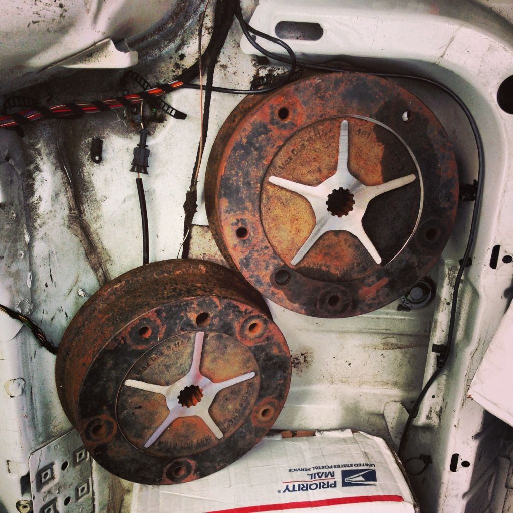

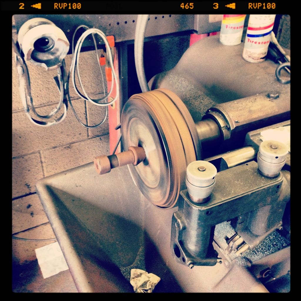

Found some thing drums on the samba thanks to Tim Baker and got them in Monday.
Took them to Hank Tuesday to get machine down.
Then took em to work and resurfaced them.
Hoping to have them, and the new wheels and tires, on the car by next weekend.

Got the drums on today. The difference is pretty comical.

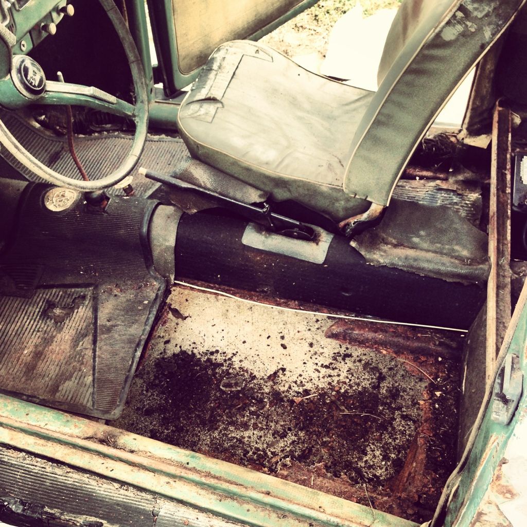

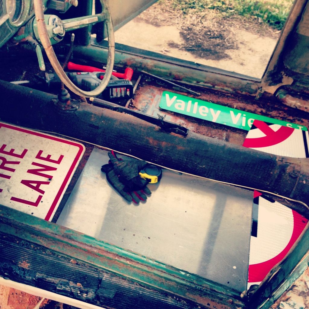

Now I'm dealing with this debacle.
What's left of the drivers pan

Wow, that is a huge difference in brake shoe area. Cool looking project!

i know the feeling lol my old drivers pan is sitting outside my garage. nothing but a pile of rust. cool car keep.up.the good work.

Tempory floor update

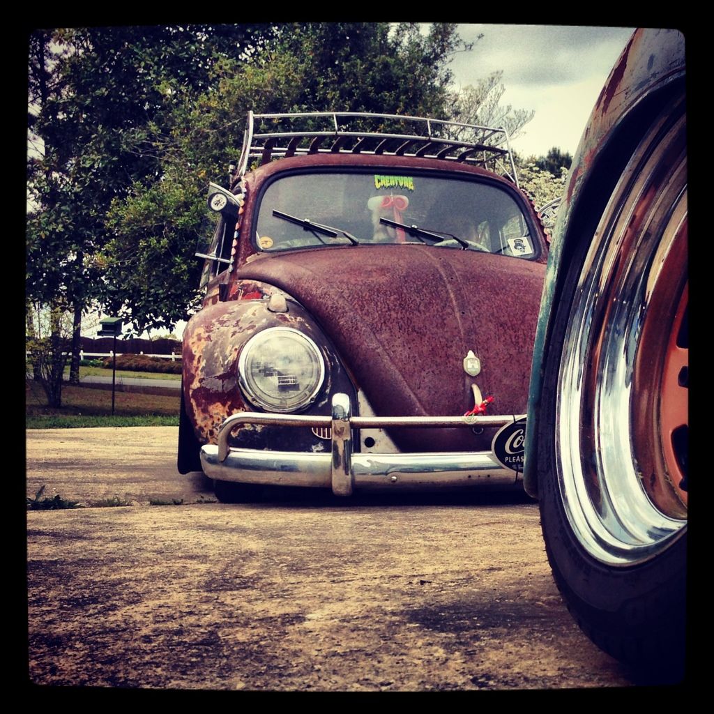

Had the day off yesterday, so I spent it with ole hoodrat.
Got the wheels on, rolled the fenders, played with some electrical, and finally went on a real test drive.
But of course that was short lived because some trash clogged up my hard fuel line on had me and Drew broke down. We got it back to the shop and it took forever to finally break the awful mess up and blow it out of the line.
After that Tim, Drew, a myself finished assembly on my roofrack and got it on the car.
Still having parking light/brake light issues, Tim said he would take a look at it today for me. So I'm gonna pray for the best.
Goin to put insurance on it today and hopefully be driving it by Friday.

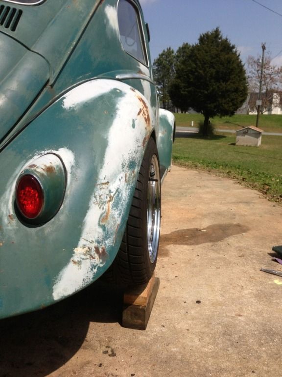

The wheel fitment with the suspension at full droop.
I'd say I can deal with this height.
I dropped the front a little more after this picture but you get the idea.
And heres some more artsy fartsy for ya.
Big thanks to Drew and Tim Baker for all the help and support. It's definitely kept me going.

Looks right! I don't think the lower front fender trim is going to be there for long, I drug mine off in a couple days Laughing Good thing you ended up with some flat pans, pretty sure it would be near sitting on the factory floors out back. What size tires did you end up with on the rear?

Thanks. Yea I'm probably gonna lose a few things going down the road but that just mean more clearance to go lower lol. The passenger rear pan is still mostley there, for now, and it scrapes potholes lol. I'm running a 195/50r15 on a 7in wide wheel. Any wider and it would be all in the fender.
