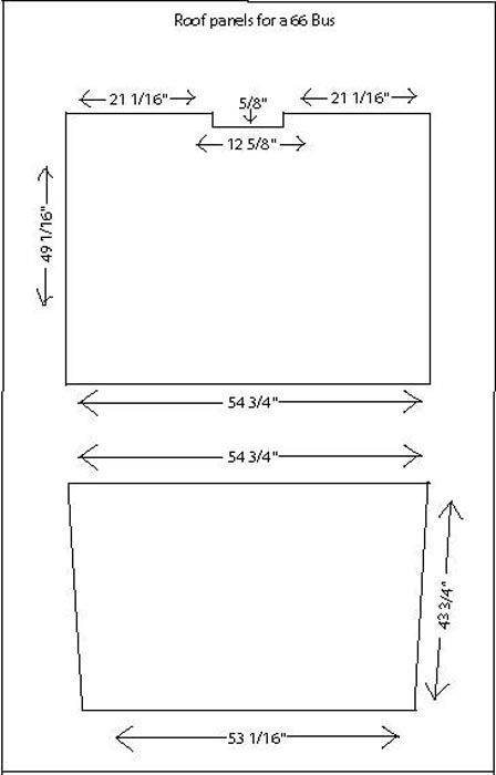

Post by fluxcap on Thu Feb 21, 2013 7:23 pm
Finally found my piece of cardboard where I had written down these measurements. Phillip had asked me for these a while back, but I figured I'd post them here in case any body else could use them. I initially found some measurements on the Samba and had to tweak them slightly after a few test pieces. Here's the final measurements I took before polyurethane and final install. These are from my 66 bus.
Re: Roof panel measurements for hardtop Split Bus
Post by type901 on Sat Feb 23, 2013 7:27 pm
Thank you sir.
