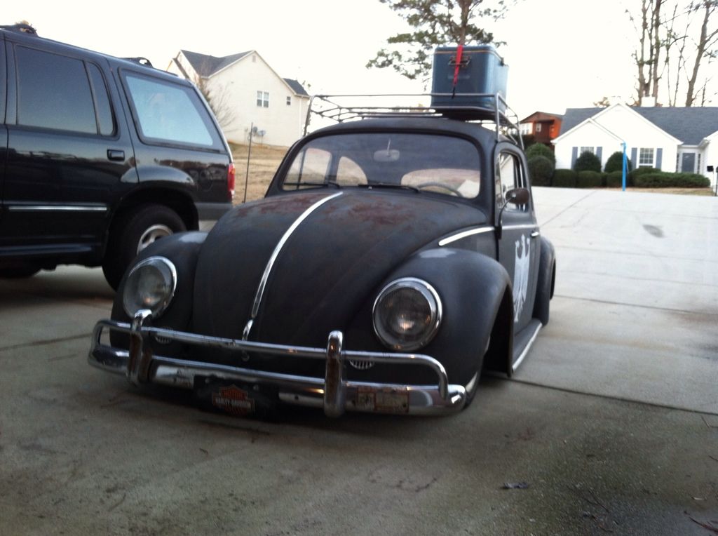

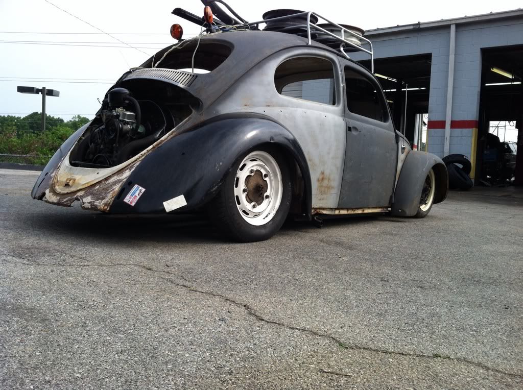

New here, just moved down from Chattanooga and this is my bucket. I got it in boxes and has been slowly going back together for the last 8 months or so. There is still a lot to do but time and money is tight right now.
The day it came home.
The OE engine was pulled apart and put together finger tight than sat for 14 years.

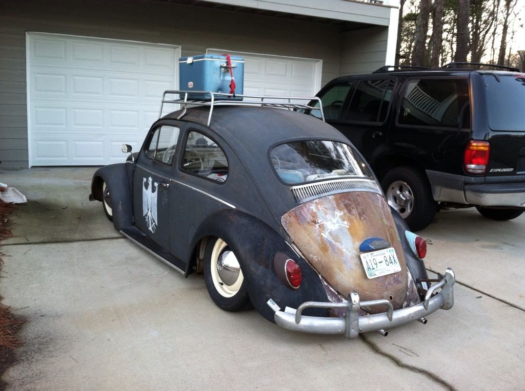

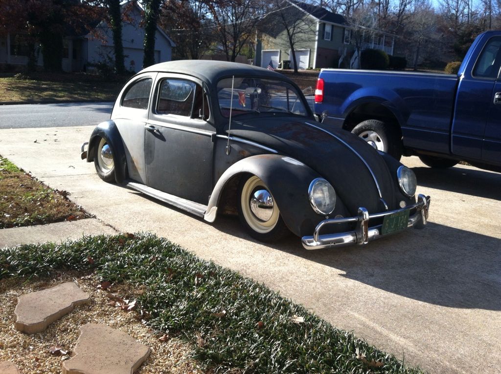

After cutting twisting and narrowing the beam 6in., dropped spindles, flipped tie rods, setting the frame head back a little over a inch, 4in. Dropped and extended spring plates, 3in. Trans raise, flat pan...and a bunch of other crap I can't remember right now lol...
The front fender trim is gone...ground it off pulling in and out of the driveway. Very Happy
Here is the engine now, I was making the air filter piping in this shot.

Thanks guys! Looks like there is a good amount of aircooled people around here. The pictures are with 165's out back, went to 185/60's and mini tubs...resplined a little and much better ride at the same ride height.

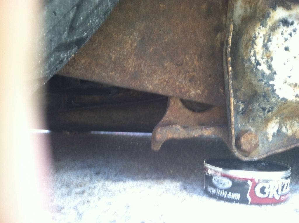

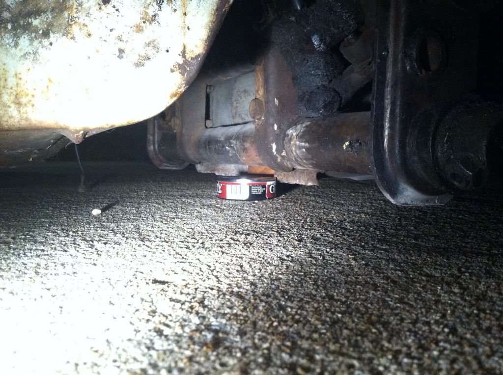

Some pics during the build
Narrowed,cut and twisted beam.
Down in back..self made drop and extended plates. Got camber?
Spindles on. Front tires pretty much sitting on headlight buckets. Also started on trans raise...camber is gone
Rear view, no way the air filter will clear the deck lid.

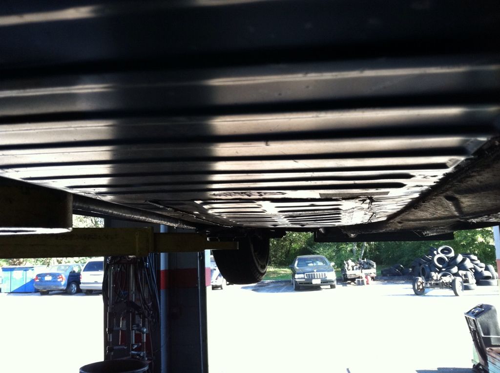

Here is some more.

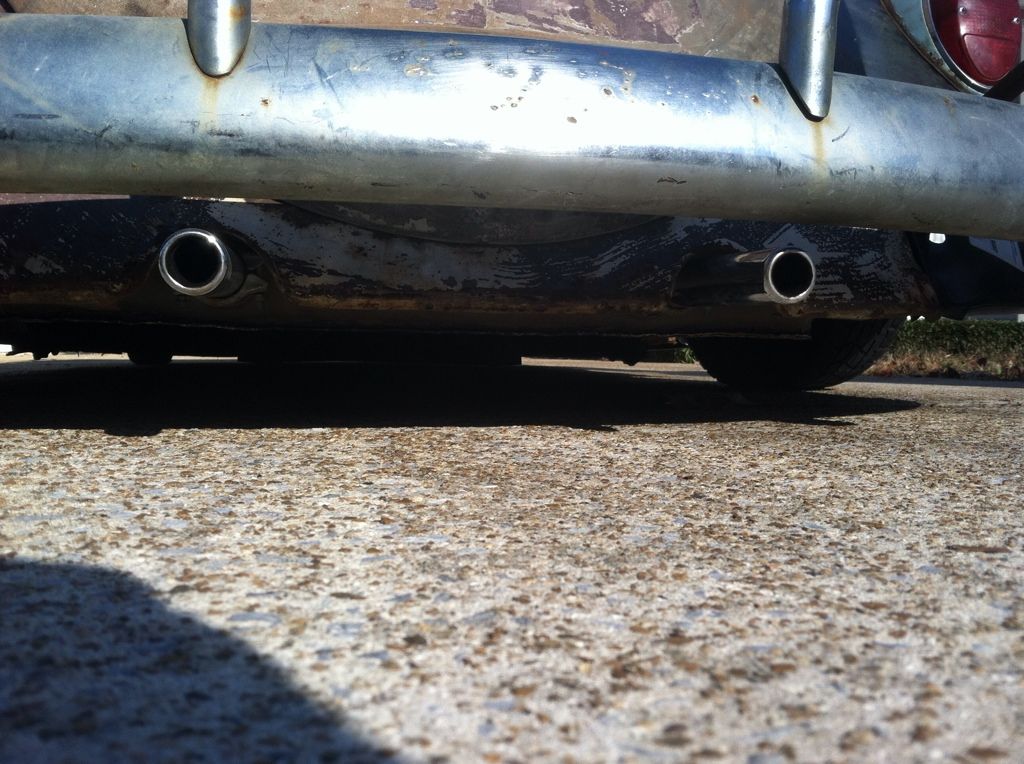

Here is the exhaust getting extended.
Frame head off to trim it back.
Going back on.
Back on.
Fixed the front wheel location, well off the buckets now.
Flipped tie rods and you can see the trans nose cone above the tunnel. Running a external shift rod.
Building a raised shifter base from a junk tunnel. All the welding on the pans in this shot was done by the po and had to be redone.
Made a 2 piece shift rod so the shift rod bushing could be replaced without pulling the body. Also moved the park brake handle over a little to clear the shift rod.
Cut the floor out for the flat pan, made some cuts and flattened it right out.
Got the exhaust tucked up nice and tight,then bent the pinch welded seam over for added clearance.
Started the tub action, you can also see the raised package tray.

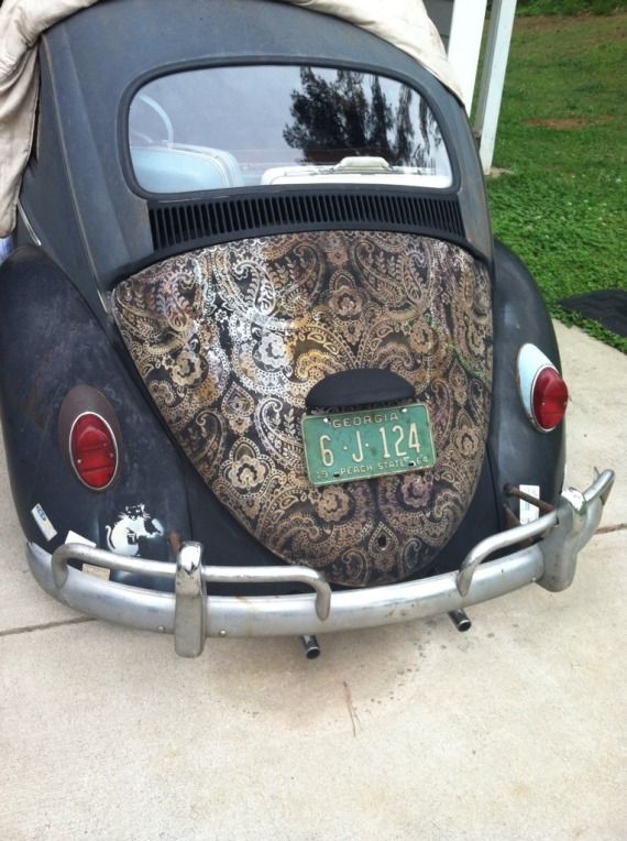

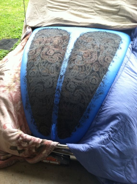

Did some paint work today, also got my wipers working, but that was boring...the paint turned out pretty cool tho Very Happy
The rear deck lid. I just painted over the rust and all hahaha.
Here is the hood with the tape in place.

Post by Attack chicken on Fri May 03, 2013 8:43 am
bayboy87 wrote:is that a wrap on the hood and trunk or stencil? looks great ! cant wait til i get the body doneon mine and get it dropped
Thanks everyone! Its actually like a stencil you lay out some lace, in this case it was a table cloth, then you spray paint over it, the paint ends up being the reverse image of the lace. Its pretty easy to do especially when the most perfect result isnt required, the hardest part would be placing the lace straight and laying the paint down evenly. I guess that's just the hardest part about painting in general but with the fabric sucking up the paint it can be a little tough to tell when you have put enough on in some areas. I used a flat black so combined with the rust/rough surface and the flat paint it really looks like it has some type of texture to it.
