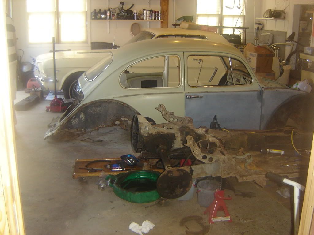

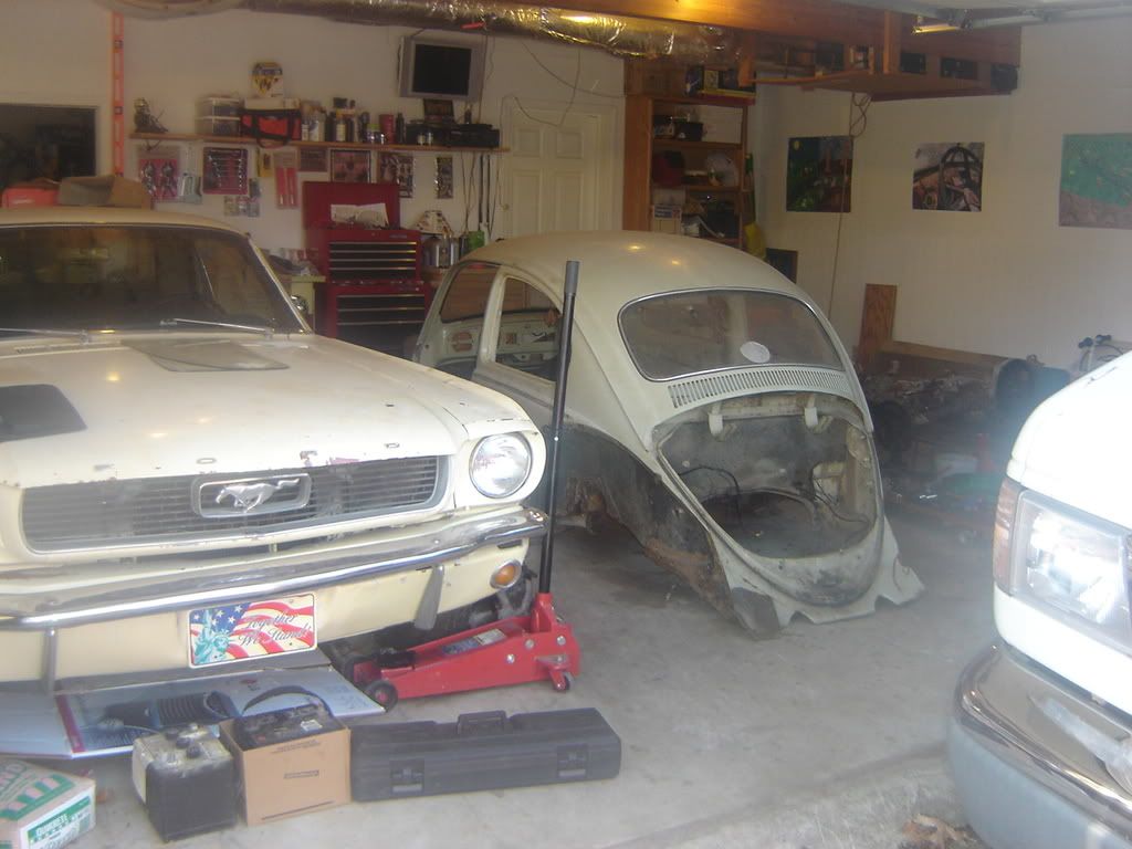

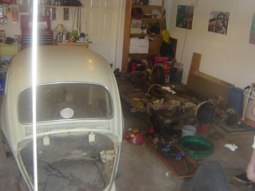

Here is what I have accomplished today - sorry no before pics I am always bad about that.
