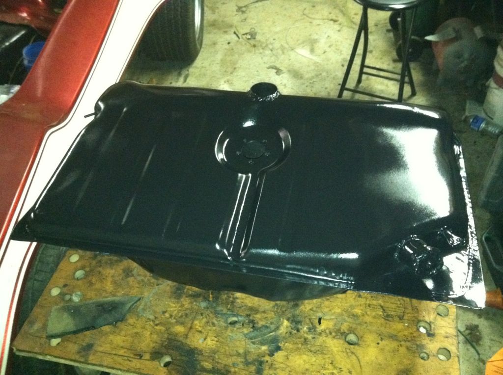

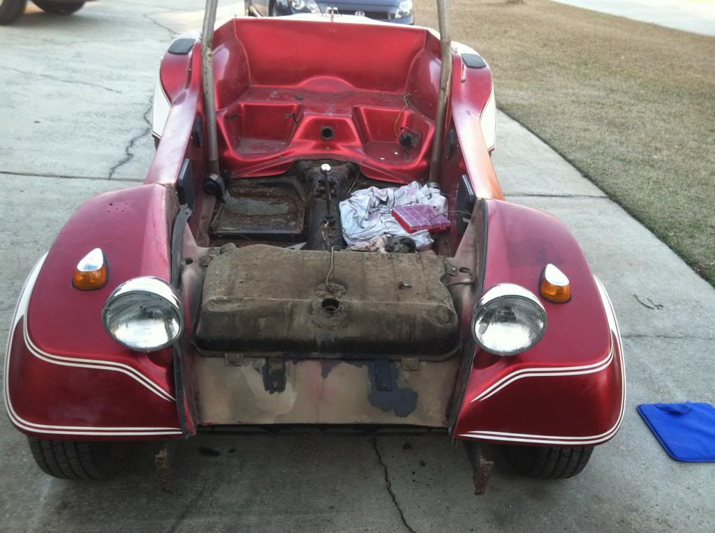

I am now to the fun part of the build! I have been working really hard on the buggy the past four days. Thanks to all the rain last week and valentine's day I wasn't able to start painting until Friday. I finished up all the sand blasting on the body when I got home from work on Friday and was able to put on the first coat that night. I installed all the new ball joints with a cool little tool I welded up. I will post that in the tips and trick section later today. I worked on getting all the small parts blasted and cleaned for paint. I was really pleased on how well the transmission turned out. I sandblasted it clean and hit it with a can of metallic paint. It really made it shine! All the paint was dry and ready to work with late Monday. I got started with bolting on the frontend and getting the arms and spindles installed. I got the new tie rods and steering dampener hooked up. Late last night, I installed all the brake hardware and got all the hubs installed. I looking forward to have it rolling again tonight. I can finally park my other VW back inside. Here are a few pictures I had on the computer at the time. I hope to update the post with more photos later today

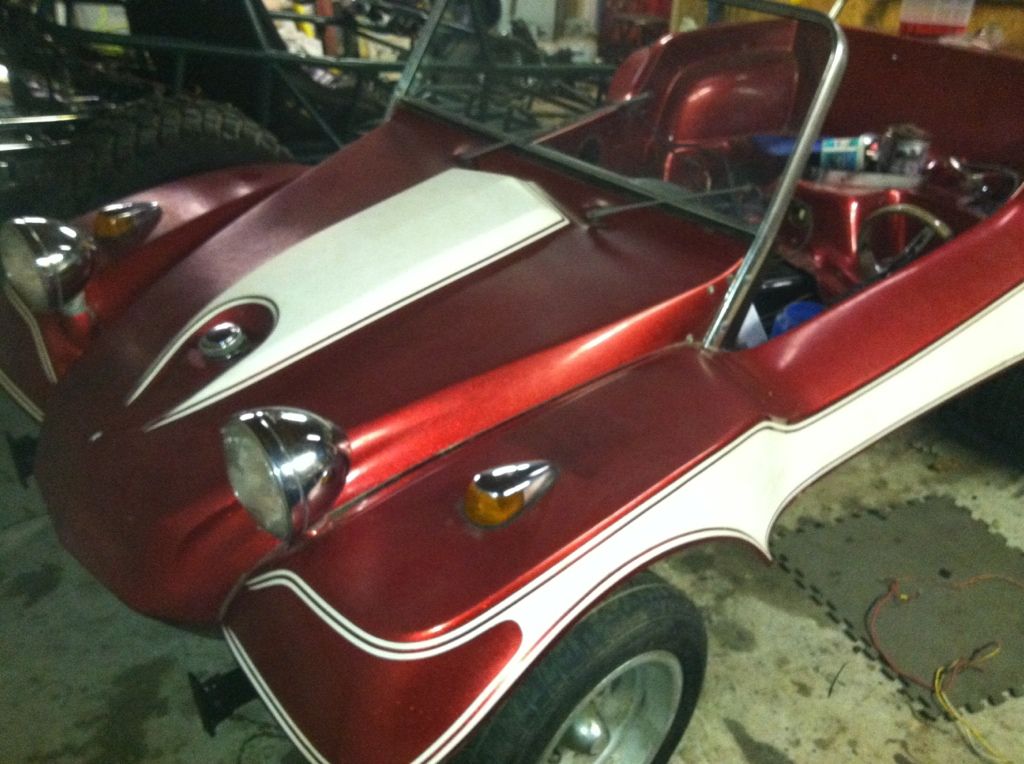

Here are some more pictures from the last few days.

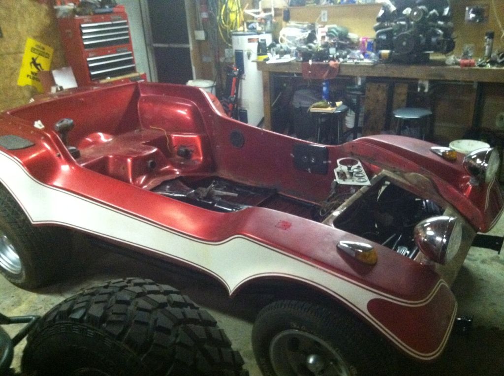

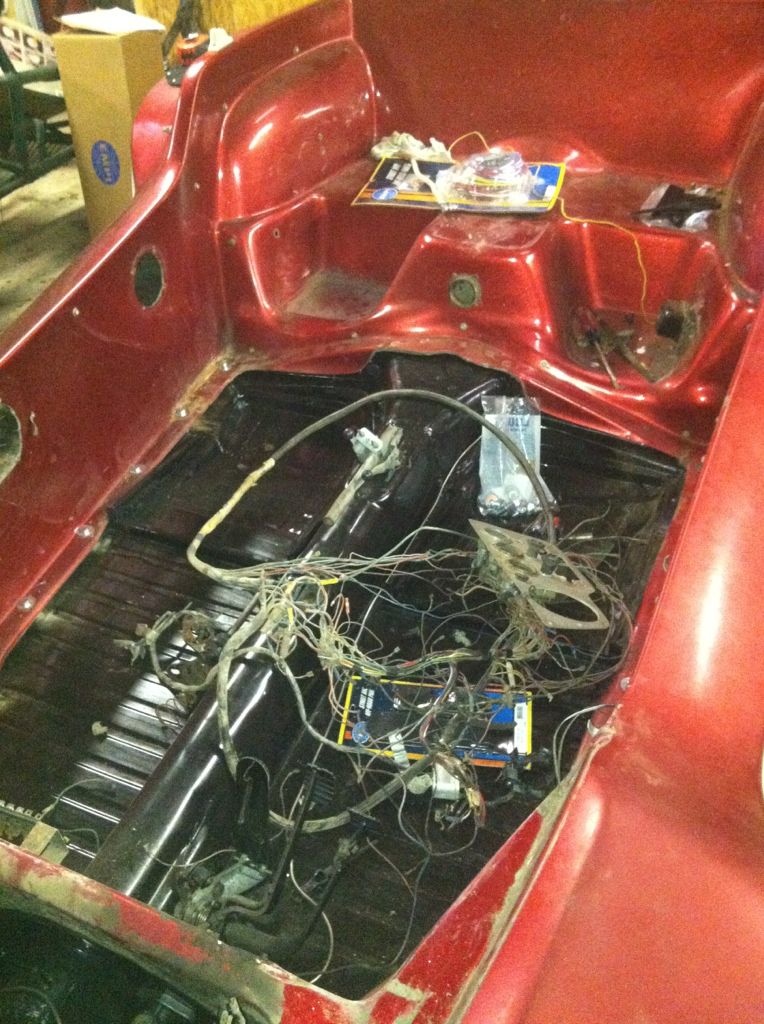

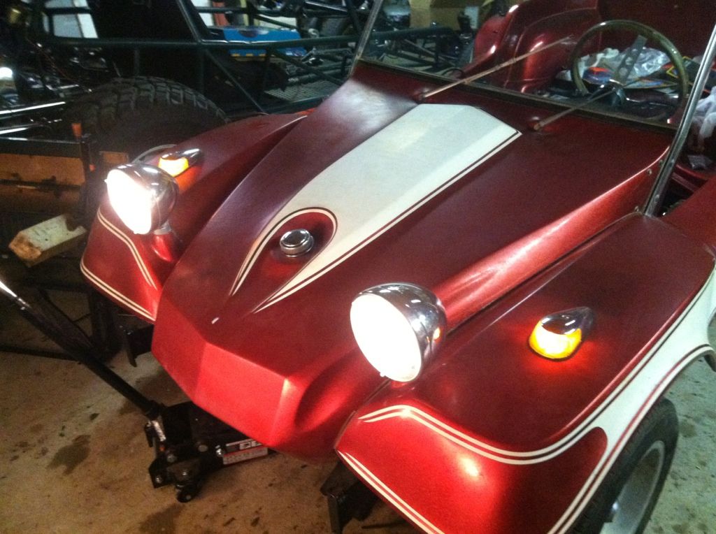

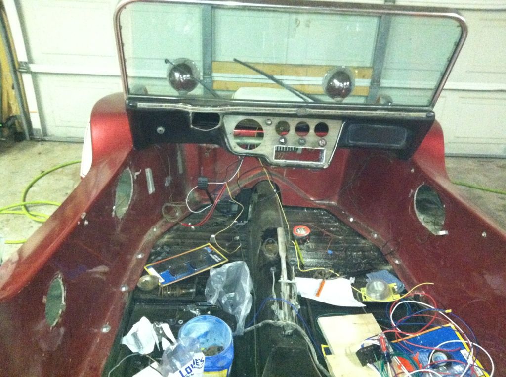

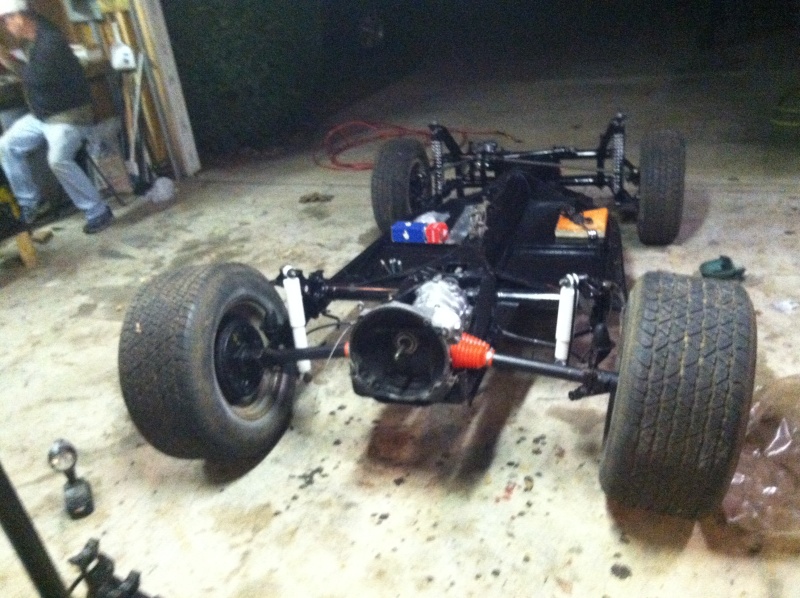

Here is the recent progress on the buggy from the past few days. I got the body bolted onto the chassis and put some used 13” tires on the front. I removed almost all of the old wiring and I am preparing to start rewiring it this weekend. That car had a lot of splices and electrical tape so I felt it would be better if I completely rewired it. I rebuilt the bottom end of a stock engine about a week before I bought the buggy. I originally planned on putting it in a baja project. I decided I would use this engine for my Allison. In the past few days, I slipped in some 87mm pistons and installed some new valves and valve springs in the heads. I also got the motor tins blasted and painted. I put the engine all together and installed it into my rail buggy to test it tonight. I got the motor to crank a few times and ran it for about a minute and it sounded like it was going to run good. Nothing like the smell of a new exhaust smoking!!! The engine was a little louder than I thought so I will break it in tomorrow to keep the neighbors from getting mad. I might take it for a spin in the rail buggy tomorrow.

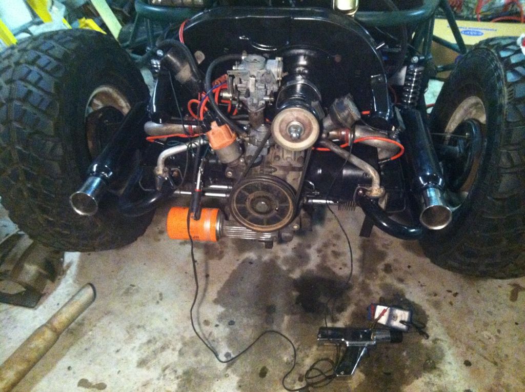

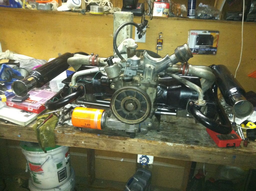

I finally got the motor right… I had to split the case again this weekend thanks to the main thrust bearing not lined up correctly on its dowel pin the first time. It sure was good I only ran the motor for about 10-15 seconds last week. I noticed how tight the motor was when I went out the next day to tune the motor. I completely took apart and rebuilt the motor with a new main bearing this weekend. I got the motor bolted up to the buggy again to test it out tonight. I wasn’t getting any oil out of the sending unit on oil pressure test. This was the first motor I have had to pack the oil pump with Vasoline to get a good prime on the sump. Do any of you guys do this? I have built many motors and never had to do that. I guess there is a first for everything. Here is a short video of the motor going tonight. I think it sounds pretty good. I need to get the dwell meter on it and tune the carb a little motor. I’m going to break it in tomorrow.

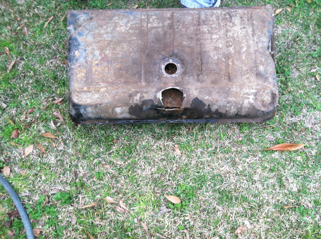

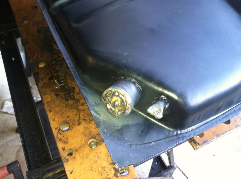

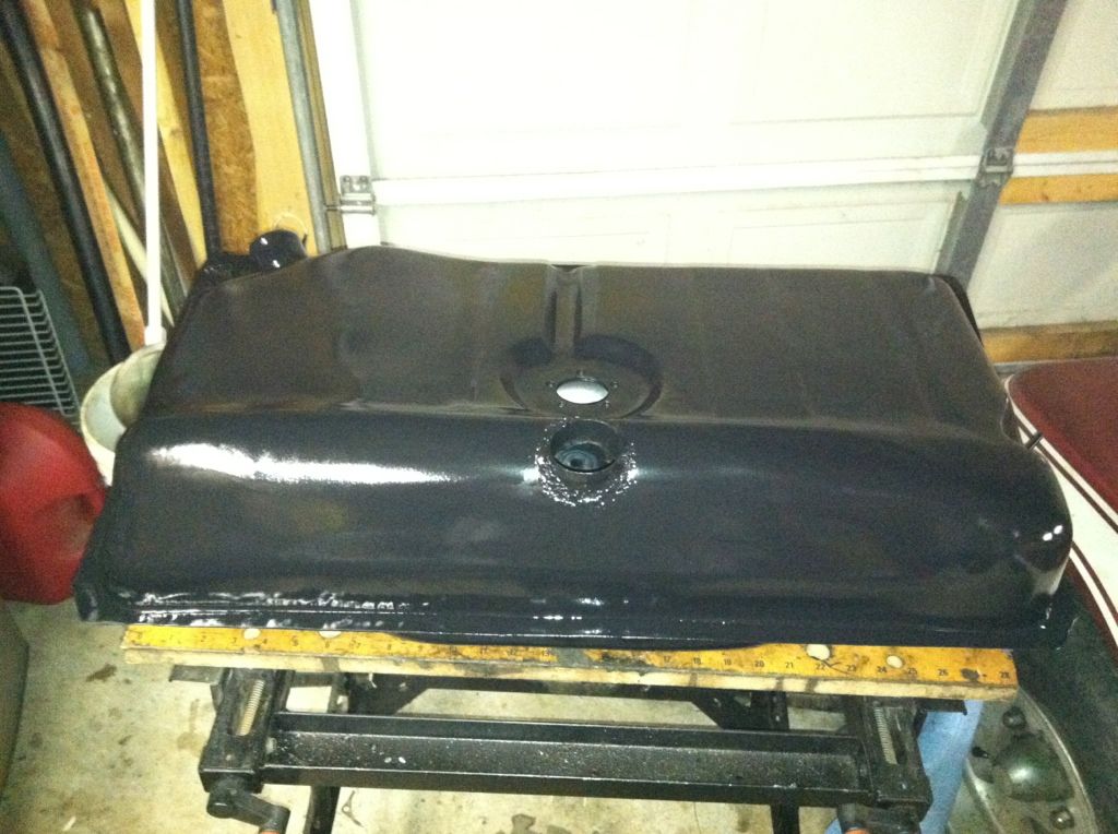

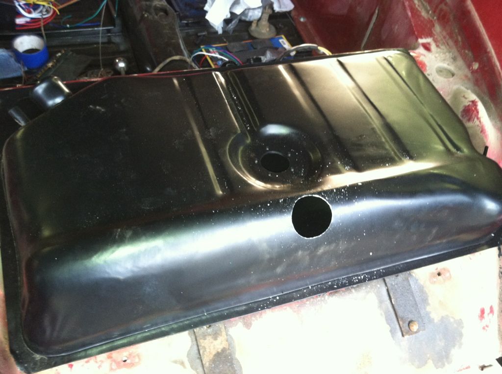

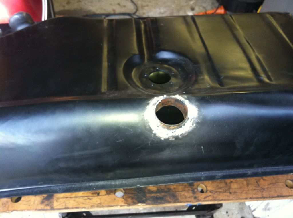

Between the car show and having to work late at work, the progress on the buggy slowed down a bit. Now that things have slowed down at work, I have picked the pace back up. I ran a new main wiring harness and got the rear end of the buggy all wired up. I made sure all the lights have a solid ground to the frame since they won’t ground to fiberglass. I wasn’t able to wire up the front of the buggy since the hood and dash were not installed. This meant I had to tackle the gorilla in the room. MY RUSTY GAS TANK!!!! I dumped about a coffee can or more of rust out of the tank. I filled the tank with water and it made an awesome watering can. I decided that is was time to move onto plan B. I went out to Bug-eyed and bought a new tank. I was nervous because I knew I had to perform plastic surgery on it. The Allison’s have a center fill cap that slide down into a hole made into the middle of the tank by the sending unit. There is nothing like buying a new gas tank and cutting a 2” hole into it. The biggest thing was making sure the 2” hole was in the perfect spot or all hope would be lost. I luckily measured twice and cut once and got it right the first time. I didn't have the ability to braze the tank so I took my time and used the mig welder. The weld was good and I didn’t think it would have leaked but I decided to go over the weld with some solder to make sure it filled any possible pin holes. Here are some pictures of the tank work I did the past few days after work.
Before
It lined up!!!

Post by ASBug on Wed Mar 20, 2013 9:04 am
Nice!

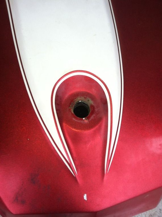

Did yours have a flip up or did it have the original coin edged screw down cap?
Solder over the weld is a great Idea... I'll steal that one.
Re: 1968 Allison Daytona Dune Buggy
Post by macollins105 on Wed Mar 20, 2013 11:47 am
ASBug wrote:Nice!
I believe I have the original screw on cap that screws down to the body.

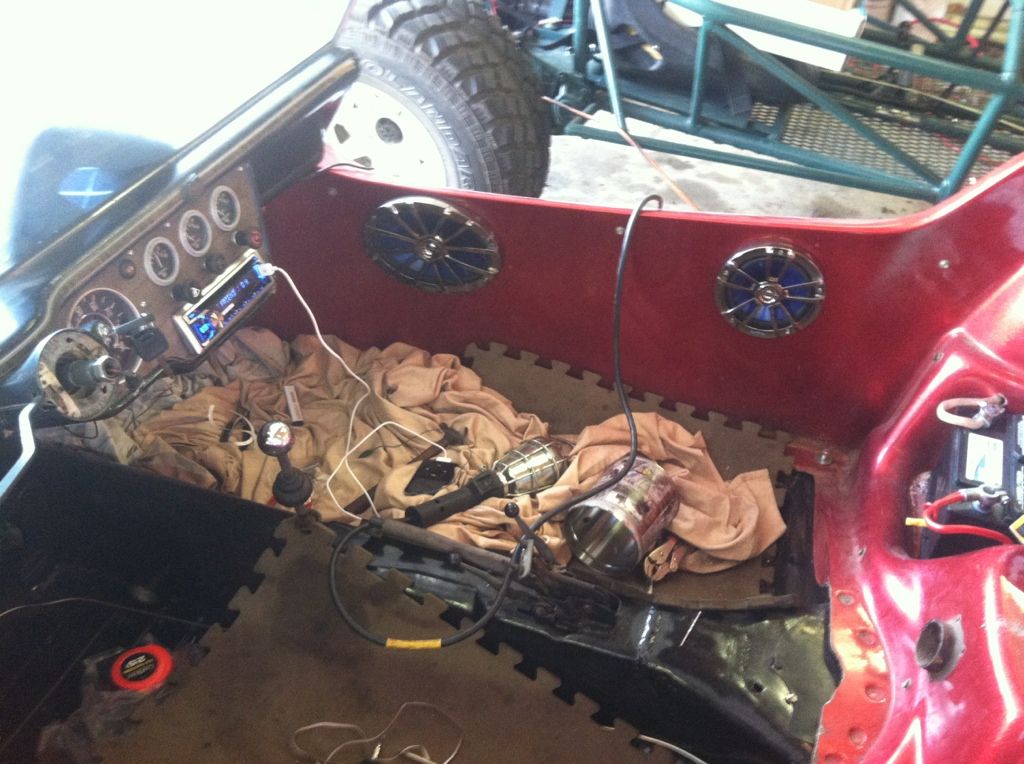

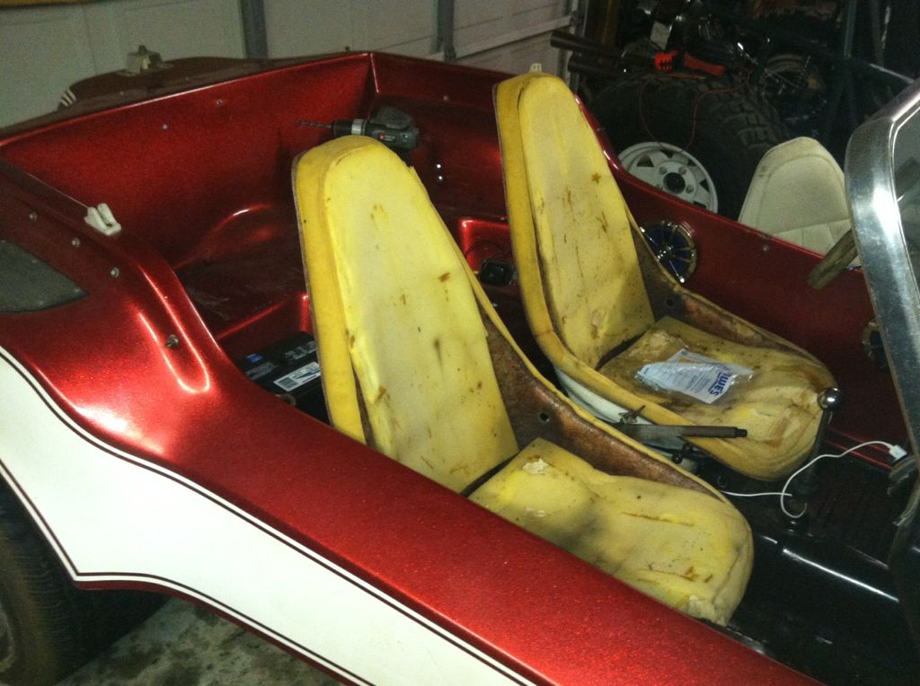

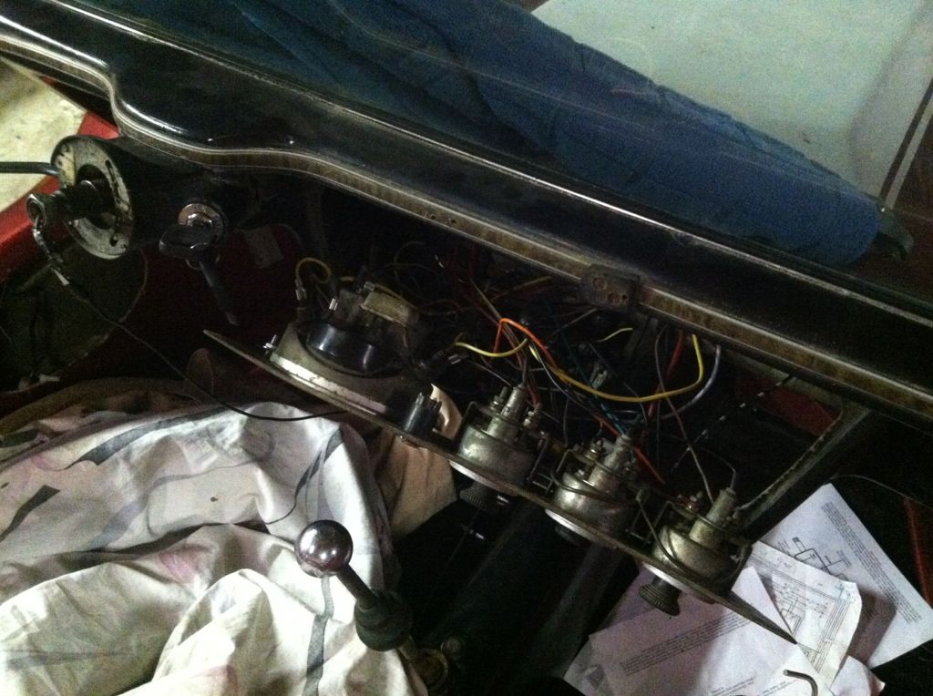

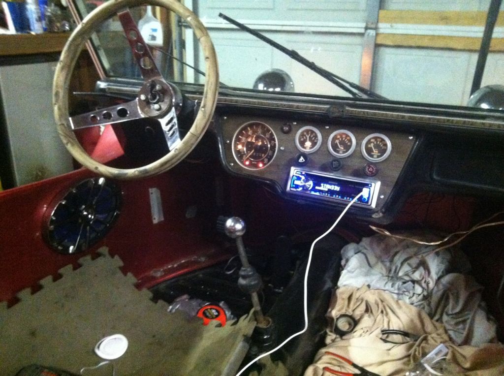

I’ve done a lot of work on the buggy the past week. It was a slow process but I got it completely wired up. I also got the marine radio and speakers installed and it sounds awesome. Here are some photos of the progress the past week or so.

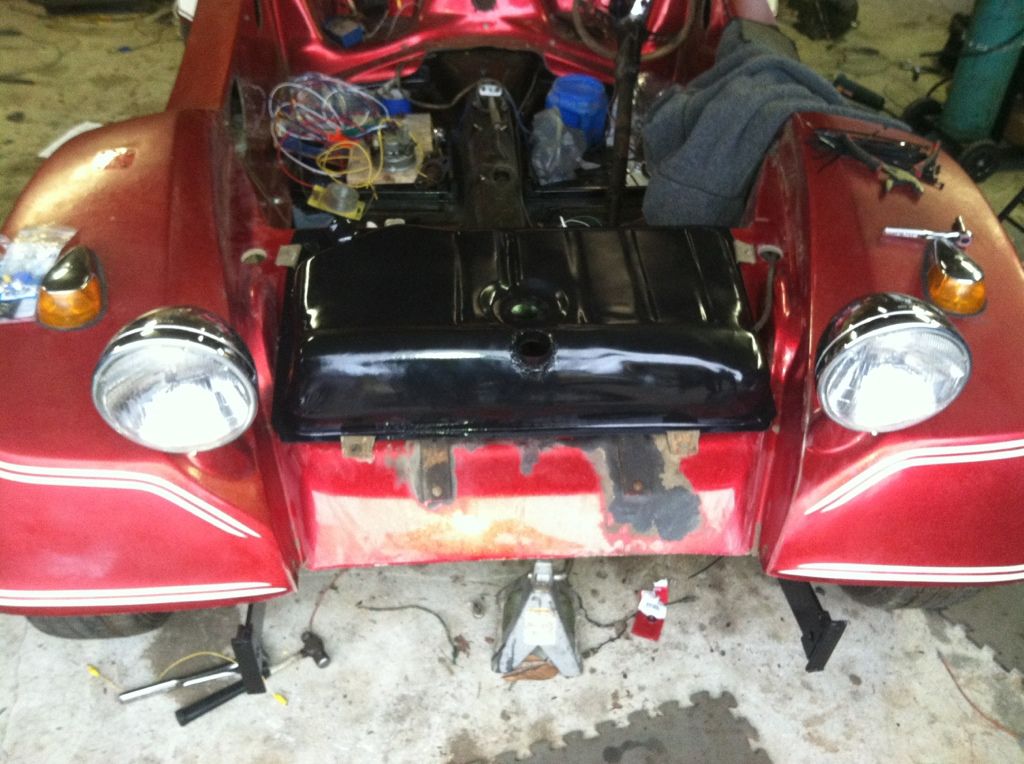

I’m getting closer and closer! I can tell this thing is going to be a lot of fun. All the hard work is really starting to pay off. I finished a lot of odds and ends this weekend. I hooked up the gas line and adjusted/bled all the brakes. I filled the front beam with grease. I got to drive the buggy for the first time Saturday night. I took a video of its maiden voyage. I adjusted the carburetor, points, and timing today and it is running a lot better. Unfortunately, it rained all day and I was only able to drive it around the block once. I didn’t like how close I was to the steering wheel so I had to do some modifications to the seat rails. The buggy’s pan is shortened fifteen inches and doesn’t allow the seats to go all the way back like a normal bug. Today I cut off part of the seat rail and welded in a new support. This allows the seats to go all the way back now and I have a lot more leg room. I also got around to drilling new holes in the seat rails for the seats to mount. I hope to go to the tag office this week and get a tag for it. All I have left is the roll bar, seat belts, front bumper, and get the seat covers and top made!
