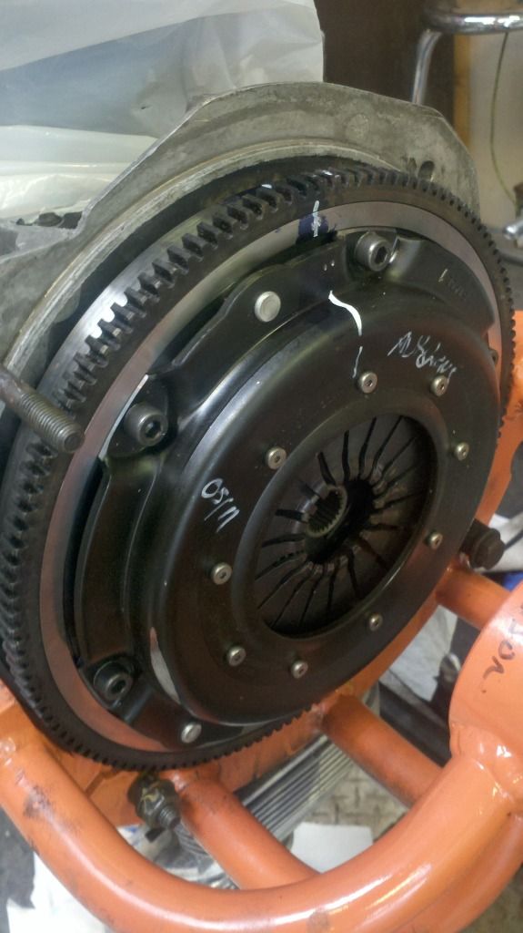

Post by type4revolution on Mon Oct 08, 2012 5:29 pm
if you have a pressure plate like this the collar removes by taking off spiral ring if you have a three finger PP just pull the clips off holding collar to fingers
