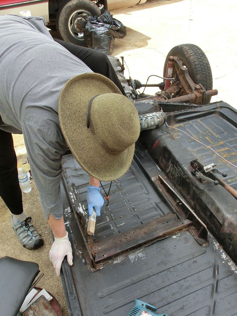

Here are a few more pics of the progress. Kat came to help sand, prime, seal, and paint her floors.
I still have to turn it over and do the underside.

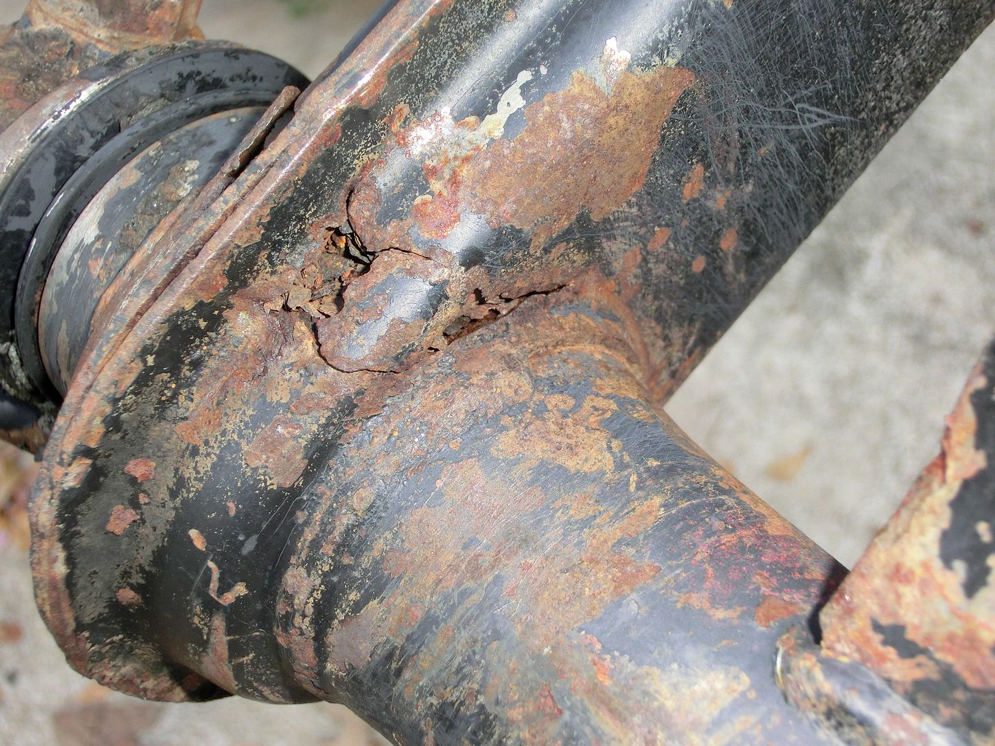

So I've moved the pan inside to work on it. I started on the front beam and was just going to clean and paint it before putting on the new brake hoses.
Well as usually happens with VWs, I found some rust holes. These were in the shock tower, so I pulled the beam and cleaned and painted the frame head while it was exposed.
I took the beam to the car wash and degreased it last night. Now I'll take it to get welded, then I'll finish cleaning and paint it.

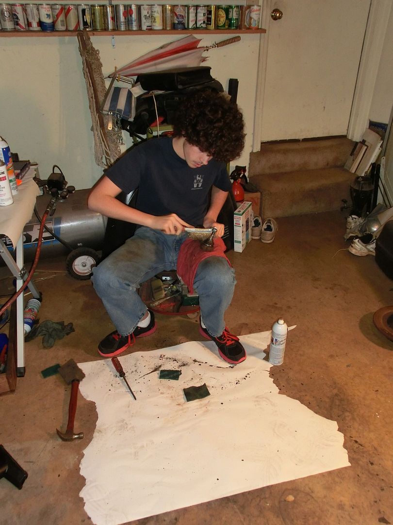

Painted the backing plates. Cleaned the lug bolts and other nuts and bolts in the vibrating cleaner. (kinda like a rock polisher)

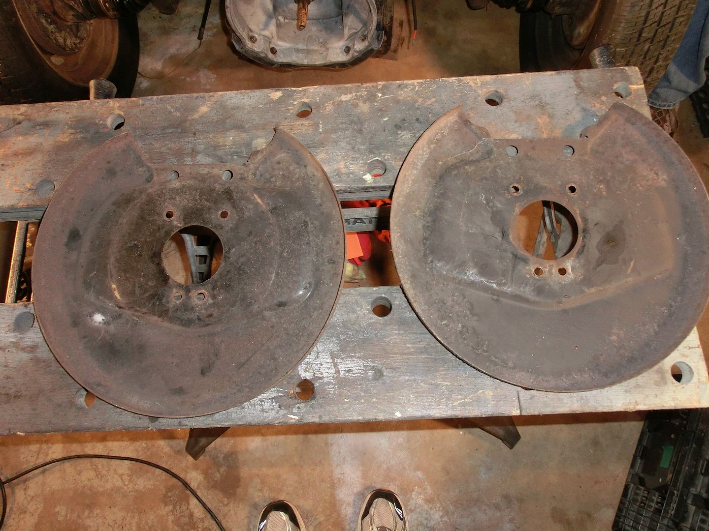

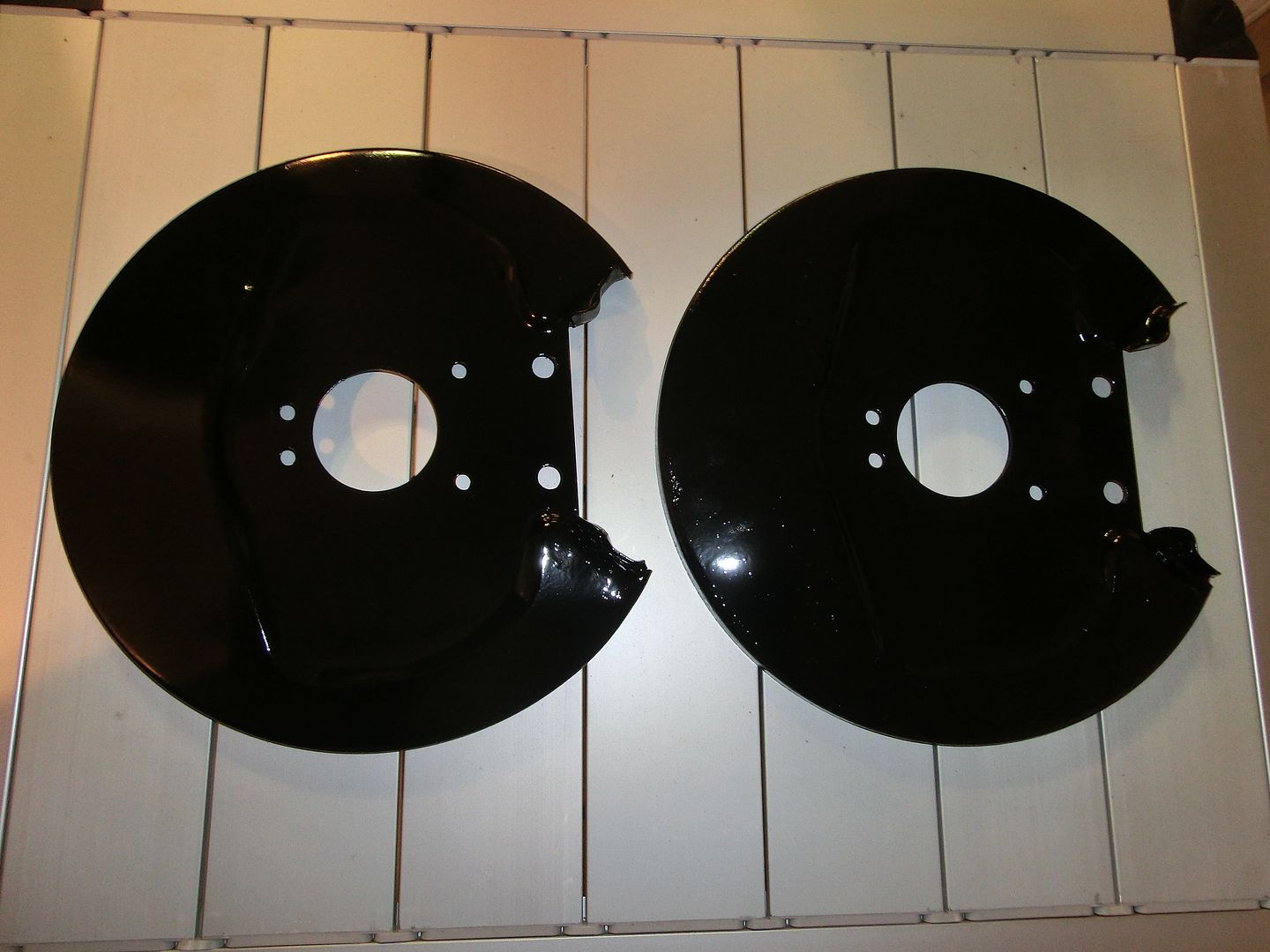

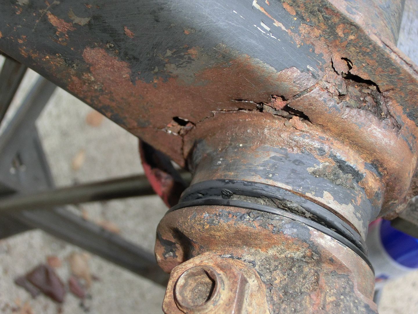

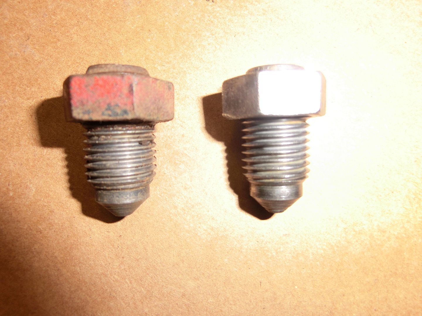

Post by Hobug on Wed Dec 05, 2012 11:00 pm
Here are some pics:
The rusty parts of the shock tower. It is only on one side and I am going to get it welded up.

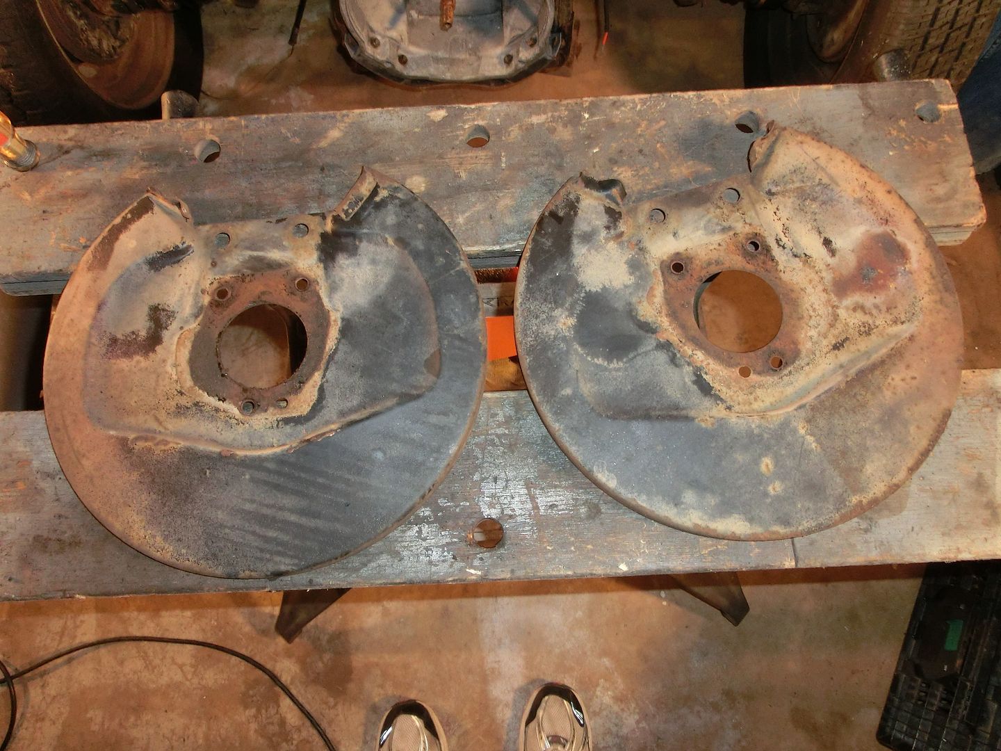

Backing plates before cleaning and painting.

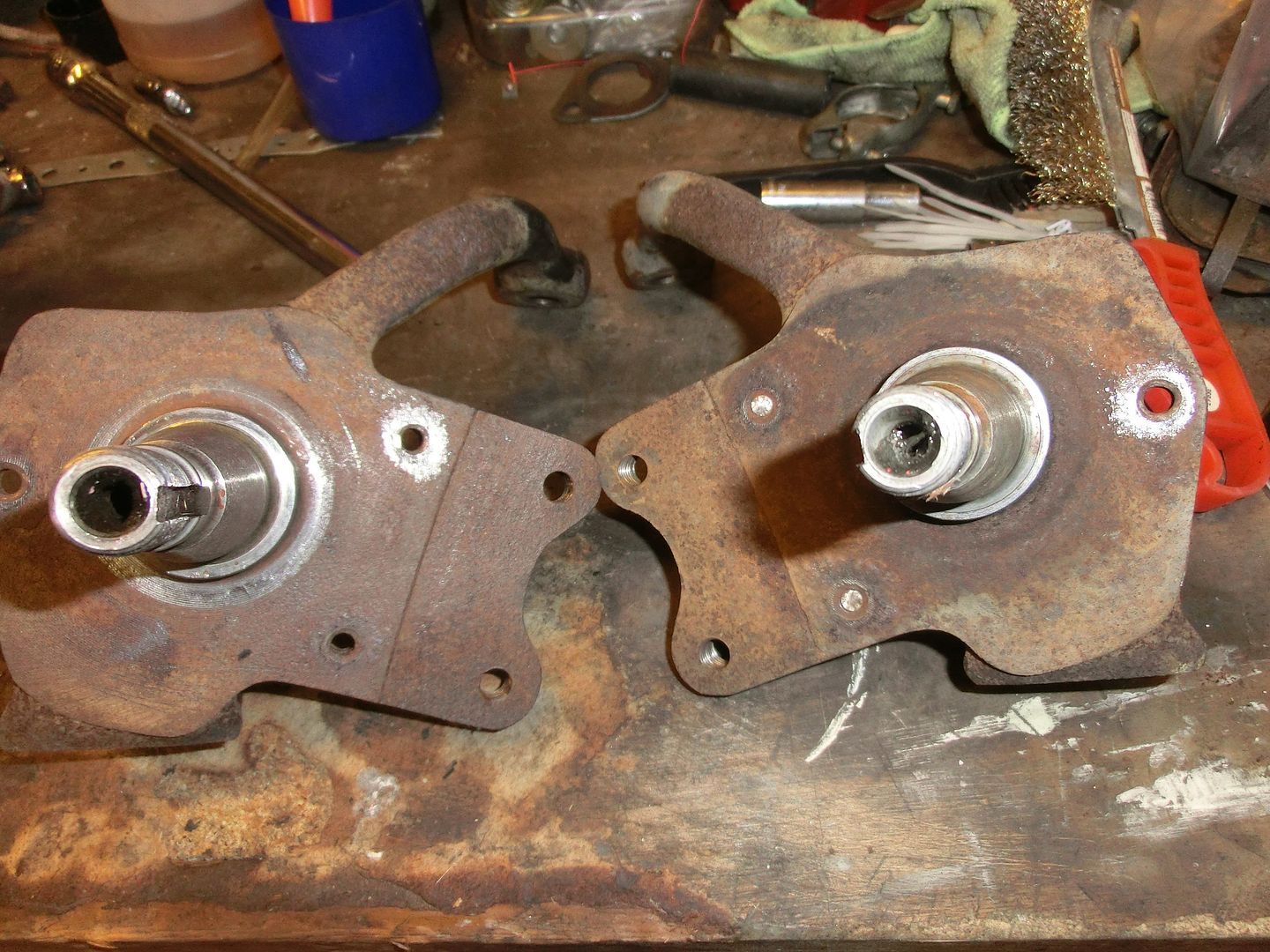

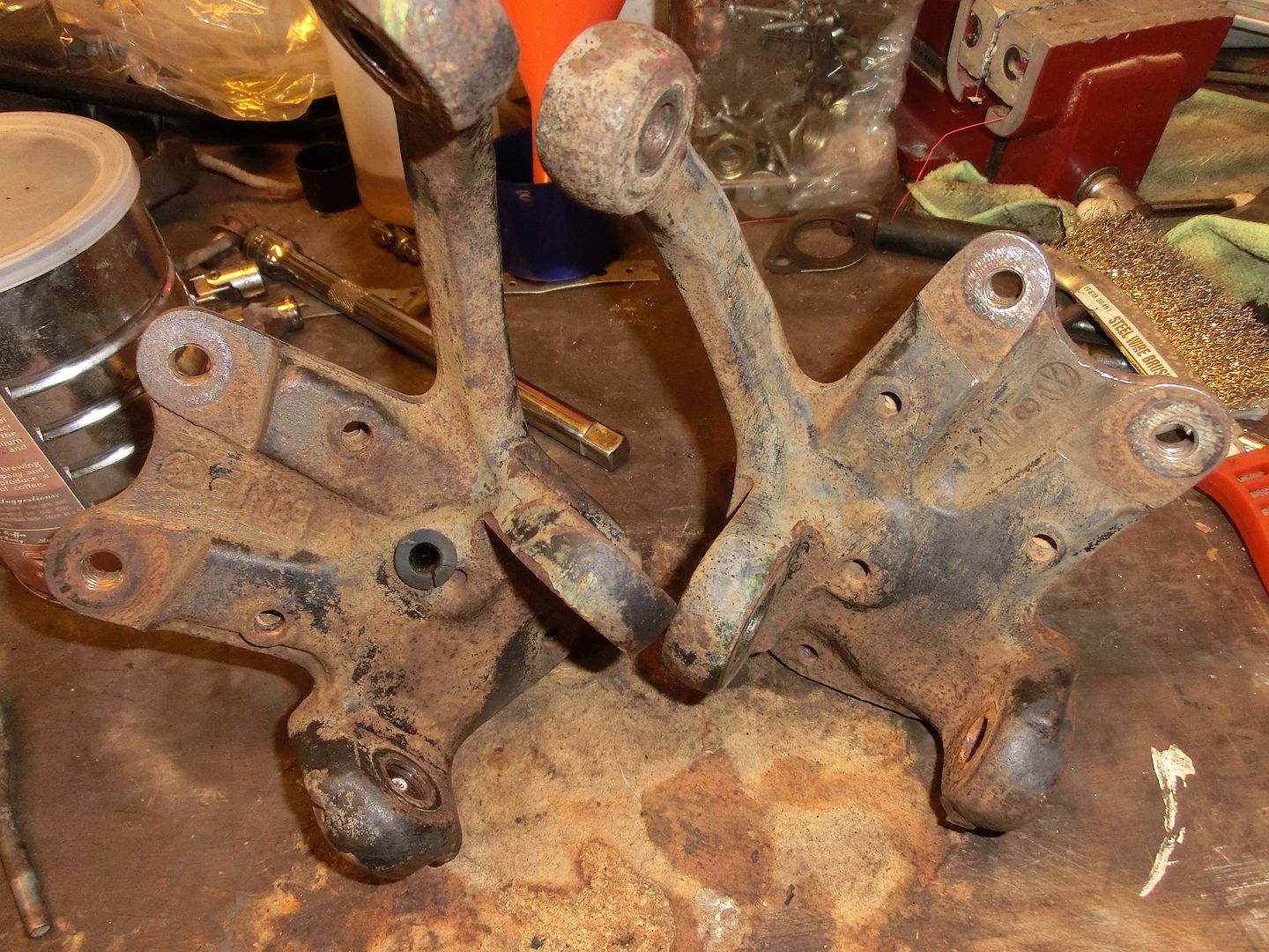

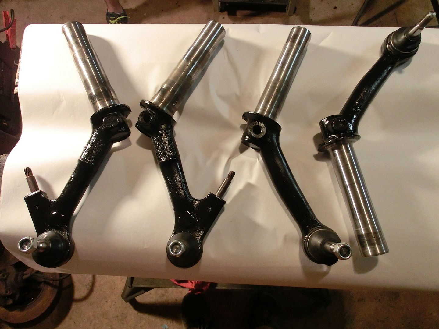

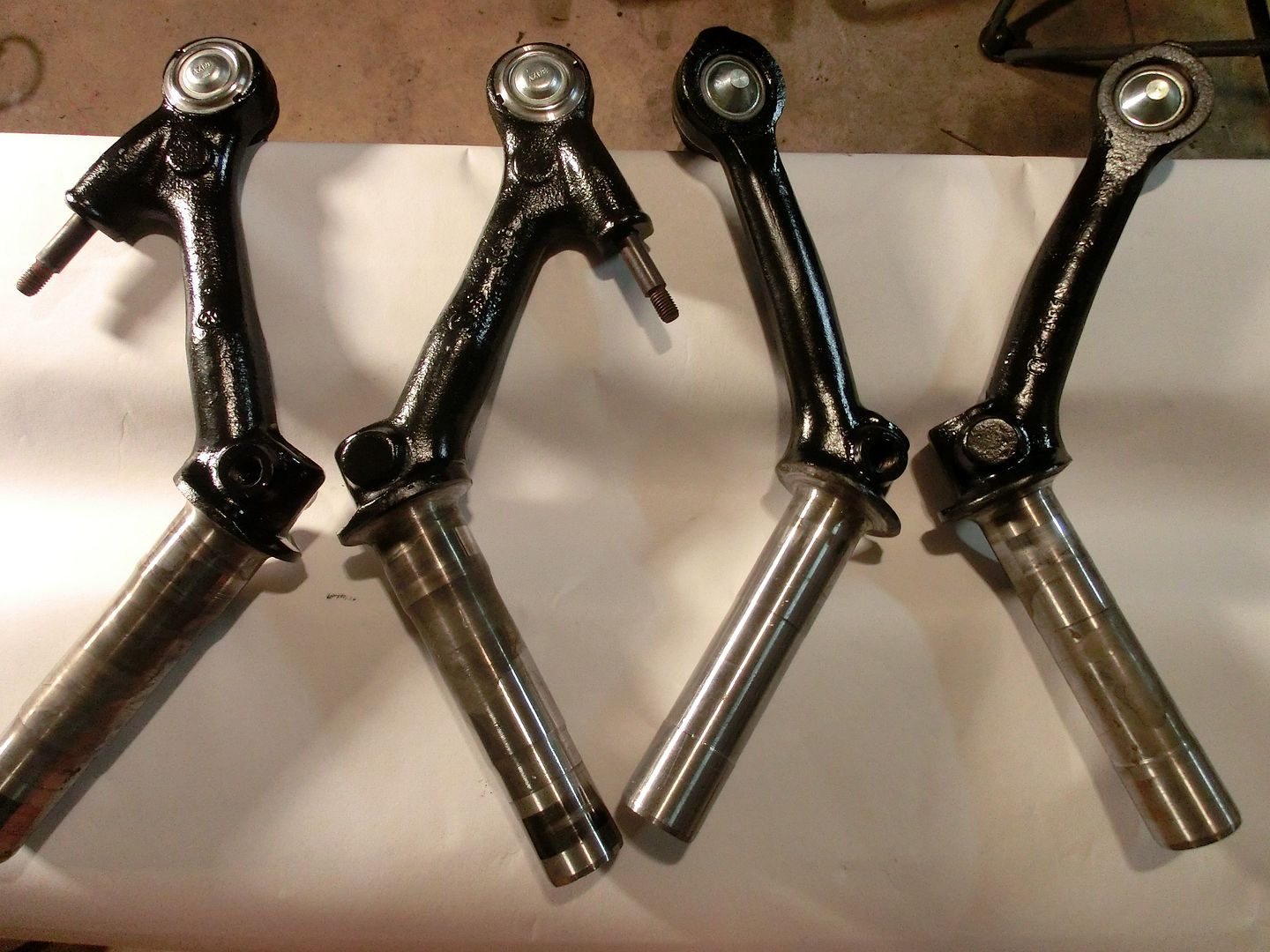

Spindles before:

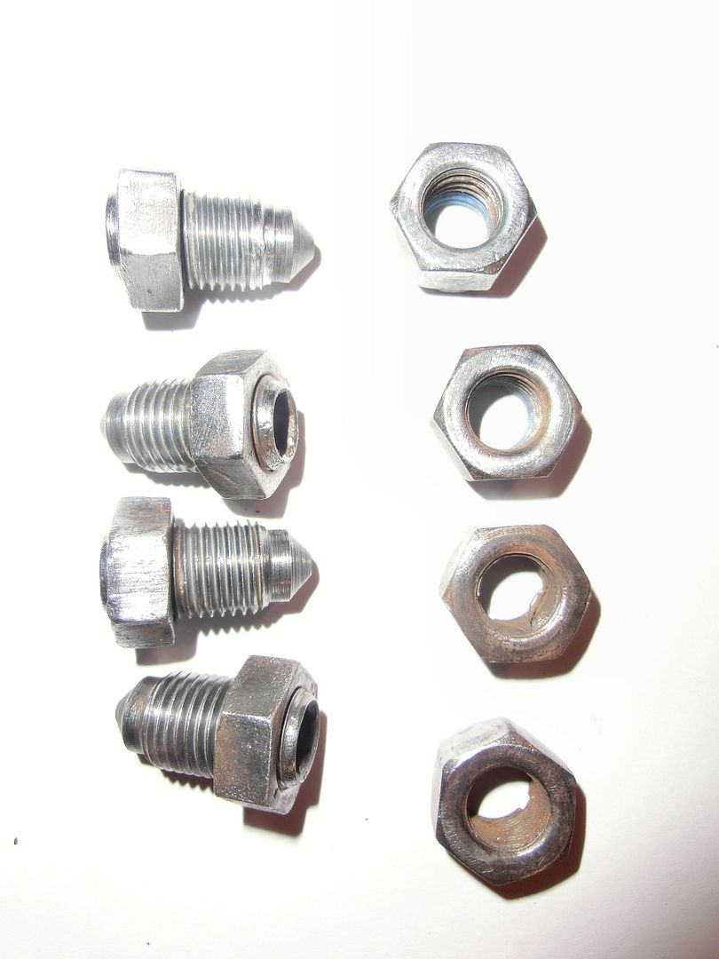

Grub screws before and after:

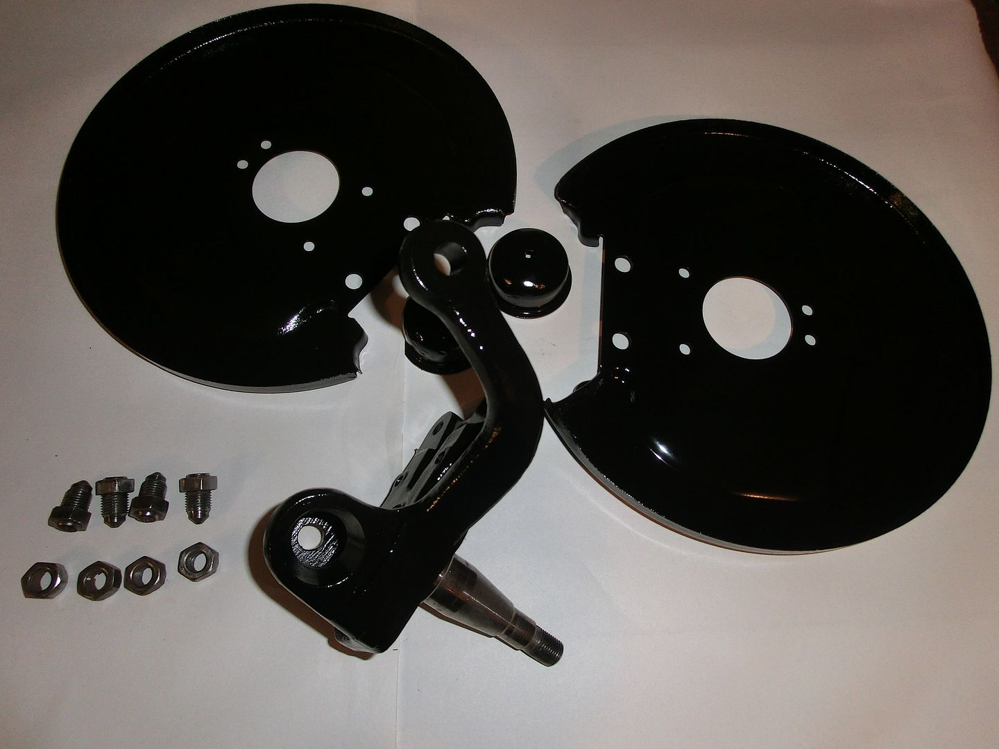

Backing plates after:

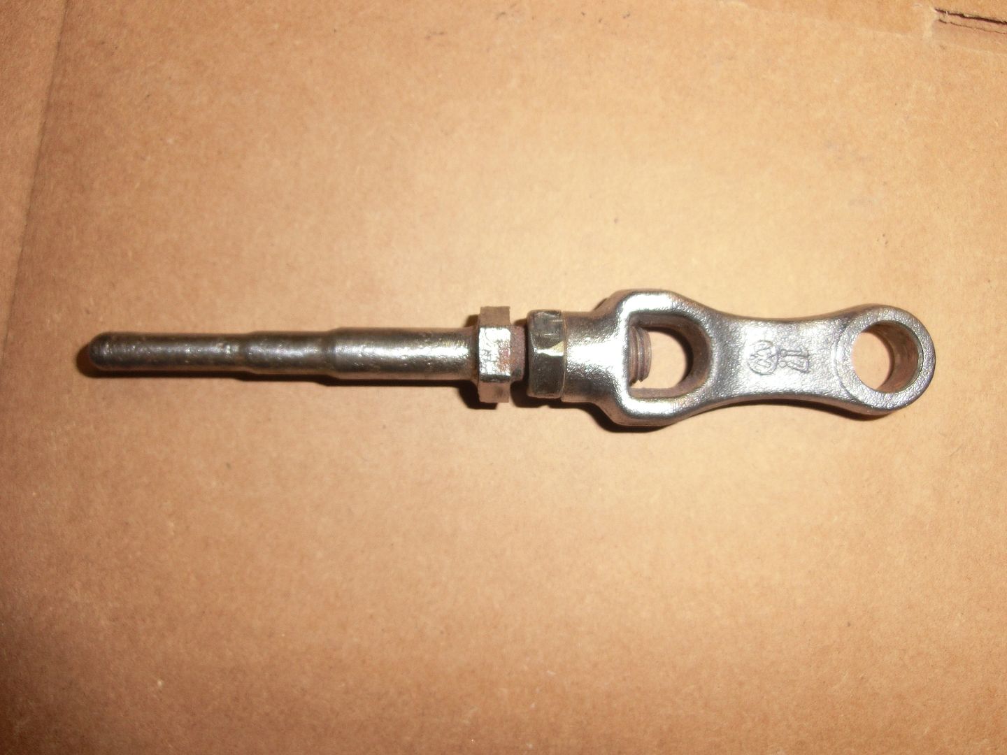

Brake push rod:

Front end nuts and bolts
Several of the parts painted and ready

Post by Hobug on Sun Dec 16, 2012 5:58 pm
Rust is cut from the beam and it is welded up. Thanks Joe. Very Happy

Post by bayboy87 on Sun Dec 16, 2012 6:23 pm
did you use a tumbler or a wire brush to clean the bolts? i have alot of rusted bolts

Post by Hobug on Sun Dec 16, 2012 6:39 pm
bayboy87 wrote:did you use a tumbler or a wire brush to clean the bolts? i have alot of rusted bolts
Wire brush in the drill, but many times I will use the tumbler and finish them with the wire brush.

Post by Hobug on Fri Jan 04, 2013 6:20 pm
Trailing arms are ready to go. New ball joints installed thanks to Clyde. I put my son to the task of cleaning the spindles to prepare for painting and then I primed and painted them.
