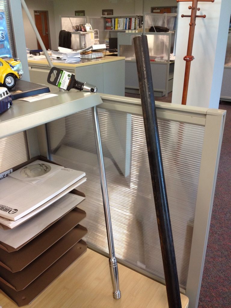

Yea Grif, I have soaked it every day for the past three days with blaster. Here is what I picked up today at HF and from the shop where I work.
25" Breaker Bar & a 5' piece of 1" XH (.179" wall) pipe! If this doesn't break it lose, I don't think anything will and I will have to try and get the axel nut off and take it off as a complete piece. Will let you know how it goes!

Post by ASBug on Mon Apr 09, 2012 3:42 pm
Good luck.
Just remember to hold on to the rain gutter so you do not fall when it pops.
I have that same breaker bar and it has held up well after 3 years.
