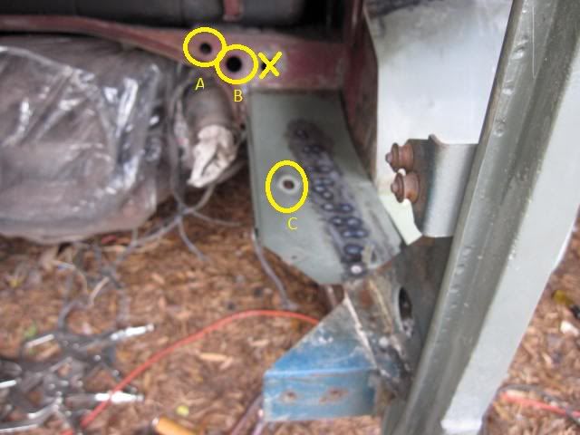

3. Engine compartment. I have three holes marked below. What goes through A, B, and C? I'm thinking A is the wires for the fuel sender, oil sender, coil, and voltage regulator, B is for the Battery cable, and C is for the taillight wire harness. Is this correct?

Thanks Digger! That does help. I'm pretty sure I've got the engine compartment routing figured out now. Anymore of the wiring behind the nose would be very helpful! Mainly looking for where the main harness comes into the cab.
