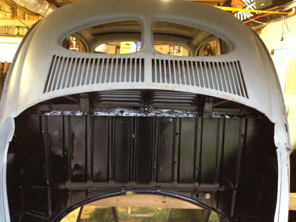

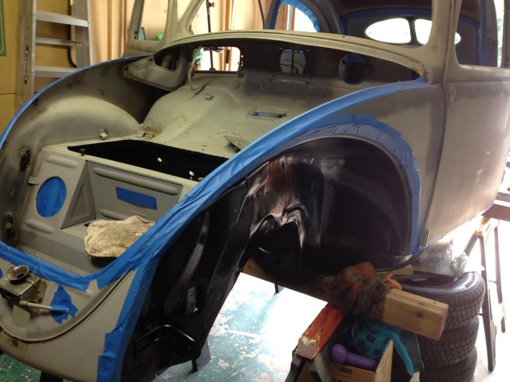

Post by Raggtop on Wed Aug 27, 2014 11:42 am

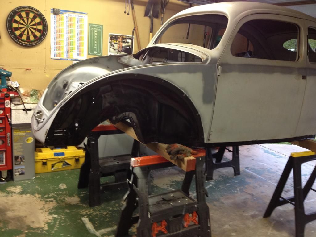

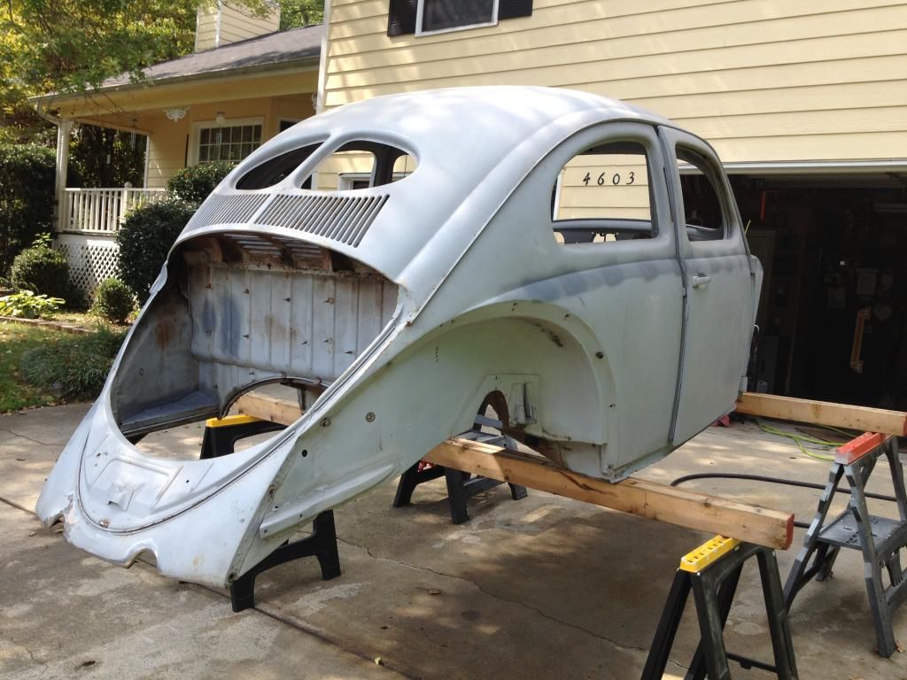

I have been doing things a bit slowly lately, but still going..
Prepping engine bay and complete underside of body for KBS Coating Rust Seal Paint

Re: 53 Zwitter (Calvin)

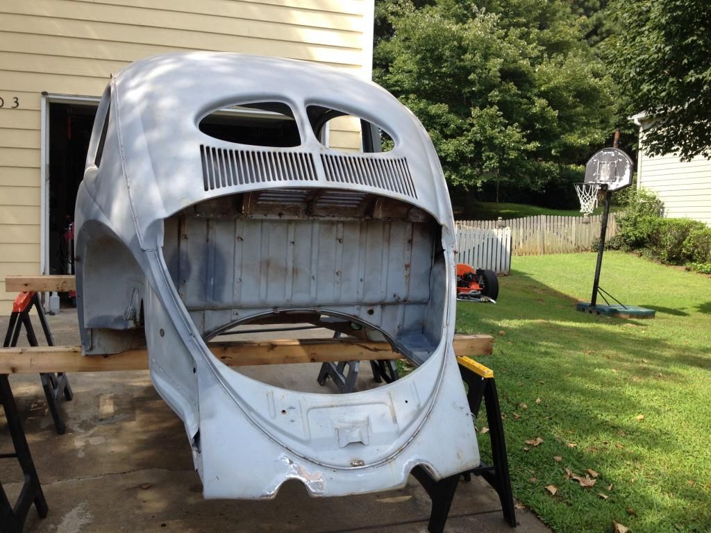

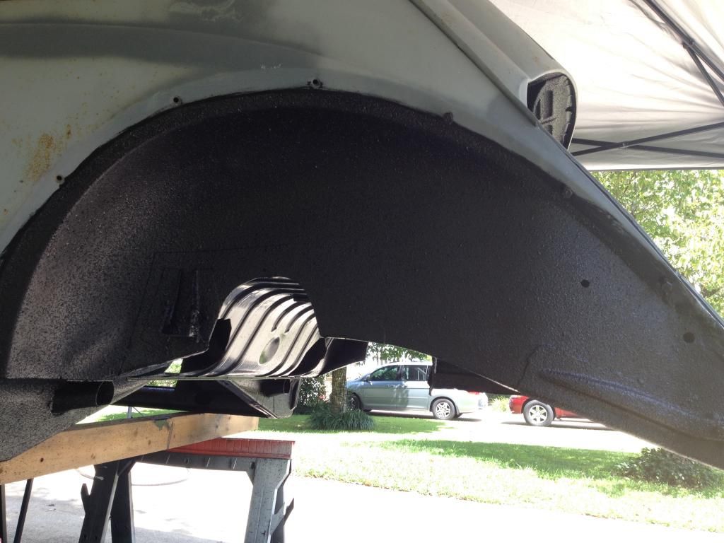

Post by Raggtop on Wed Aug 27, 2014 11:52 am
Underside and wheel wells painted. decided to hit the luggage area also.....

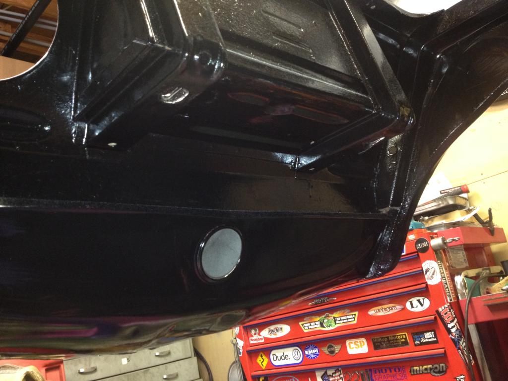

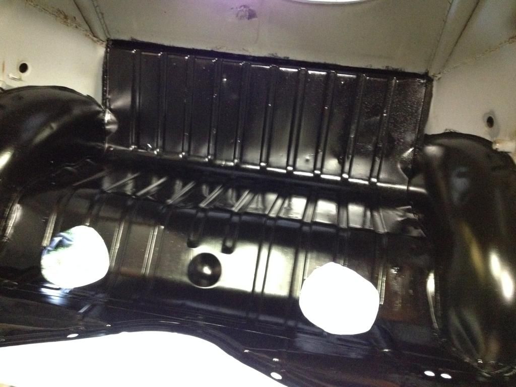

Post by Raggtop on Wed Aug 27, 2014 11:55 am
A bit of Smoothing out!  Twisted Evil

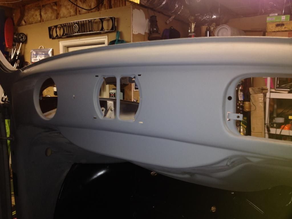

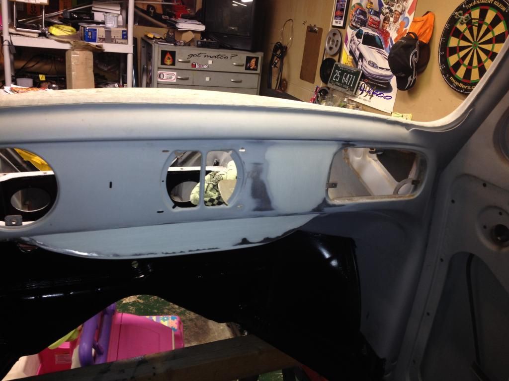

Post by Raggtop on Wed Aug 27, 2014 10:05 pm
Thx Bryce.

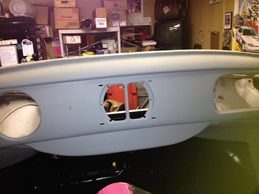

Worked on the dash a bit tonight, think I got
It just right.

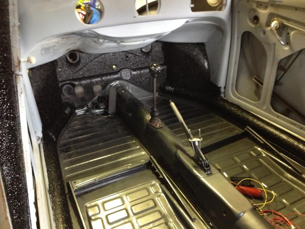

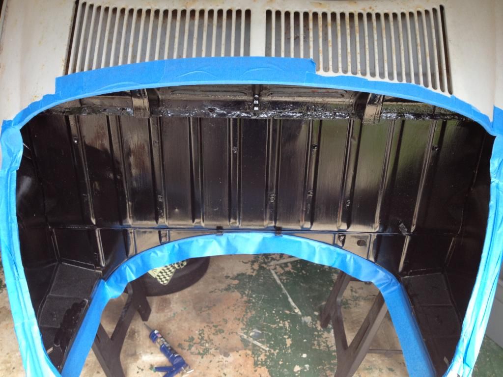

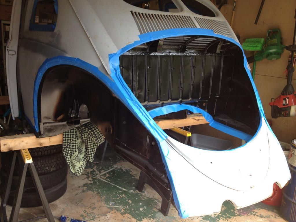

Post by Raggtop on Fri Sep 12, 2014 8:51 am

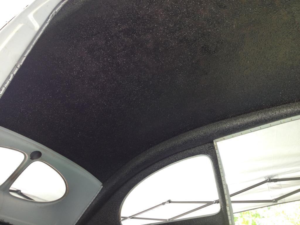

Prepping (taping) body for the spray in bed liner coating..
Number of posts : 420

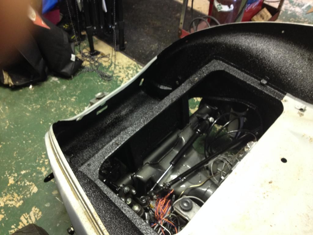

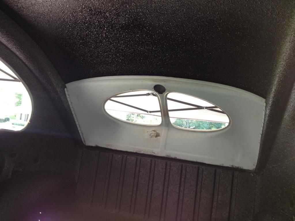

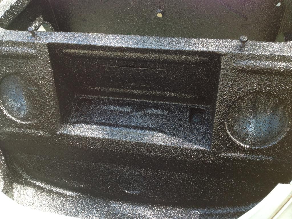

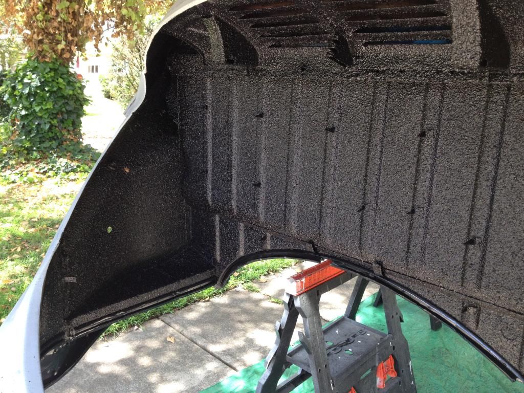

Post by Raggtop on Fri Sep 12, 2014 9:05 am
Almost everything your not going to see is sprayed with Liner Extreme spray liner. looks good.
very happy with it..

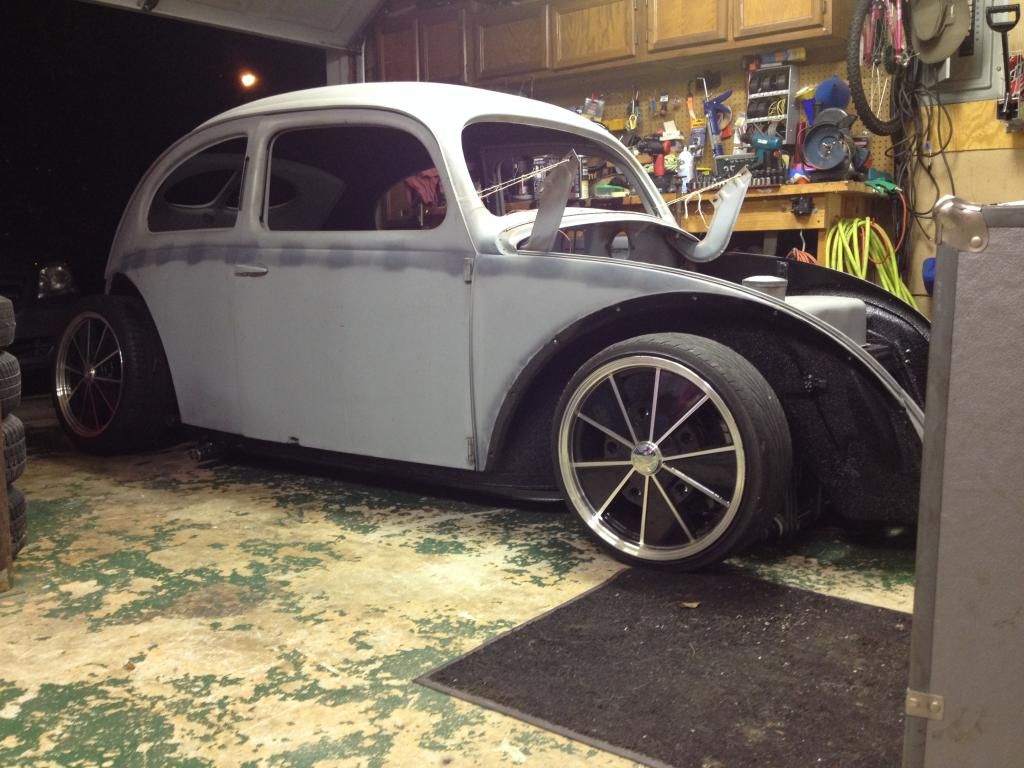

Post by Raggtop on Fri Sep 12, 2014 9:17 am
After tape and paper removal, decided to install engine seal and mount body back to chassis..
Post by type4revolution on Fri Sep 12, 2014 10:47 am
? You running caster shims behind that lower front beam tube. Just asking cause I believe I covered that in the class but not sure.
Post by Raggtop on Fri Sep 12, 2014 11:17 am
You did but wasn't 100% sure on my application
Because of the air suspension.
Post by type4revolution on Fri Sep 12, 2014 11:29 am
Use them helps at higher speeds
Post by bakertim2 on Fri Sep 12, 2014 12:32 pm
Agreed. I use them on all lowered beams.
Number of posts : 3224
Post by Raggtop on Fri Sep 12, 2014 1:23 pm
10-4

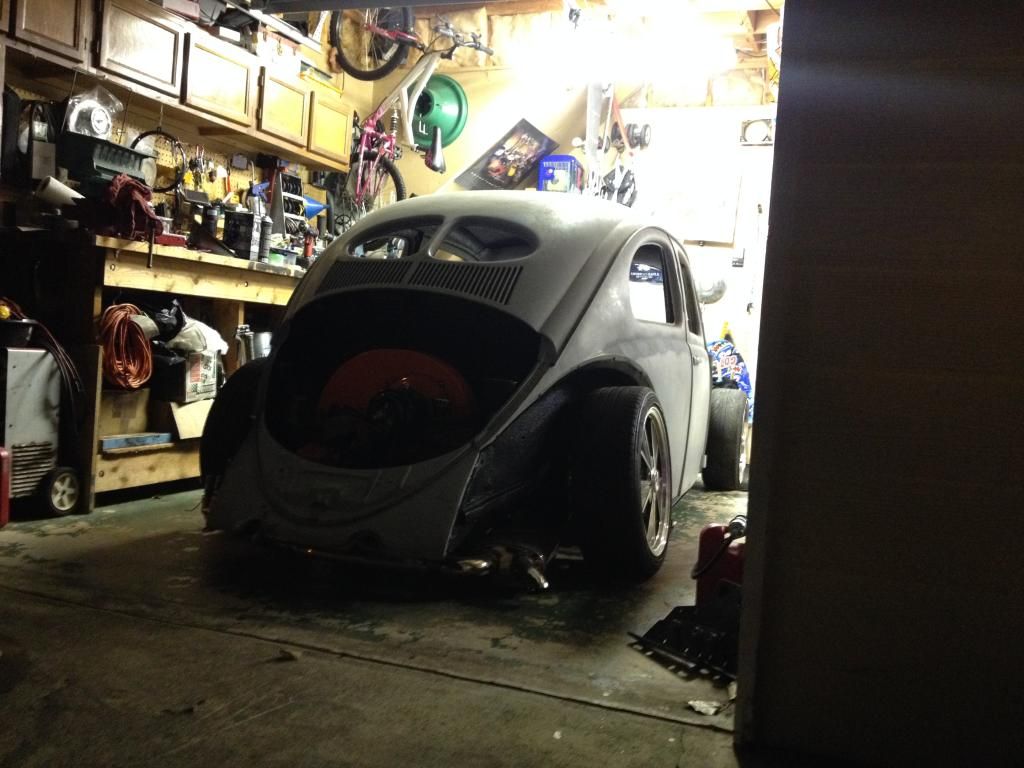

Post by Raggtop on Sat Mar 14, 2015 11:01 am
Body was on and drove the split a few times to find any problems, and i found one major one.
bag mount design and pipe size not strong enough for my application. will be coming off and re engineering
rear set up..

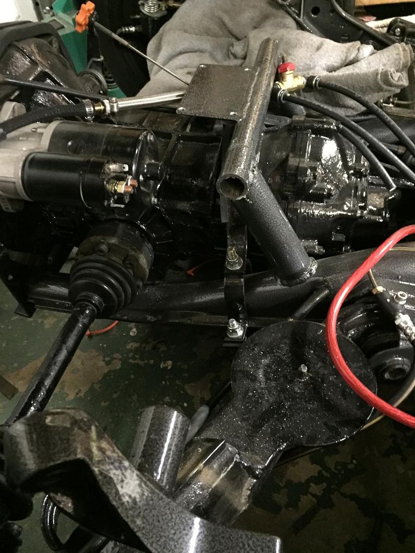

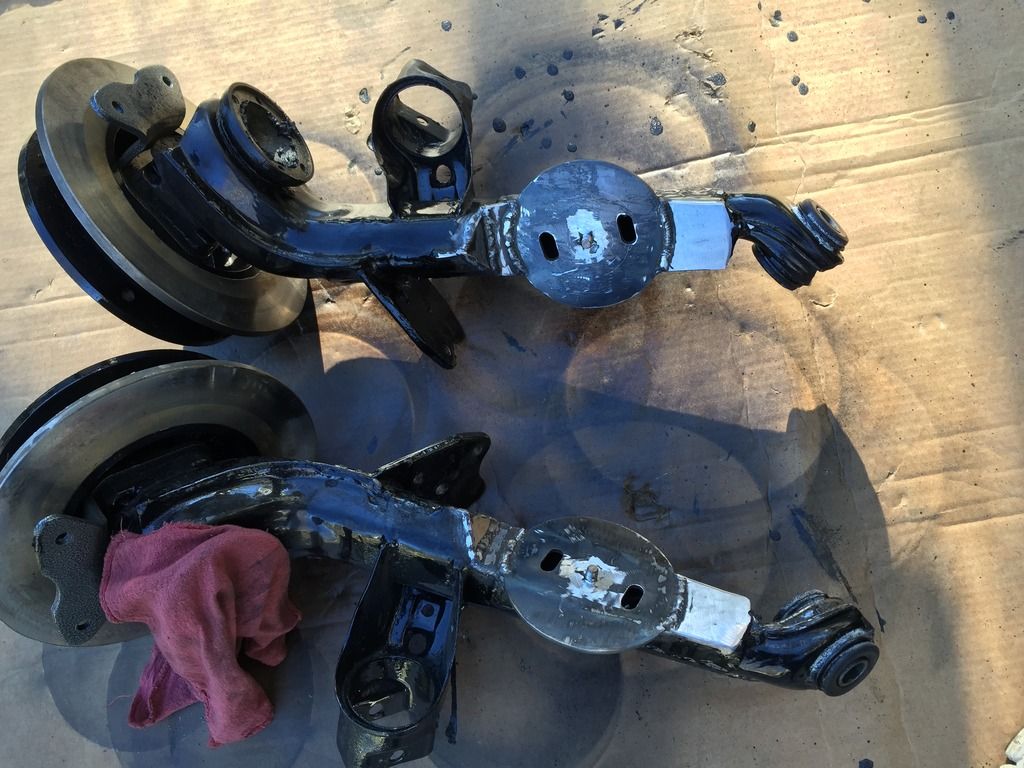

Post by Raggtop on Sat Mar 14, 2015 11:09 am
So started cutting out the old bar set up to get ready for new stuff.
Post by Raggtop on Sat Apr 11, 2015 9:36 am
Decided to move the lower bag mounts out towards the wheels about 2 inches, should help with lift issues and I'm sure it will create other ones. Both sides done time for paint and to start on the uppers situation

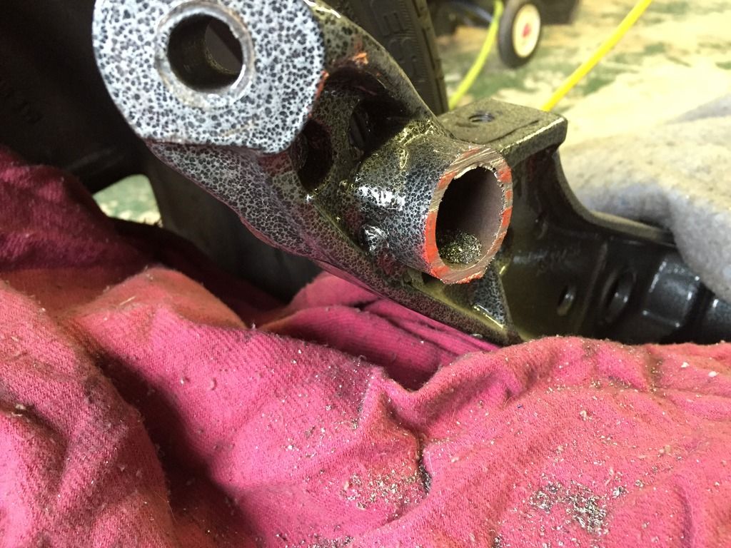

Post by Raggtop on Sat Apr 11, 2015 9:42 am
Cut old Cross bar out to get ready for new larger pipe
