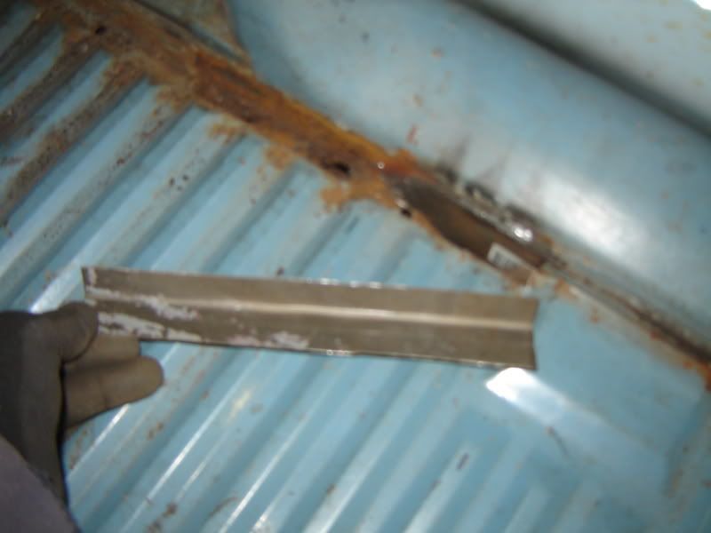

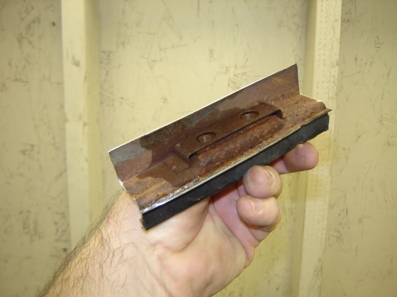

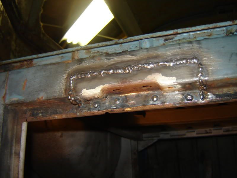

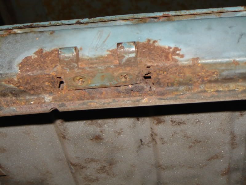

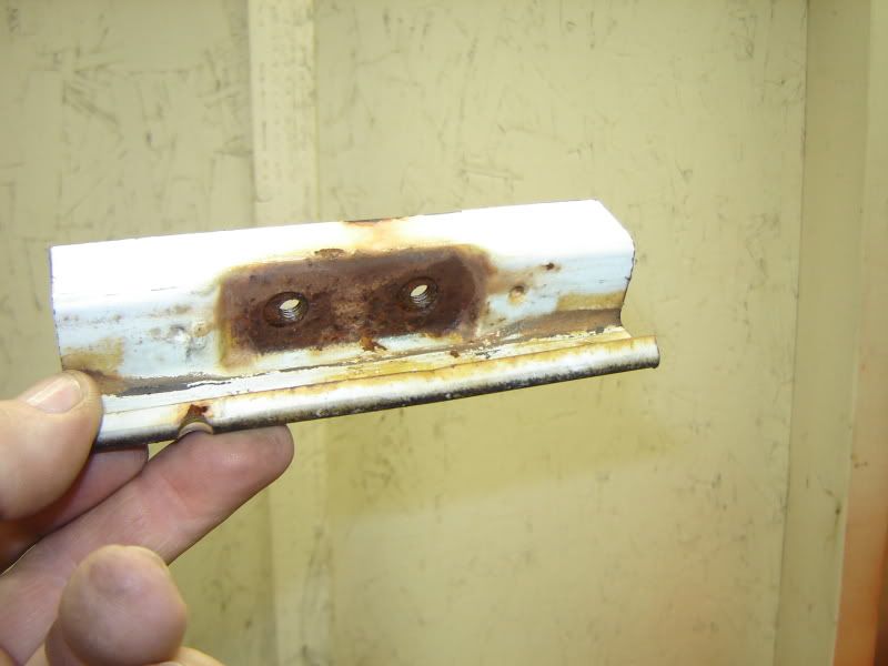

Work continued on the Bus today. I have some rust through on the Engine lid hinge drivers side.
I have a part from the Snake Bus, cut that piece off and here it is.
Little rusty on the back but it will work.
Cut out the old hinge.

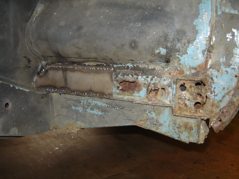

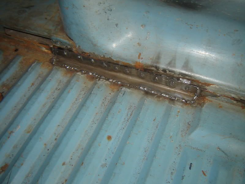

Made sure it lined up and that I measured correctly.
Off just a bit but not to worry.
Made some adjustments and welded it in...
Ground the welds..
And checked the fitment again....
Another problem solved and on to the dog leg issue tomorrow.

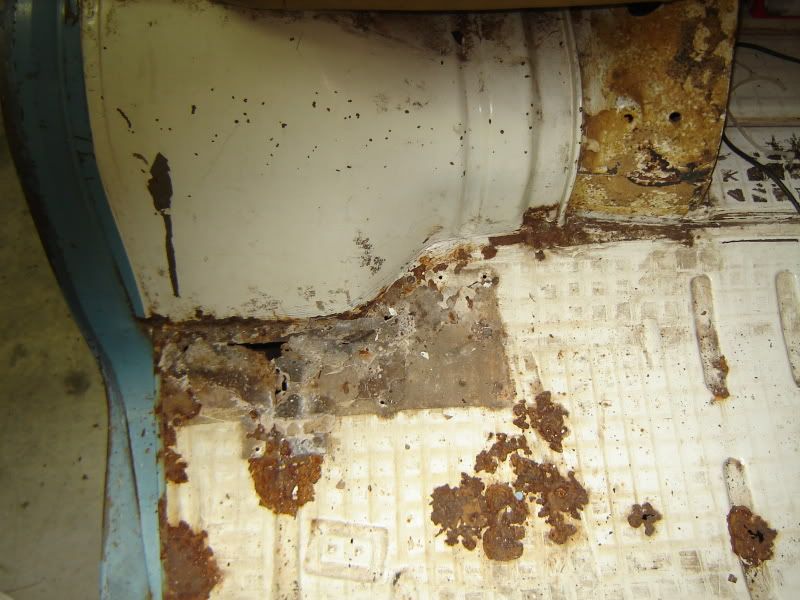

Post by rpm750 on Mon Jan 02, 2012 7:19 pm

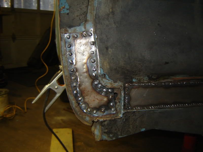

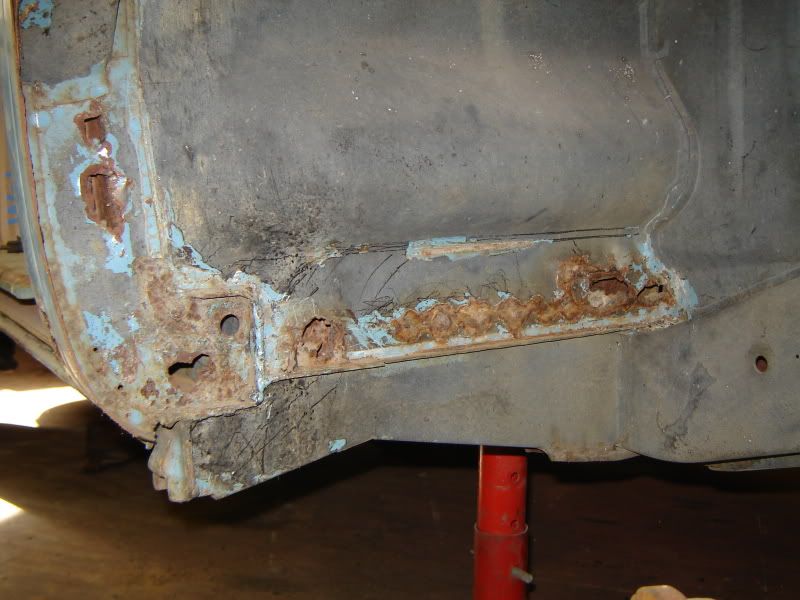

Working on the Bus again today lots of stuff repaired.

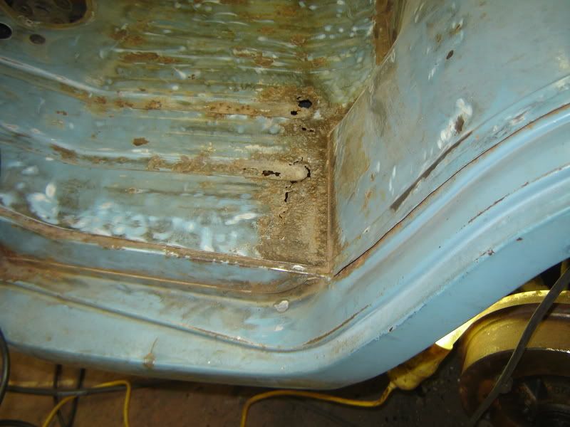

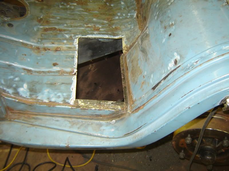

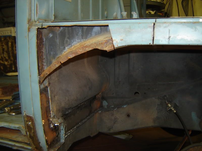

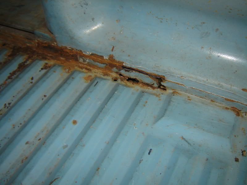

Started on this area. Was going to repair the cut out section on the dog leg but decided that access would be easier to do the back section first. Really hard to get my head with a welding helmet on it in there.
This is what I started with....
Then I got to digging......
and digging....
Well cut out a patch and tacked it in.....

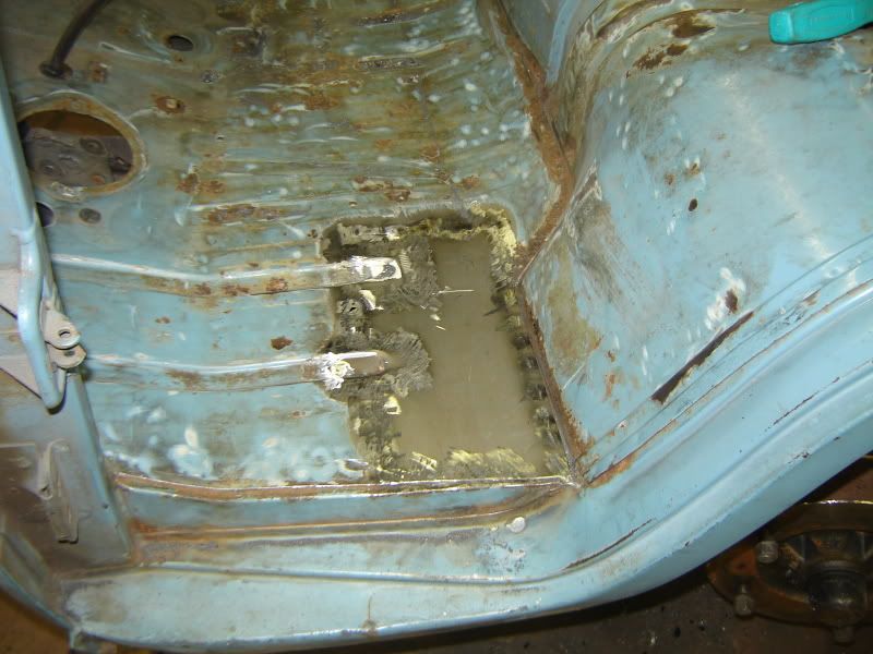

Then I had to fix the floor....
Cut a patch...
Welded it in....

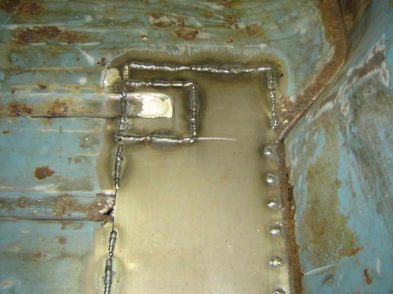

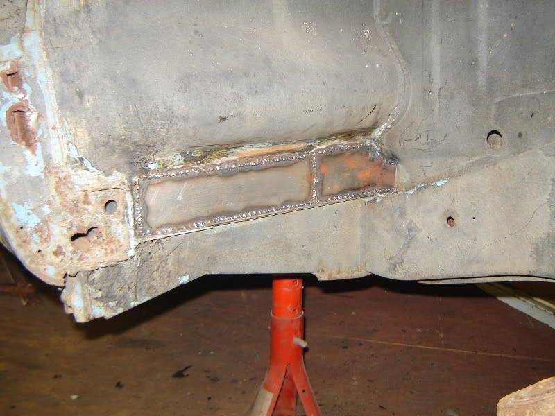

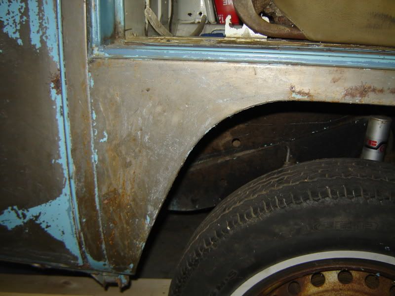

I fixed the other spot in the wheel well. Made a patch and welded it in. Ground it down after all welding was finished.

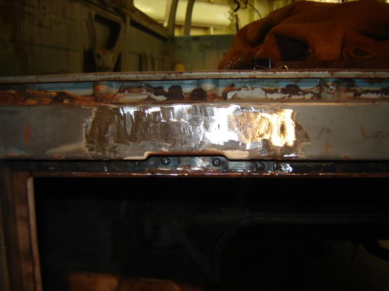

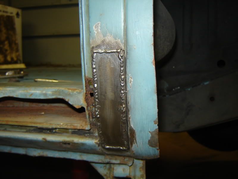

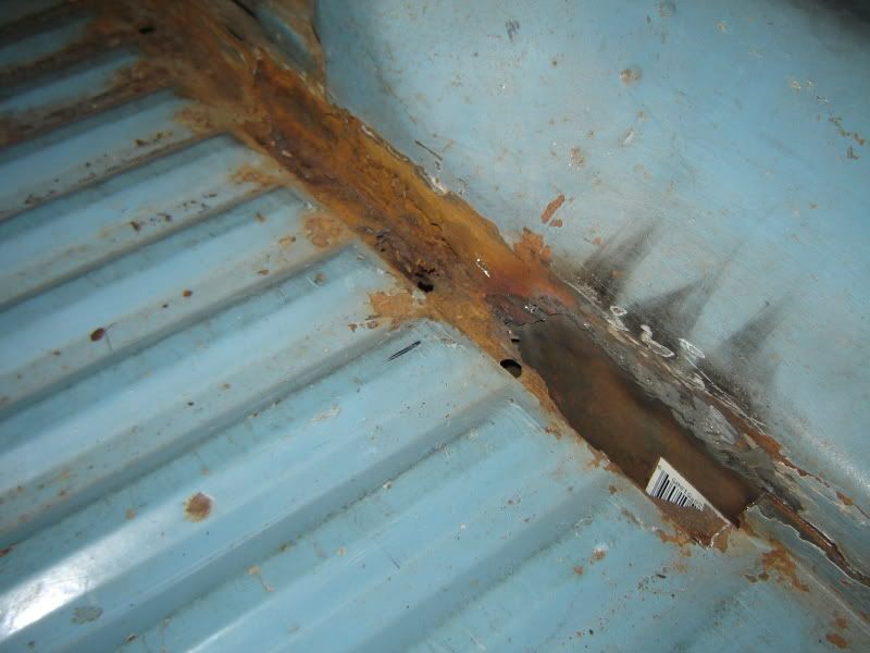

The next repair was the rust through in this area.....
Cut out the rust and made a patch, held it in place to check fitment.....
Then welded it in....
And ground everything down at the end of the day.

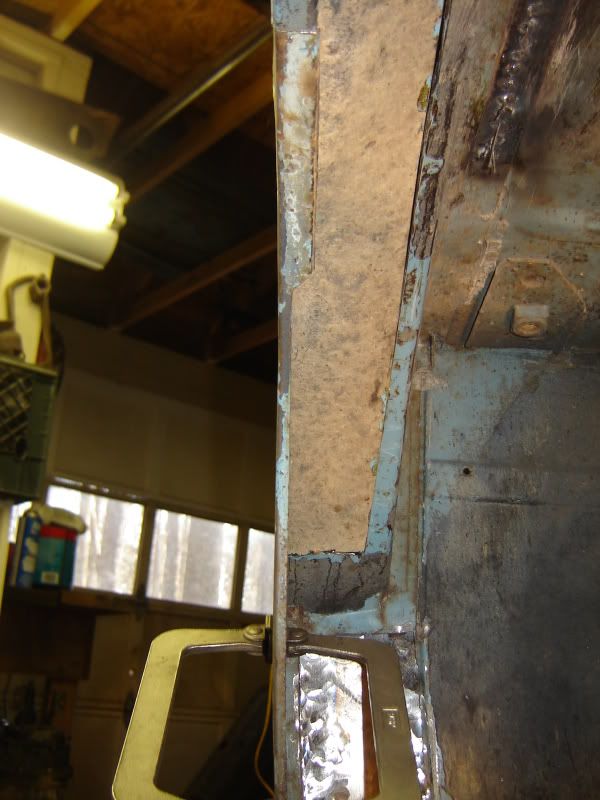

Post by rpm750 on Wed Jan 04, 2012 7:26 pm
Well final day of work on the Bus before I have to return to work.
I worked on these two areas today...

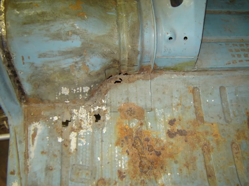

Passenger floor area.

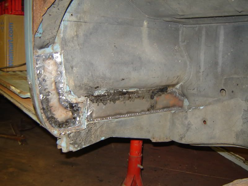

And the dreaded dog leg.

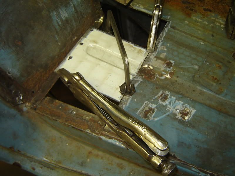

First I had to prepare some patch panels from my '71 parts Bus.
I tried to retain the factory ribs that are in the floor so I cut out different sections from the parts Bus so that I could rotate and fit it to make this patch. I had to cut up on the seat stand to remove a rusty area. I got part way through on the floor and decided to move onto the dog leg.

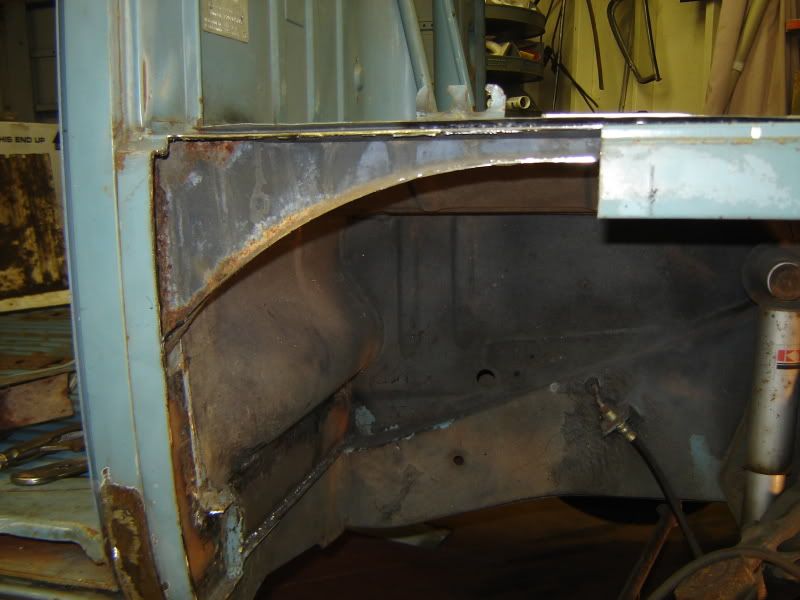

I cut out the old dog leg measuring like I did to make the patch.
Make sure you cut on different sides of the lines so that the curf, the slot the blade makes when cutting, will be minimal and the panels will butt up against one another. It is much easier to weld the panels together and the weld will be falter.
Here is my other concern the wheel well opening on the back.
I fit the patch in and just marked where the inner portion lined up with the portion still on the Bus, then just cut it out.
I refit it and double checked the fit several times clamping it to see if any of the seams needed tweaking. And of course there were several, so remove grind, refit, check, remove grind until it's perfect.
Fits great, now time to weld it in. I like to tack it in several places so it doesn't move. Always leave the clamps in place and try not to get the metal to hot.
I was a bit disappointed with the top but I can straighten it with a little filler later.
Even the wheel well area turned out great....
And then grinding, I hate grinding....
Glad this task is done.....

Started with the drivers side wheel well. Rusted just like the Passenger side. So the repair is similar so I skipped much of the details. Here are a few pics....
Drivers wheel well...
Removed most of the rust and made a patch....
Welded it all up and then ground all the welds....
One other area of work that was completed is the drivers floor....
Then I cut in the ribs...
Did one other rib but didn't get a pic. Here is the finished floor, welded and ground.....
