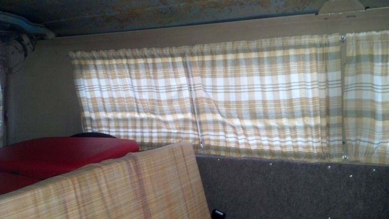

Ok had a connection with femmie side on Sat and sewed up some curtains for the Bus.
Plan on changing the cover on the seat and rear bed cushion.

Post by 720boy on Sun Mar 24, 2013 10:17 pm
looks good, what did you use for the rods

720boy wrote:looks good, what did you use for the rods
When we were down at Tampa(Bulli/Bug Jam) I found two sets of Westy Curtain rods. They need polishing so the curtains will slide easier. I love'em, setting up camp will be much easier.

Looks awesome!!!
