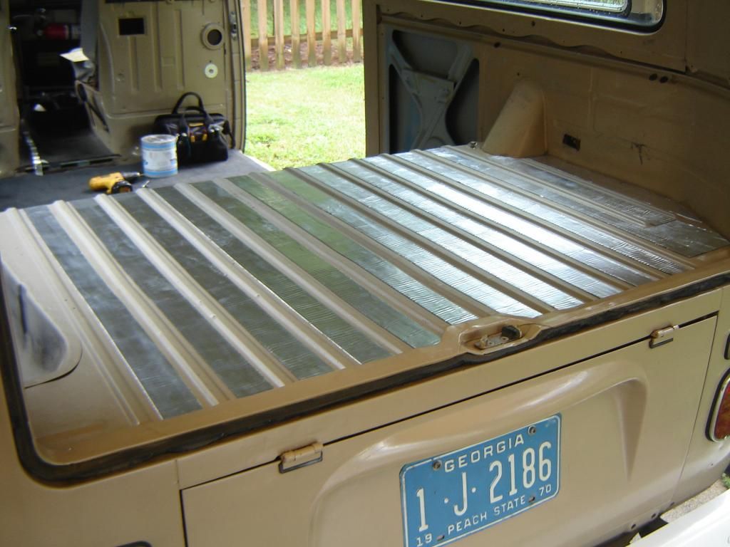

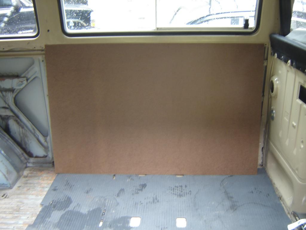

Post by rpm750 on Sun Oct 21, 2012 4:59 pm
Thanks guys, here are some of the things that I did that is under the carpeting.
Hardboard panels.
Make patterns then cut out the hardboard and cover. I pre-drilled the mounting holes and installed the panels with screws first, the carpet is thick when rolled over the edge so the panel is a bit smaller than the opening it will fit into.
Sound damping, (roofing/flashing) from Home improvement store.
I covered the fuel inlet tube first, the rest of the carpet overlapped this area. The line is to make sure to get the piece back into place after dry fit and trim. When you use contact cement it is just that "Contact" and it's there! You coat both halves and it will dry to the touch then it is ready to stick together!
I'm not using the gel version again the regular is just the same but less stringy!
