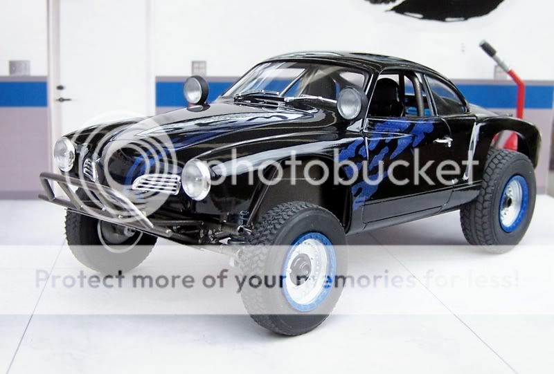

sorry, it just seems everyone on here slamms everything Laughing . raised ghia would be bad ass. Are you doing a baja ghia? if so here's some inspiration, lol:
Twisted Evil Twisted Evil Twisted Evil
Re: Ghia body on Thing Chassis
Post by laith on Tue Dec 06, 2011 11:39 am
That is awesome. Prob not a Baja Ghia per se, but may use some of those styling cues.
