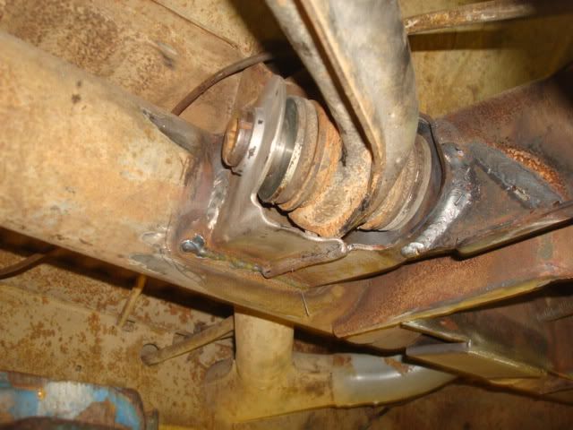

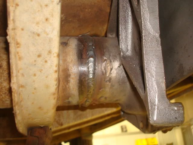

I finished the type 3 IRS install and narrowed my torsion housing. I re-welded the housing ends 10 degree's up so I have plenty of travel for the spring plates. I also notched the plates so I have unlimited travel in case I want to go extremely low. I also have raised the steering box 1 1/2 inch's. Almost ready for the blaster, then the body shop!

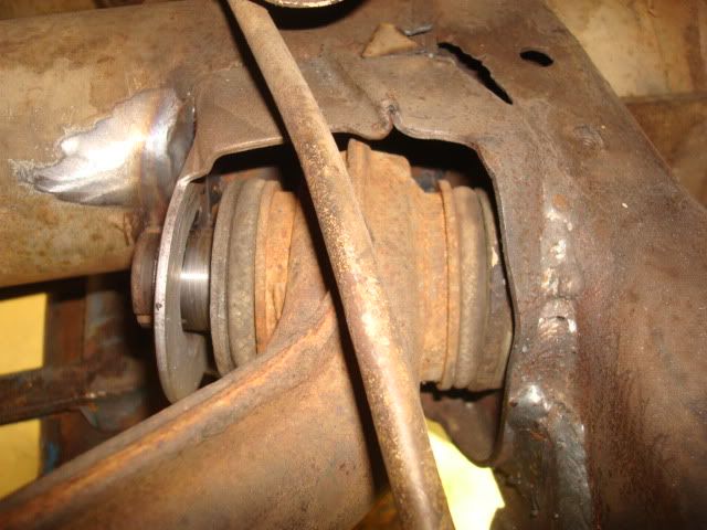

what mounts did you use for the rear control arms? i'm thinking about getting some of the bolt on ones so i can make adjustments while setting up the suspension then weld them in place

Thats the same way my torsion is narrowed. The only way to go if you want to stuff some big meats under there. I was running a 225 and could still get my hand between the tire and spring plate and between the tire and fender lip. Good stuff!! Cool

callahan wrote:what mounts did you use for the rear control arms? i'm thinking about getting some of the bolt on ones so i can make adjustments while setting up the suspension then weld them in place
I used the stock type 3 mounts that I cut off . I made a jig to keep them at the exact placement as they were on the type 3 housing. I had to modify the trans horns to set them inboard so I didn't have to narrow the trailing arms. I wanted everything to have the stock geometry. I figure the Germans knew more about what worked than me. It's alot of work doing it this way, but it turned out sweet.

I lost the original photo's, but here are some I took today. I used a type 3 rear IRS. I made a jig to hold the brackets in there original spot before I cut them off the type 3 torsion housing. I then ground them to fit the type 2 torsion housing and cut my trans mounts to accept them. This is kinda tedious, because you want to have them fit as good as possible so you don't have any gaps to fill with weld. I also angled them up more than stock, so I could go pretty low and the geometry would remain the same. After you do this, you need to cut and narrow the torsion housing so you don't have to run offset spring plates. When I did this, I rotated the ends up so I won't have to notch my spring plates as much. Then comes modifying the spring plates. You must cut the spline portion off and lengthen them the same as the amount you narrowed the torsion housing. It's a ton of work, but this is supposed to be the most correct way of doing it.

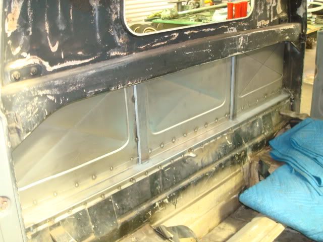

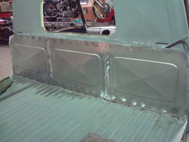

Making a little progress. Made my inboard rear shock brackets tonight. Mounted them inside the frame to make room for some meats!
Made a new rear panel. Not original, but much cheaper than Gerson.
