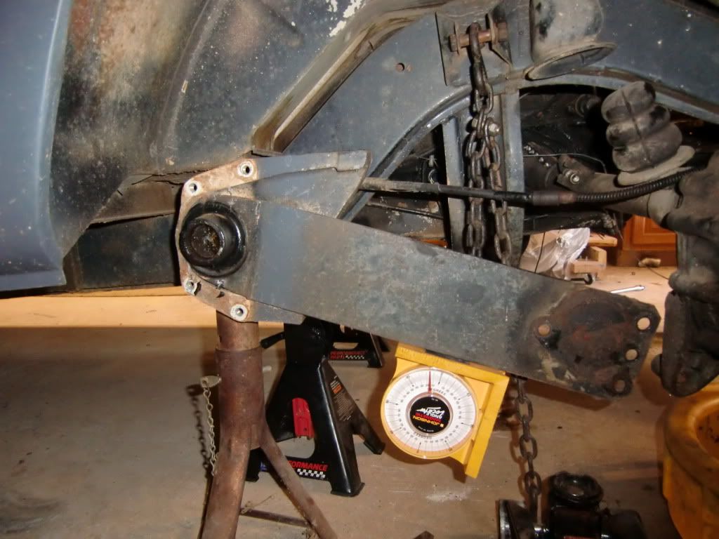

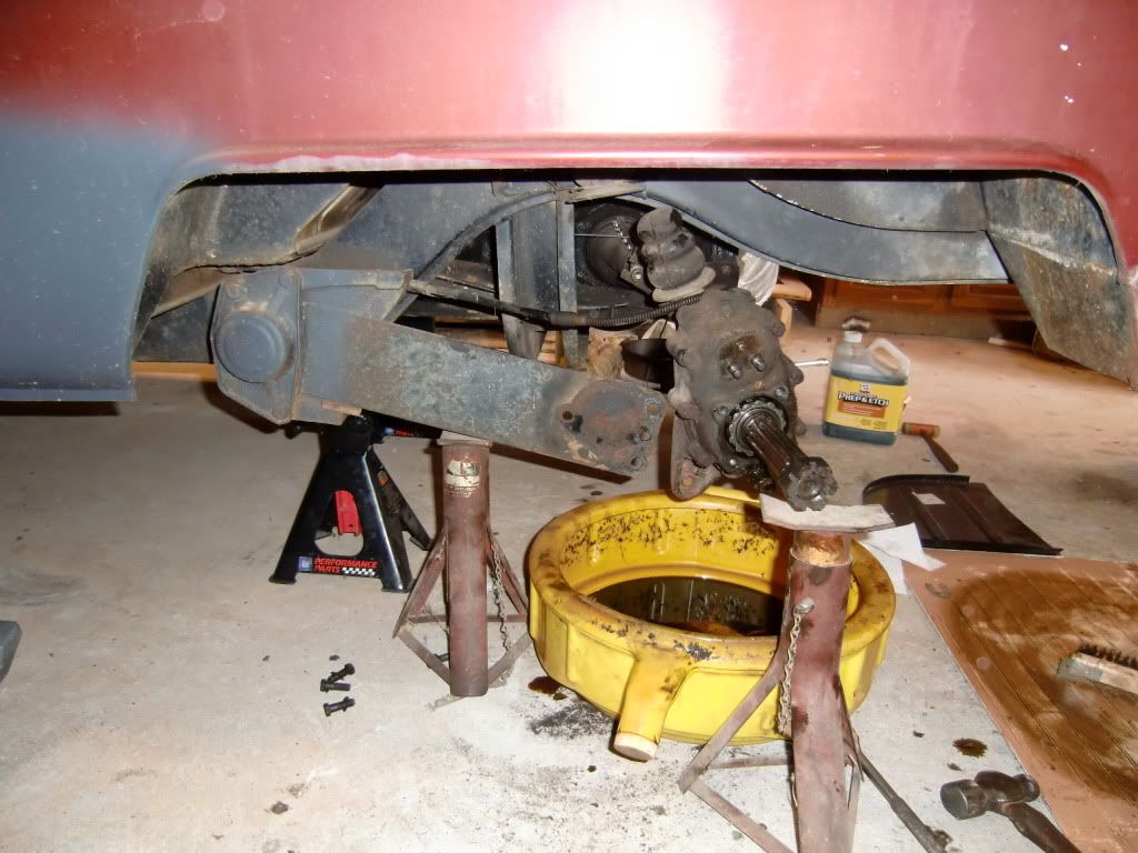

Spent a few hours on the rear today. Got the brake hardware all removed and pulled the backing plate and bearing housing. Removed the RGB from the spring plate and let the spring plate down.
Spring plate is at rest, so I checked my angle. One outer notch is equal to 7.5 degrees, so I pulled the springplate, installed new inner and outer bushings and rotated it up one spline. Checked the angle and everything checked out so I bolted it back down.

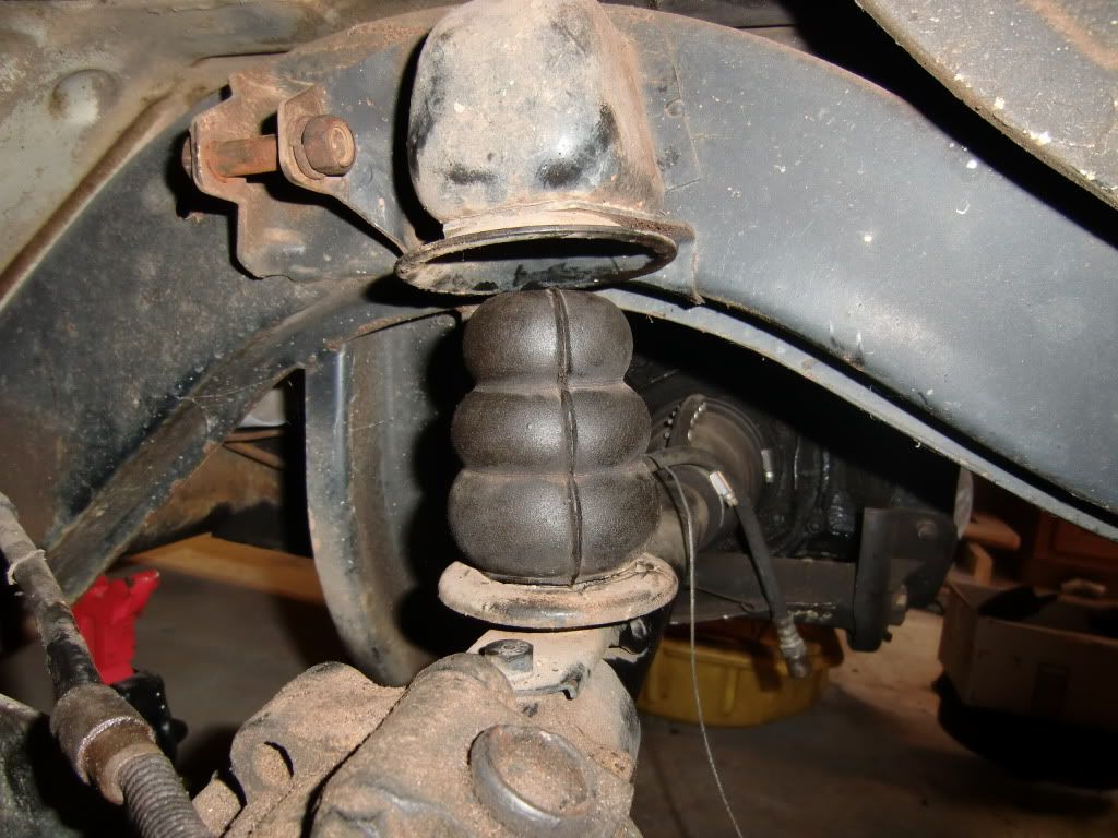

Here's where my bumpstop now rests and this is with the bus still on jackstands. Probably gonna be sitting on it when I get it back down on the ground. What do most people do here? I can remove it all the way or cut it down some.

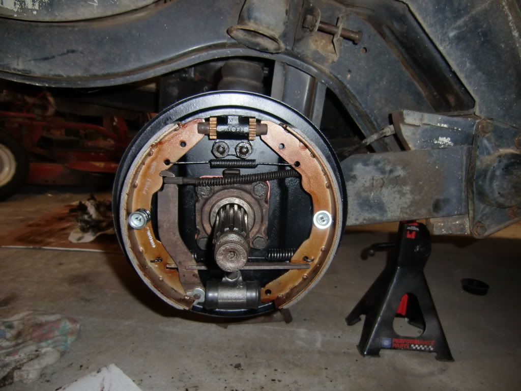

Brought my backing plates back home with me so I could clean them up and repaint them. Hope to get them back on and the new brakes installed in the next couple of days, and then set it back on the ground.

Post by bumblebuggy on Fri Dec 23, 2011 5:18 pm
Don't know if it's the right thing to do but I just cut the top bulb off my stop.

Cool, that's probably what I'll do also. If it still hits or gets mangled, I can always just pull it off later.

Post by bumblebuggy on Fri Dec 23, 2011 5:35 pm
Don't think hitting is going to be much of an issue. If I remember correctly, it's hollow and really doesn't have much "stopping" power after you cut it.

Post by fluxcap on Fri Dec 23, 2011 5:40 pm
Yeah, I cut some off the ones on the bug after I lowered it. Was working under there a while back and noticed I must have hit the one on the passenger side. It had split like a peeled banana Laughing

Shouldn't be much longer. Had a couple of free hours today so installed the new axle seals and got the brakes installed on the drivers rear side. Also re-indexed the spring plate on the passenger side. Just need to do the axle seals and install the brakes on that side and I'll be ready to set it back on the ground. I'm anxious to see how it sits. It was a super tight fit getting the driver side wheel back on squeezing it between the drum and wheel-well. Should hopefully get it finished up Wednesday.

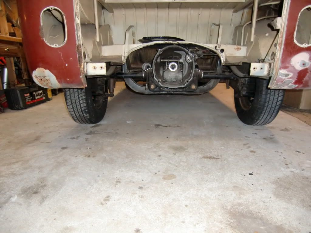

Rear brakes and axle seals are all done!
Got the drum back on and put it down on the ground. Not low or slammed by any means, just a mild drop. One outer spline, which is supposed to be 7.5 degrees on the springplate and roughly 2 inches. Has a slight rake, but I'm hoping the rear will settle just a tad more when the engine goes in. My workspace is very long, but not incredibly wide, so it's hard to get a good side shot to really see how it looks.
Axles are pretty much level coming out of the transaxle.
