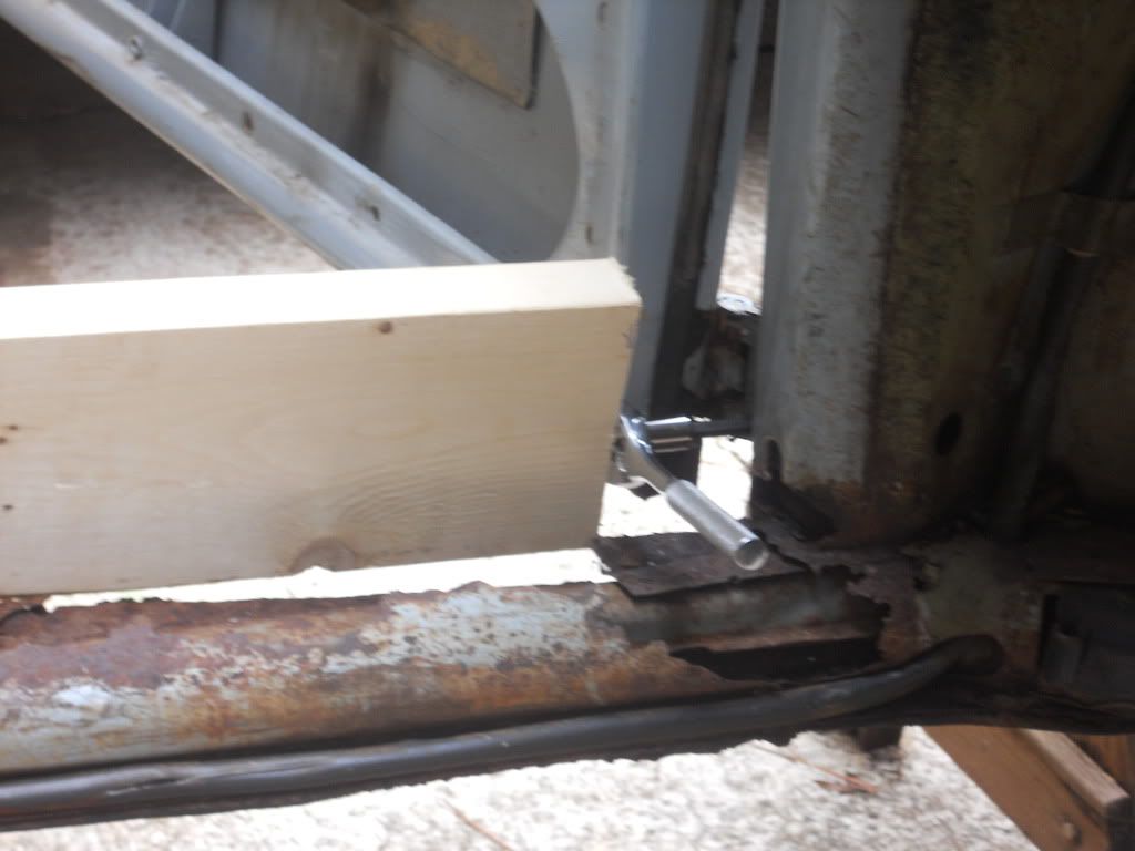

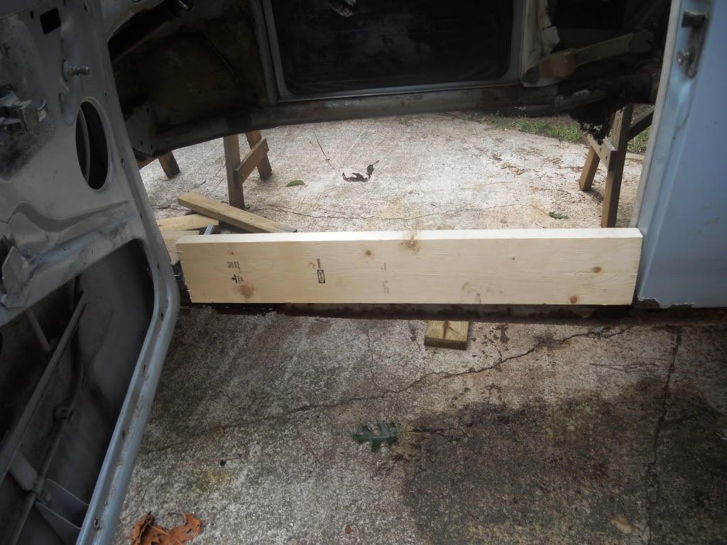

So, I was having trouble taking the doors off. I just couldn't get enough leverage to hold that #4 Phillips head into the bolt. So I took a chunk of 2x6 that I had laying around and cut it exactly the length from the top of the ratchet to the opposite side of the door. I worked perfectly to break the bolt loose.

Post by Grifspop on Sat Aug 06, 2011 10:39 pm
It's all about the leverage!
