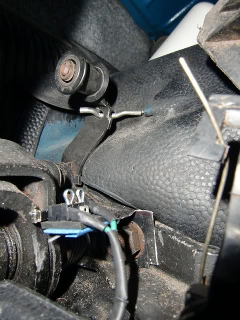

Post by fluxcap on Tue Jan 25, 2011 8:02 pm
Well, last Friday I went ahead and mounted a micro switch to the pedal cluster. It's out of view and my brake lights now come on instantly. I made a small bracket for the switch that is held in place by the rear pedal cluster bolt. It works great and I'm really just glad to have brake lights, even if not the solution I was wanting. I also still have one of the pressure switches wired up as well, so if the micro switch dies, I'll still have my delayed brake lights.

Post by Bugman114 on Thu Jan 27, 2011 9:23 pm
post some pics of your bracket, and set-up. I really want to do this as well.

Post by fluxcap on Fri Jan 28, 2011 5:32 pm
Bugman114 wrote:post some pics of your bracket, and set-up. I really want to do this as well.
Here's the crude set-up. It's nothing more than a piece of sheet metal bent into an L. The end of the L that attaches to the pedal cluster bolt has a slot cut in it so it slides behind the cluster bolt and is held tight when you tighten the cluster bolt. The switch then just sits on top of the other end. I put a thin piece of rubber between the switch and bracket to keep the unused terminal from shorting out. The other terminals are soldered and then covered in shrink tubing. I wired the switch to function as "normally closed". The pedal (when not pushed) is keeping pressure on the switch and keeping the circuit open. As soon as you push the brake pedal, the switch is released and the circuit closes, letting the juice flow.
The switch has two very small holes in it, and I had no bolts/nuts that small, so I found a couple of cotter pins that fit perfectly. Drilled corresponding holes in the bracket and connected it all together with the pins. No slop at all, the switch/bracket are very firm. The bracket is black and I needed to draw some lines on it to know where to cut it, so I put blue painters tape on, so I could see my lines. I never took the blue tape back off (yes, I AM that damn lazy) so that's the blue you see in the pics. The switch is hidden behind the gas pedal so I'm not worried about its ugliness!Laughing
Only thing to make sure of, is that your bracket is small enough and placed so that it doesn't get bumped by the gas pedal.
