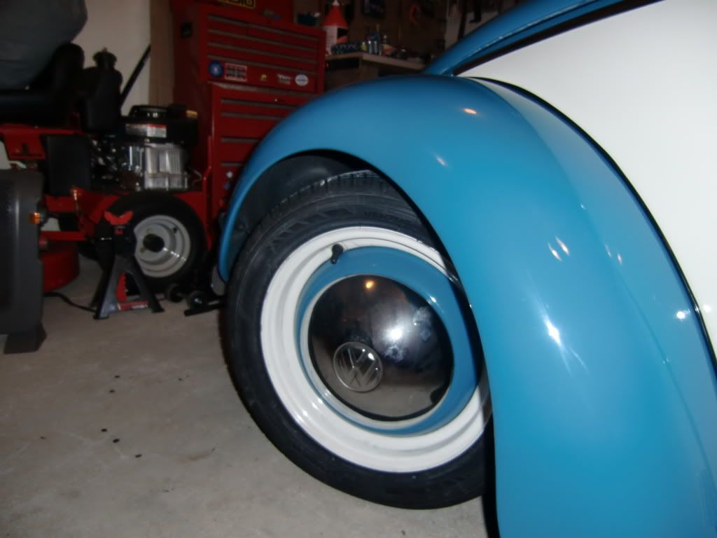

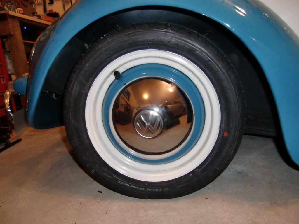

I put new front tires on Blurple today. I ended up going with the 175/55R15s - Continentals. I hovered over they guys while they were doing the work to make sure they did not mess anything up. When they checked the torque, they found that a couple of wheel nuts were spinning in place.I know they did not do it so it must have been done by what ever shop put the new rear tires on the car when Jason Brooks owned it. When I got the car home, I found two broken wheel studs. One was broken off inside the nut and the other broken piece was missing. I had to run over to Pro-Flow really quick to get some replacement wheel studs. I also adjusted the front beam up about 1/2 and inch to get better clearance on the new tires. The replacement alarm siren was also installed today.
