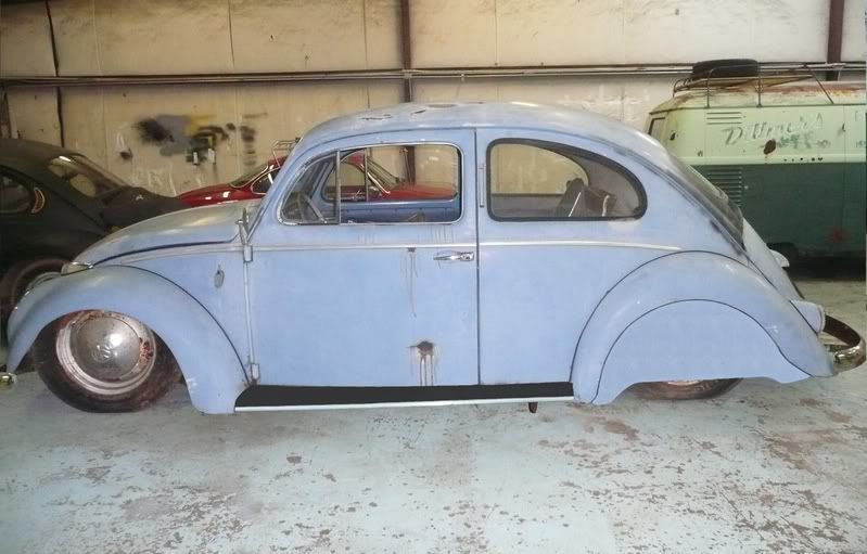

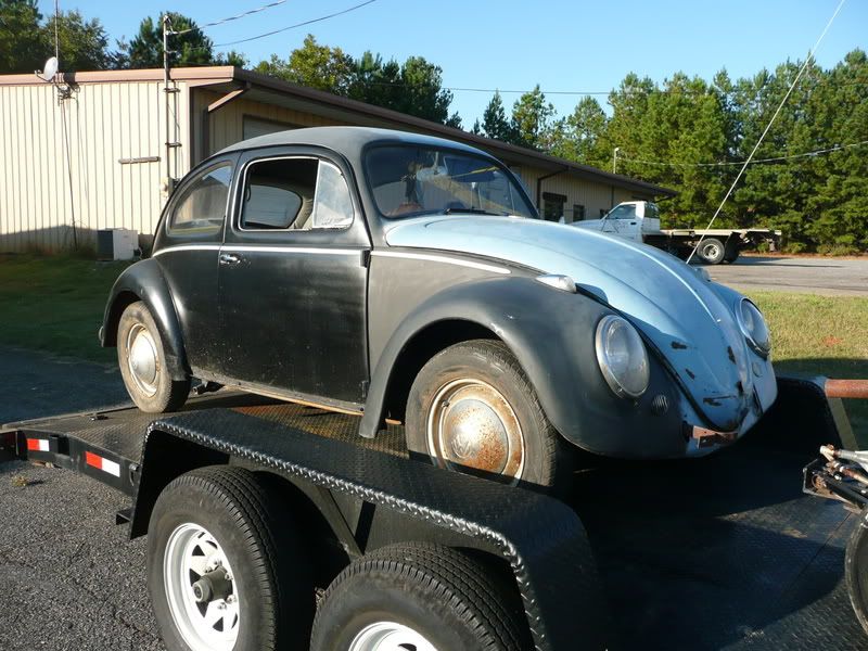

I certainly will be busy as there is quite a bit to do, although the plan is to get it road-worthy and then worry about cosmetics. Here is the 58... or is it a 59 euro I just got my hands on - I'm not entirely sure on the model year yet (see here for the samba investigation: http://www.thesamba.com/vw/forum/viewtopic.php?t=325074). There is some cool stuff, some right stuff and some wrong stuff on this car, but all in all I think I did ok and I can't wait to get stuck in. Let the games begin Very Happy

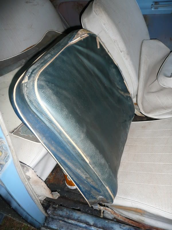

What I found under the seat cover:

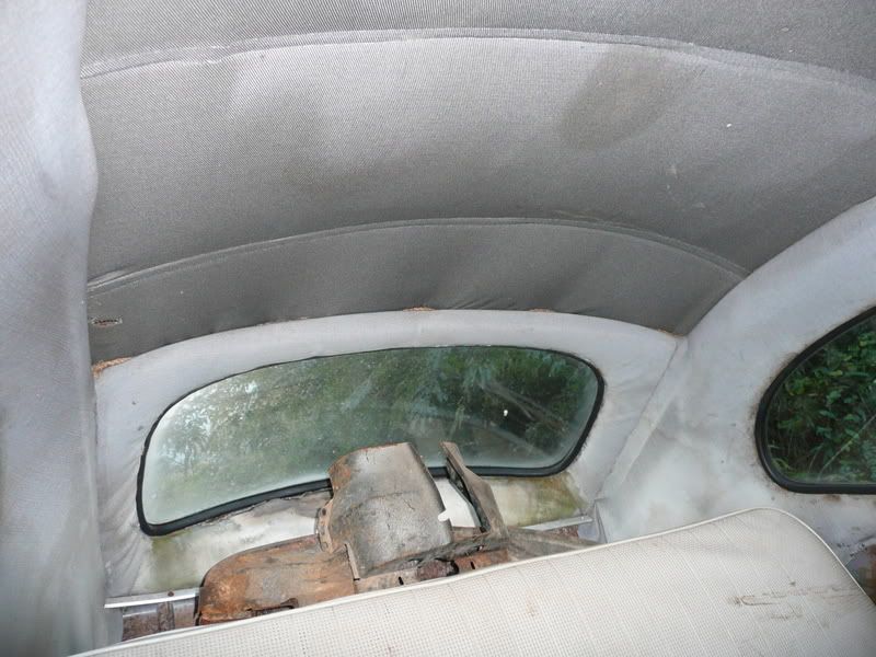

Anyone know if the headliner should look like this:

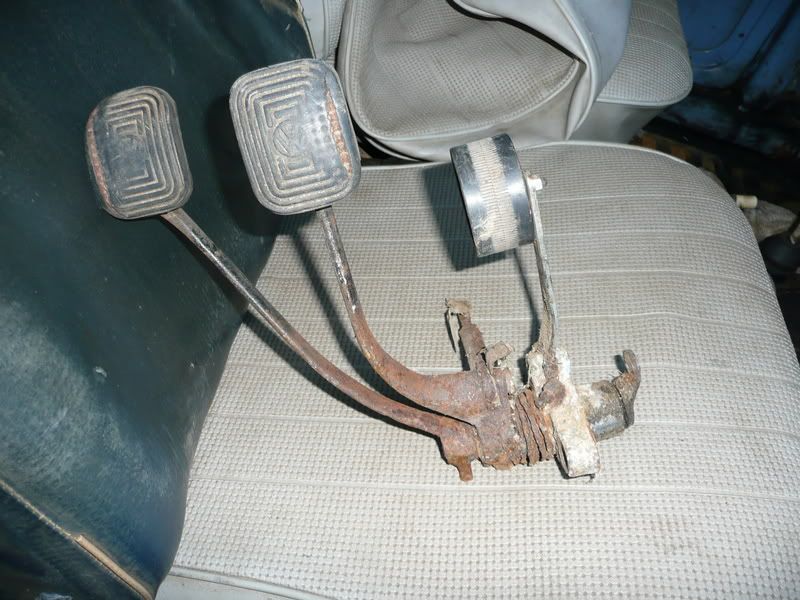

This needs some work:

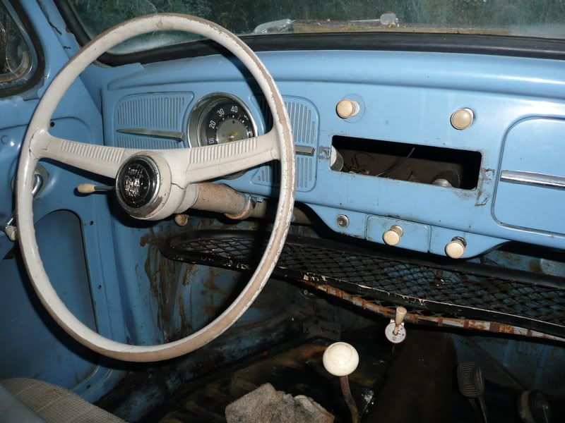

Mmmmmm:
Sweet:
More sweetness:

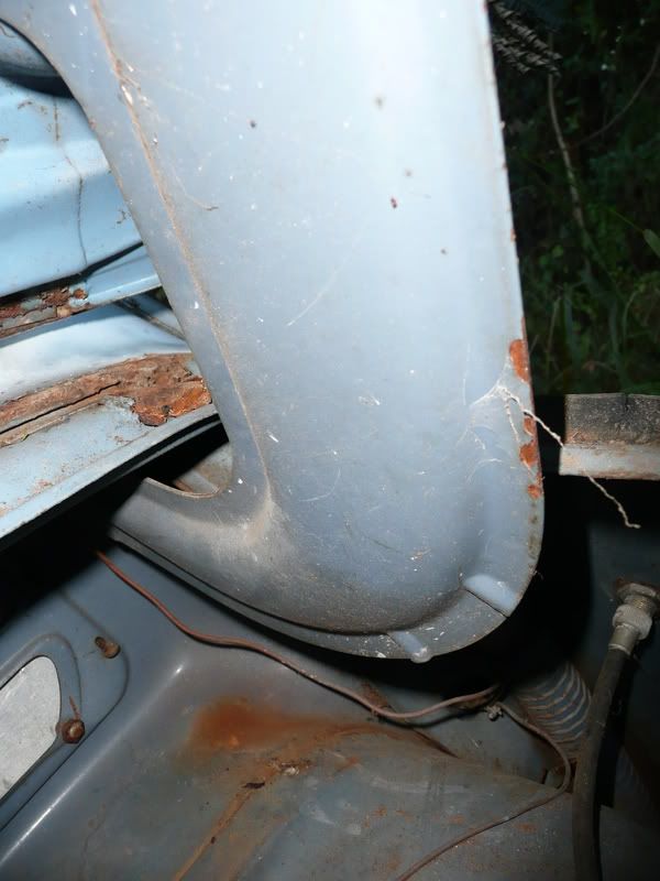

So this'll be the original colour then, any offers on what it might be?:

I love it! What all is needed to get it road worthy? That info on the year is crazy. The page from progressive refinements really throws everything off Laughing Can't wait to see it in person so hurry up and get in moving!
Is the center piece of the headliner a different color? Looks grey while the sides look white? If so, I would say the side pieces could be original but the center piece looks to have been replaced.

Post by 69panel on Thu Oct 23, 2008 7:38 am
Great find...I love those semaphores. cheers
I believe it is "L 434 fjord blue"
http://www.thesamba.com/vw/forum/album_page.php?pic_id=324737
http://www.thesamba.com/vw/forum/album_page.php?pic_id=304611
Or:
L 335 capri
http://www.thesamba.com/vw/forum/album_page.php?pic_id=324278
Now I'm leaning toward the latter the L 335 Capri

I dont think the headliners correct - think it should be mohair- good discussion here

Ooh, engine (which I need to collect, think it's good but I need to go through it), brakes, wheel bearings, shocks, tires, wiring needs looking at... the lot really Rolling Eyes Yeah it is nuts, maybe I shouldn't of opened the can of worms and settled for 58... or 59.... no 58... Laughing
Yes the sides are lighter than the middle piece, not so much white, but definitely a much lighter grey, and very dirty!
69panel - haha, yeah those are the two colours I was debating on, it is tough to call it between them. In your second pic, that door panel looks just like the one I have, same colour, I don't know if it is significant, but it would help if it that colour panel was only offered with that body colour, or one or the other years. Also, I read somewhere on the samba I think (of course I can't find it now) about a difference in the panel, specifically the white part - in the pic it looks like the same as mine in that it has a cross-hatch type texture to it, and some of them were smooth.

Yeah think you're right on the headliner, good info, thanks a lot.

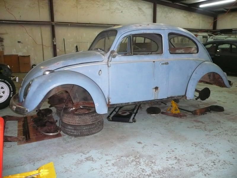

I have finally started work on the car, actually a couple of weeks ago, so only a month later than intended Laughing The plan is to have the car on the road as quick as possible, which means only doing what is necessary for it to go, stop and light up... oh, and there will be a "slight" altitude adjustment too Wink Here is a rough idea of what I would like the car to look like when it first takes to the road:
Here is where we are at currently:

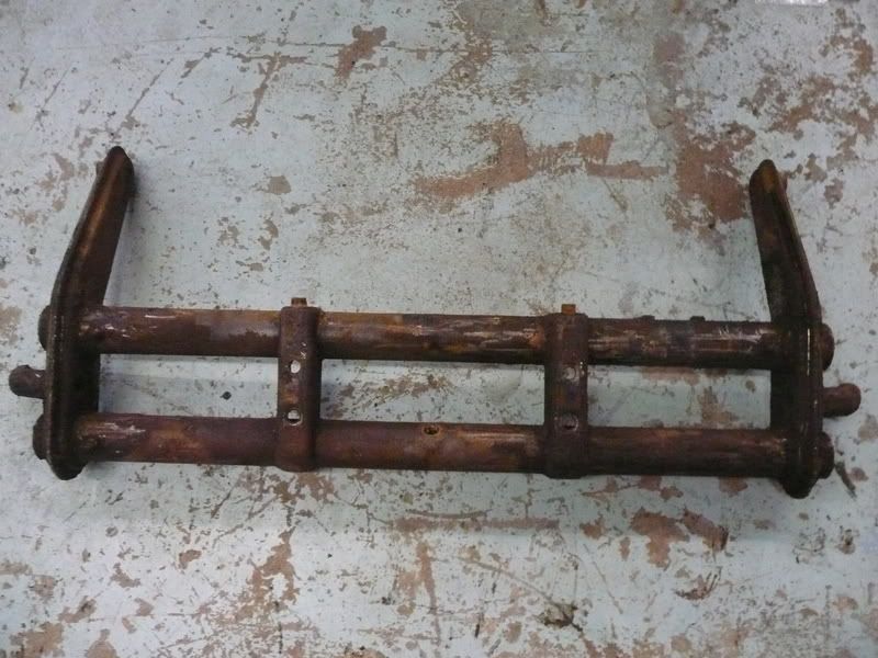

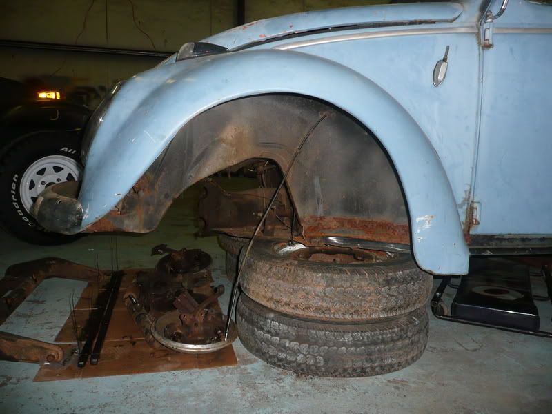

beam out:
and ready for some mods:

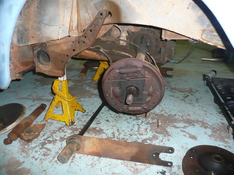

rear end coming apart(note the lack of brake shoe lining!!):

how do you plan on getting that low shorten the pan head, trans lift, and notched plates ect or air ride?? skirts and camber dont work ive tried

Dropped spindles, narrowed adjustable beam, flipped tie-rods, 3 clicks out back, notched spring plates with extensions.

Post by fearthefat138 on Wed Mar 04, 2009 10:27 am
DiscoSquirrel wrote:Dropped spindles, narrowed adjustable beam, flipped tie-rods, 3 clicks out back, notched spring plates with extensions.
good luck 3 splines is a time bomb Laughing but its fun while it lasts im going to do a trans lift on my next aircooled

fearthefat138 wrote:good luck 3 splines is a time bomb
Yep, but I'm not fussed, the spring plate extensions will help, and it isn't going to be a daily.
I just want sparks baby Cool .
