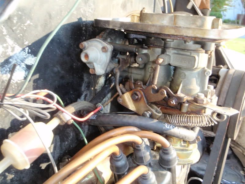

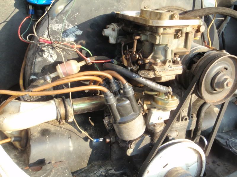

Post by 39coupe on Sun Oct 24, 2010 8:50 pm
Ok, removed my last comment. Here is the pic of the carb

Post by Grifspop on Mon Oct 25, 2010 8:42 pm
Looks like an old Weber progressive
http://www.thesamba.com/vw/classifieds/detail.php?id=1040205
Re: Help IDing a 2 barrel carb on a bugpack intake.
Post by vwtattooed on Mon Oct 25, 2010 11:05 pm
it's not likely a Weber with Motorcraft stamped on the side of it...looks like the 2 barrels Ford used on the 2.3 Pinto motors. you should be able to go to Napa and give em those #'s and they can get you a rebuild kit.these are similar to a Weber and a Weber rebuild kit may work.....???
Post by bumblebuggy on Tue Oct 26, 2010 9:01 am
In spite of the "Motorcraft" stamp it looks like a typical progressive setup. You probably need this kit...
http://www2.cip1.com/PhotoGallery.asp?ProductCode=ACC%2DC10%2D5535
I've heard they work great for a week or so after you spend two years dialing them in. I wasn't going to say anything about the filter until I noticed it looks like it's on backwards and therefore blowing filter peices into the fuel pump and possibly the carb. Before I rebuilt it, I'd take it apart and blow it clean to make sure no filter remnants are in there gumming stuff up.
Post by 39coupe on Tue Oct 26, 2010 3:17 pm
vwtattooed wrote:it's not likely a Weber with Motorcraft stamped on the side of it...looks like the 2 barrels Ford used on the 2.3 Pinto motors. you should be able to go to Napa and give em those #'s and they can get you a rebuild kit.these are similar to a Weber and a Weber rebuild kit may work.....???
Threw some research we found that you are exactly right. It is actually a Holey 5200 with a motorcraft stamping. It was used on the 2.3 pinto motors. I actually work for NAPA (in IT, not the store so I it took me awhile) and I found when looking up a carb kit for a '71 Pinto, in the description it actually lists out the R-6309 part number so I'm pretty sure we have the correct rebuild kit for it now.
Post by Bugman114 on Tue Oct 26, 2010 7:41 pm
39coupe wrote:
So either ford copied the weber carb, or weber copied the holley carb, as it looks exactly like a progressive carb. the linkage on the side, the boss that has that metal shaft, that that small vertical spring goes to to the linkage, the small triangular gussets from the barrel, to the bottom flanges. i bet the gasket set for both carbs are similar, if not identical.
even the funky looking gas line input casting on the right side.
Post by camch on Tue Oct 26, 2010 9:20 pm
both carbs the weber and ford take the same gasket set
Post by 39coupe on Wed Oct 27, 2010 8:41 am
bumblebuggy wrote: I wasn't going to say anything about the filter until I noticed it looks like it's on backwards and therefore blowing filter peices into the fuel pump and possibly the carb. Before I rebuilt it, I'd take it apart and blow it clean to make sure no filter remnants are in there gumming stuff up.
Thanks for the observation. Will definitely do that.
