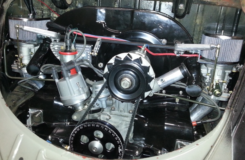

Post by Heinz57 on Sat May 03, 2014 10:16 am
Well here is a long over due update on Wilma. The 1955 cc engine was broken in over at Tim's shop, but ran into a little problem with the
Bug Pack Ceramic coated Street Max 1 5/8" header after the 2 minute mark. It discolored very badly and the actual coating was popping and shooting sparks as the ceramic coating was leaving the header? Wil was actually get small burns on his leg while holding the throttle open. Very strange? I bought the header from Aircooled.net and sent them pictures. They agreed that the coating was most like sprayed over a still oily header and not cleaned at all. They are working to get a replacement one hopefully this week. If I get a replacement one, I won't use it. I will spring for either a Vintage Speed in Stainless or go all out for the A-1 in Stainless.
I also pulled the old main wiring harness out last Sunday. Made a new one Monday night after picking up a 12' of 3/4" PVC sleeve from Mcmaster- Carr. Total time was about 2 hours to build, install, trim and test it. I also did find the correct wire ferrells that get crimped on the wire before you install them on the screw type switches and connections. These are used on the 1960 and earlier cars. I also added to the new harness a tach, oil press and oil temp wires and all the colors and tracers match the OEM VW colors except one. I also made a new tail light harness. The Oil pressure gauge and temp senders are connected at the remote filter and the stock warning light is still in its original place.
Completed and installed 1955: cc
New dash gauges and metal dash grill:
Remote oil filter and mount:
Discolored Bug Pack header:

Post by bakertim2 on Sun May 04, 2014 10:44 pm
Engine looks good sitting in there Danny.
Re: My 1959 Euro Bug
Post by Jon65 on Sun May 04, 2014 11:54 pm
Engine looks killer. Twisted Evil
Post by Raggtop on Tue May 06, 2014 6:03 pm
Thats crazy on what happened with the ceramic coating. hope you can get it fixed or replaced. Engine is looking sweet!
Number of posts : 422
Post by Gabass on Wed May 07, 2014 12:28 am
We installed J tubes on a motor and the black paint all came off. We just used high heat spray paint, works great.
