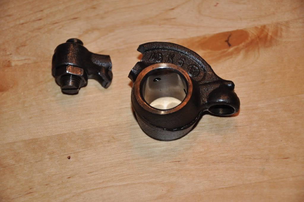

Post by peregrine67 on Wed May 26, 2010 10:55 pm
It's just a hunch but I think this might have something to do with my loss of power.
Re: '76 Westy
Post by peregrine67 on Wed May 26, 2010 11:02 pm
I'm p!$$ed at myself for not finding it earlier. I probably could have avoided pulling the motor. No worries. I've found a few other things I want to correct while it's out and having the motor out will allow me to better address my rust problem on the battery tray and pull the gas tank and clean it out.
