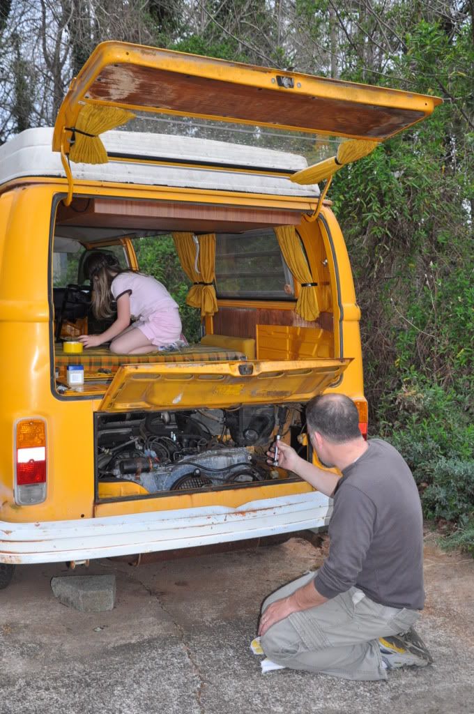

After a full day of working in the yard I decided I wasn't quite through punishing myself so I tried to crank up the '76 Westy after sitting for 12 years.
New plugs, new gas, new oil and new battery and she cranked right up in less than a minute. cheers

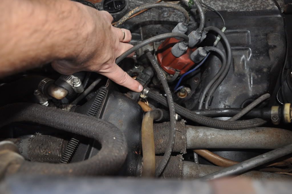

But not quite ready to take her for a spin around the block just yet. I have gas leak. I squirts like nobody's business from right here.
Suggestions? Is this the cold start valve? Yes, this is fuel injected.
Re: '76 Westy
Post by 71_georgia_beetle on Sun Mar 28, 2010 9:24 pm
Is that new fuel lines? If not, I'd definitely replace. If it's a crack in the nipple then JB Weld. You could also cut back on the tubing about an inch and see if the new connection leaks.
Re: '76 Westy
Post by peregrine67 on Sun Mar 28, 2010 9:40 pm
I put new fuel lines on this afternoon. Once I replaced one it just moved the leak to the next one. So I eventually replaced everything in the engine compartment.
Now I have a problem with getting her to hold idle that I didn't have before I put on the new fuel lines. Don't know why that would have affected anything. I'll work on her again tomorrow after work if the weather holds out.
Re: '76 Westy
Post by ibjamn on Mon Mar 29, 2010 1:03 am
I don't have much knowledge around engine mechanics, but if you replaced the old leaky lines (that may have a constricted fuel flow) with new ones..... wouldn't that mean the fuel pressure/volume increased, thus throwing off fuel - air mixture? scratch
ibjamn
Number of posts : 134
Location : Snellville
Registration date : 2010-02-24
Re: '76 Westy
Post by DiggerD on Mon Mar 29, 2010 1:20 am
Just a thought, but maybe its possible that you knocked some crud free that is now clogging the fuel filter? If you haven't checked it already.
Re: '76 Westy
Post by peregrine67 on Mon Mar 29, 2010 10:05 pm
Actually I'd just knocked off a vacuum hose. Put it back on and now she's running just fine. Hopefully I'll be able to drive it on Thursday.

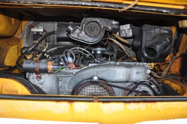

great that you got it running, cool pic of the motor too, that actually was/is a great idea to use on boards.

Post by peregrine67 on Sun Apr 04, 2010 11:15 am
My 7 year-old daughter enjoys tinkering on the bus with me.
