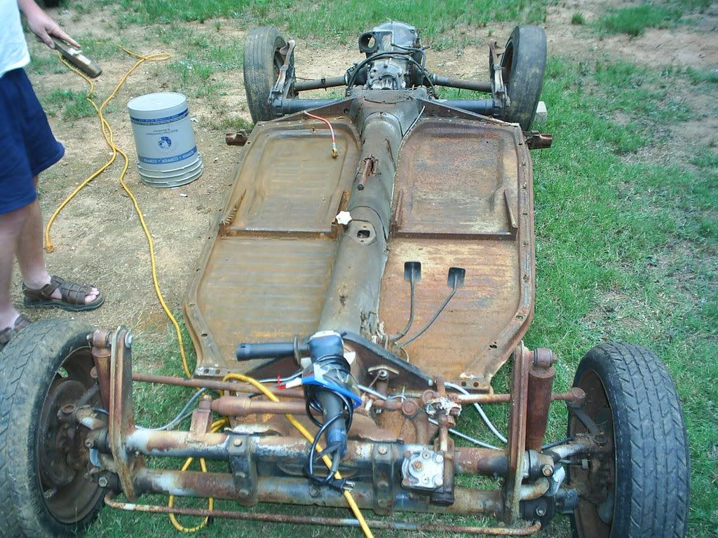

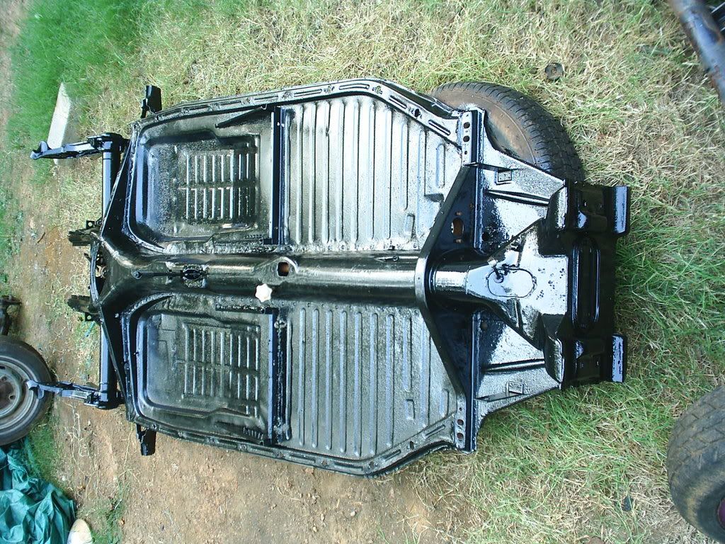

I have not used por15 but I have used rust bullet in black and grey. Very easy to use seems to do a decent job and I can get it right down the road at summit racing.
I will post pics in a few.

Post by Attorney Isaiah Loophole on Fri Sep 05, 2008 8:37 pm
Before
After
Black rust bullet rolled on. Left out in the weather for months held up pretty good. This was taken while it was still wet though.
