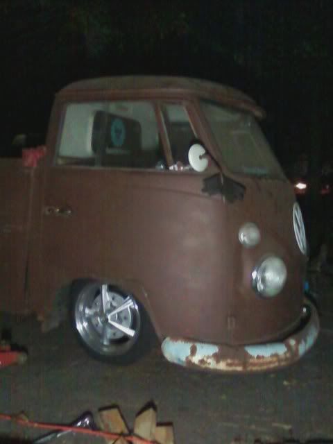

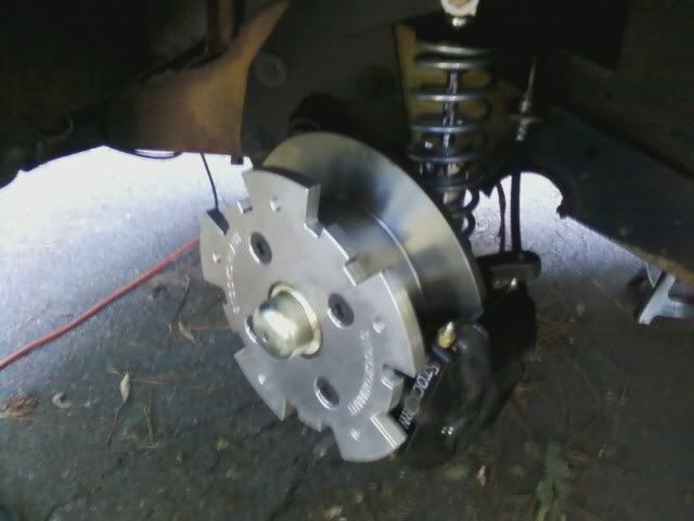

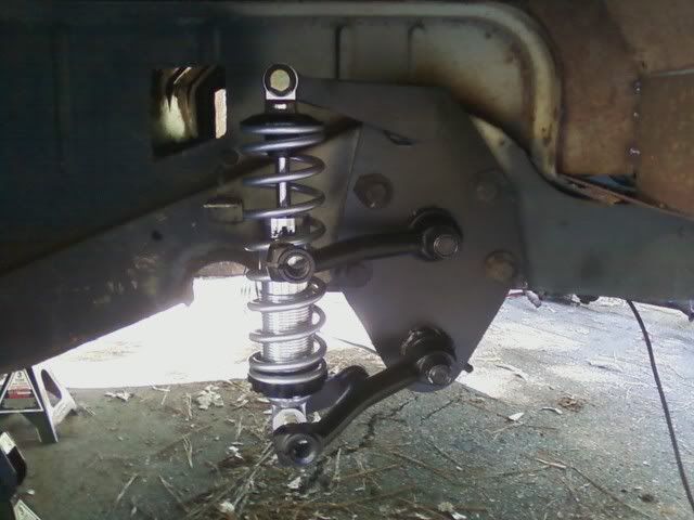

Finally pushed Frida out and did some work.....well I worked all day on it. First pulled the stock beam. Then I put in the narrowed coil over beam. Then I installed the coil overs and the disc brakes and finally the some wheels. Still have a lot of work left to do.

Johnny wrote:Hey Bryce,
What type of coil overs are those ?
And where are they from ?
Lookin' good by the way....
They are from summit racing. David got them for me.
Edit it is actually this one
http://www.summitracing.com/parts/HAL-ALN4855P/?rtype=10
With the back still at stock height the front bumper is like 3 inches off the ground...... Shocked pirat

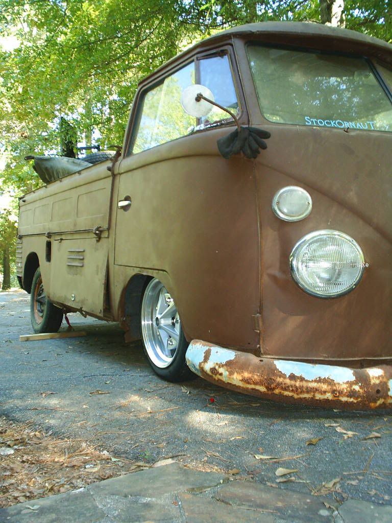

Post by Attorney Isaiah Loophole on Sat Oct 09, 2010 12:36 pm
Just a couple more pics

Post by Attorney Isaiah Loophole on Sat Oct 09, 2010 10:21 pm
Wheels are 15x5 Radars
Tires are 145/65/15
