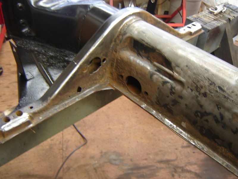

Well I've got to do something to the frame head, it is rusty. Moved it out and back in for the bonfire and a lot of rust had been loosened. I tapped on it to see how thick and it blew threw. So now I'm going to cut sections off the '68 and see if I can patch the frame head. I need the pan support for the front anyways.

Does anyone have a good used Link Frame head?
And where would I need to cut it?

I have a few we can cut one out. I told Bryce I would donate a motor for the club bug. Sounds like a road trip to me.

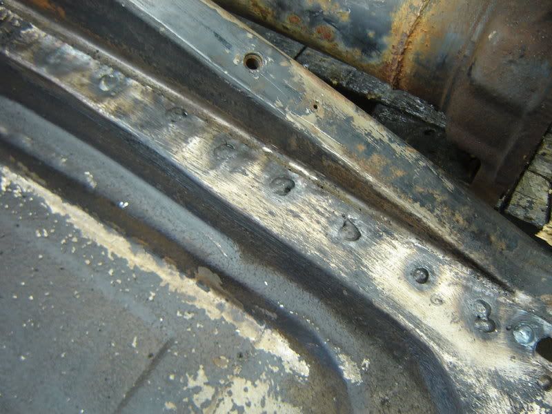

I went to Jeff's(56rag) last weekend and picked up a '59 Pan. I've been cleaning it this week,(removing old pans and removing surface rust).

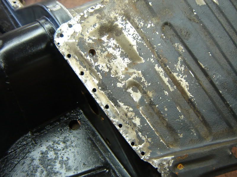

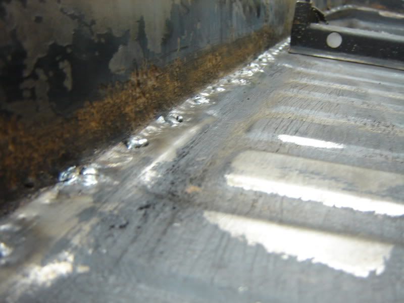

Today I started installing the pans that came with the '64. Here's what I started with....

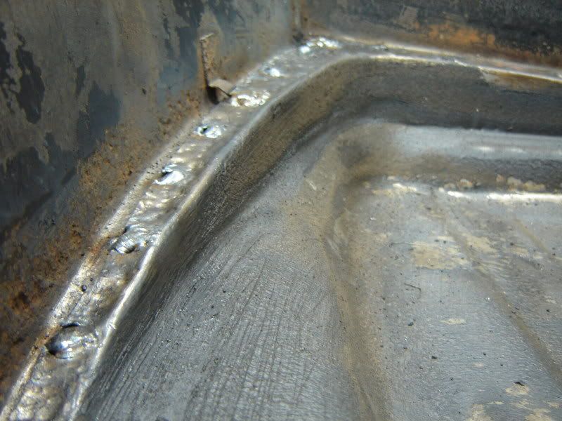

And here is one of the pans after I drilled the holes that I would later weld.

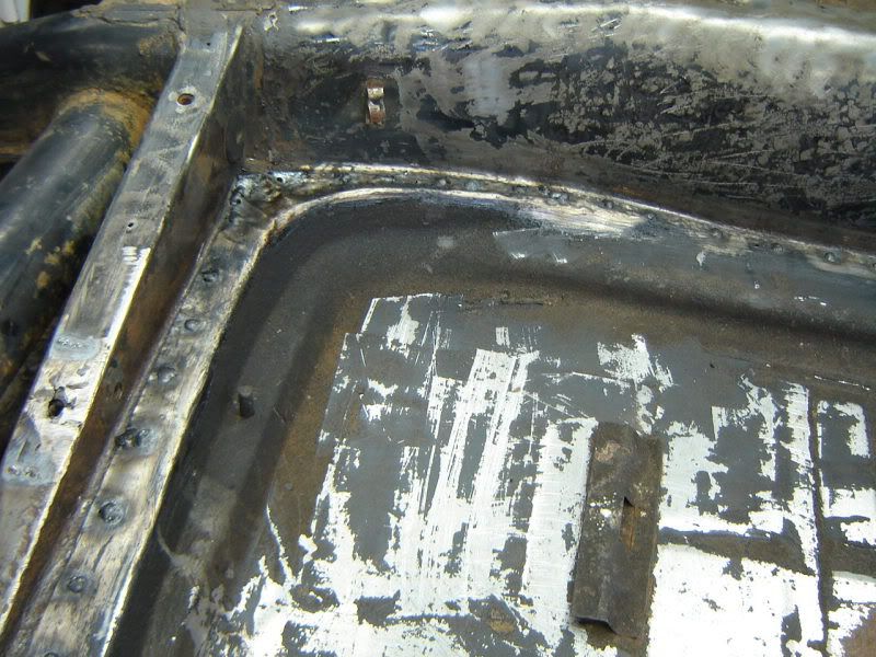

My welding....

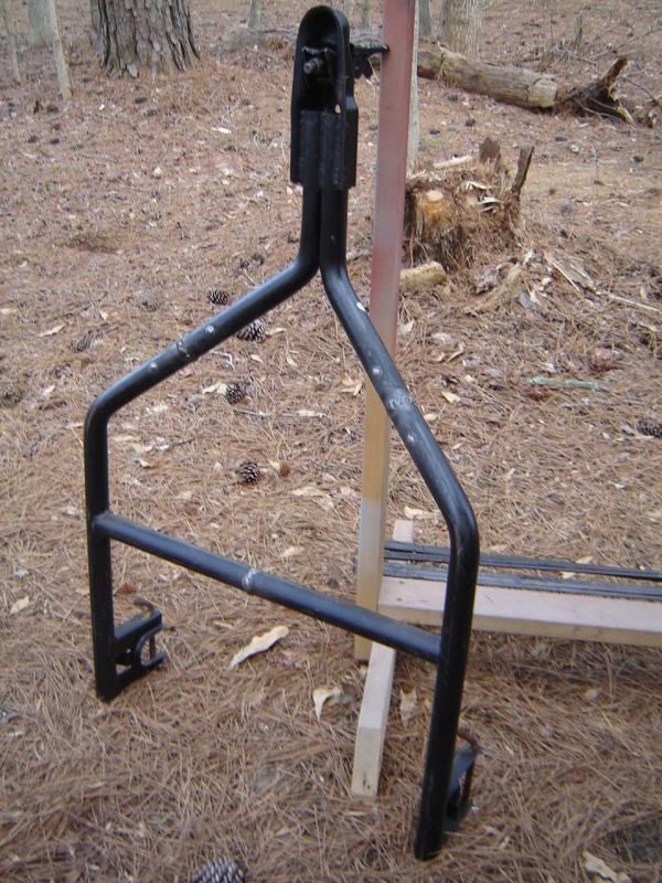

I was hoping to get one pan welded in and my Tow Bar cut and re-welded, I was a ble to do both pans and finish my Tow Bar!!!

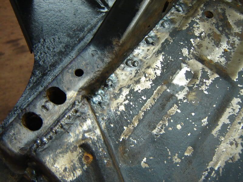

The other pan(passenger-side).....

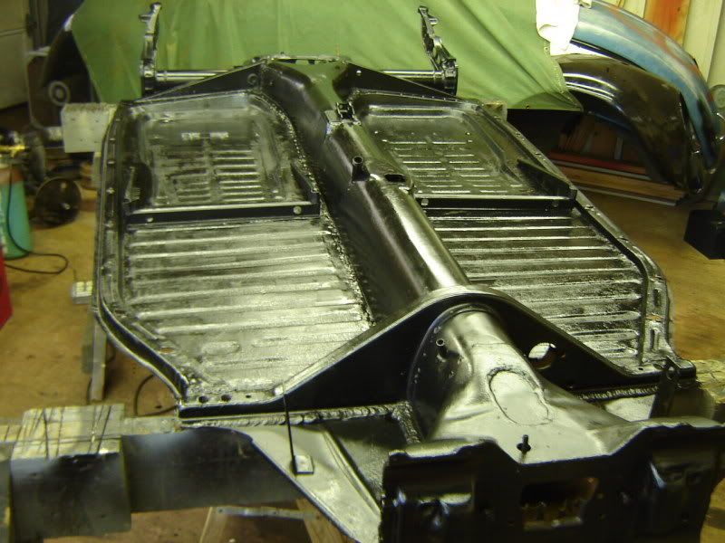

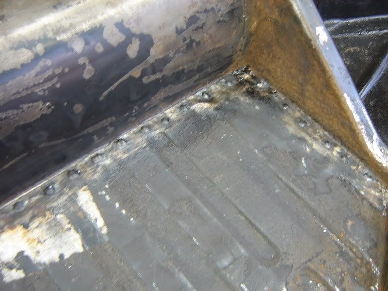

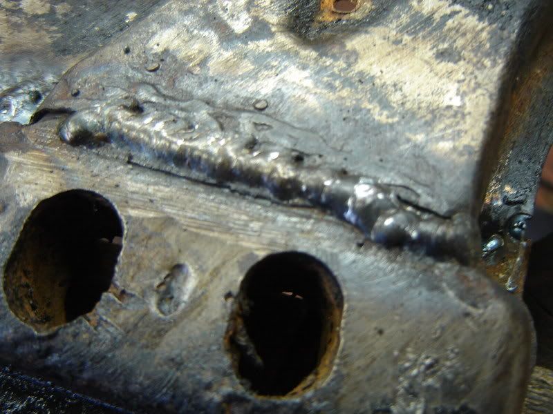

Here is the finished pan(welding at least) on it's side....
In that last picture I removed the front trans mount from the POS '68 I had and welded it on this pan. I had already ordered the newer mount so I added the bracket!

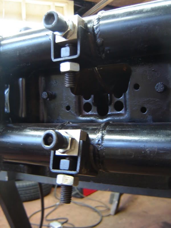

Also past few weeks I've been working on the beam......

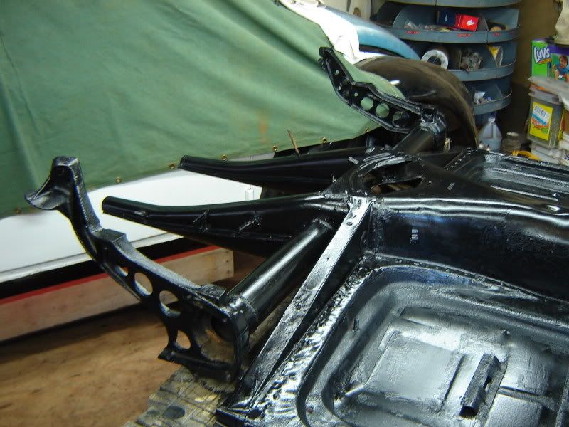

Painted pan...

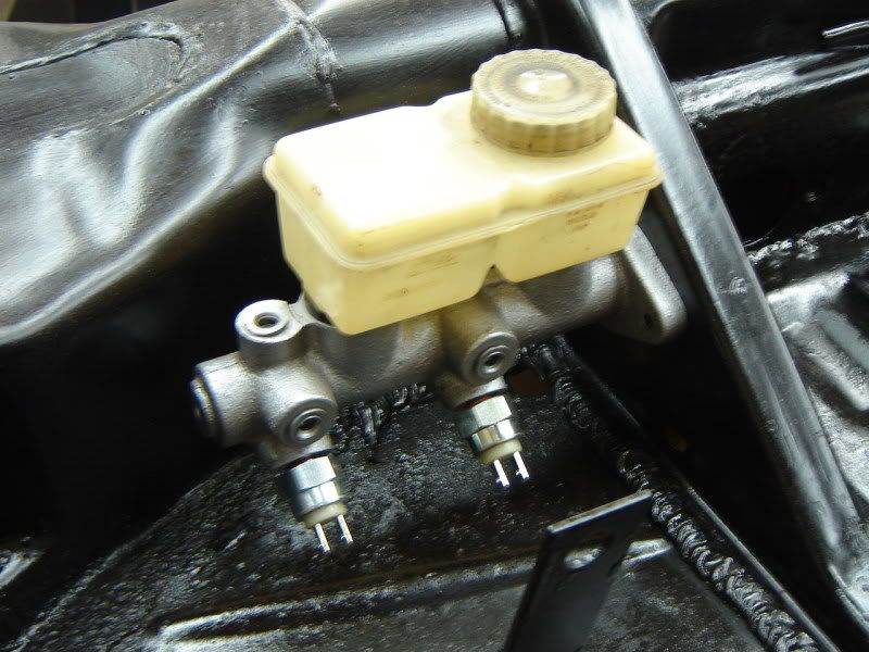

Master Cylinder installed...

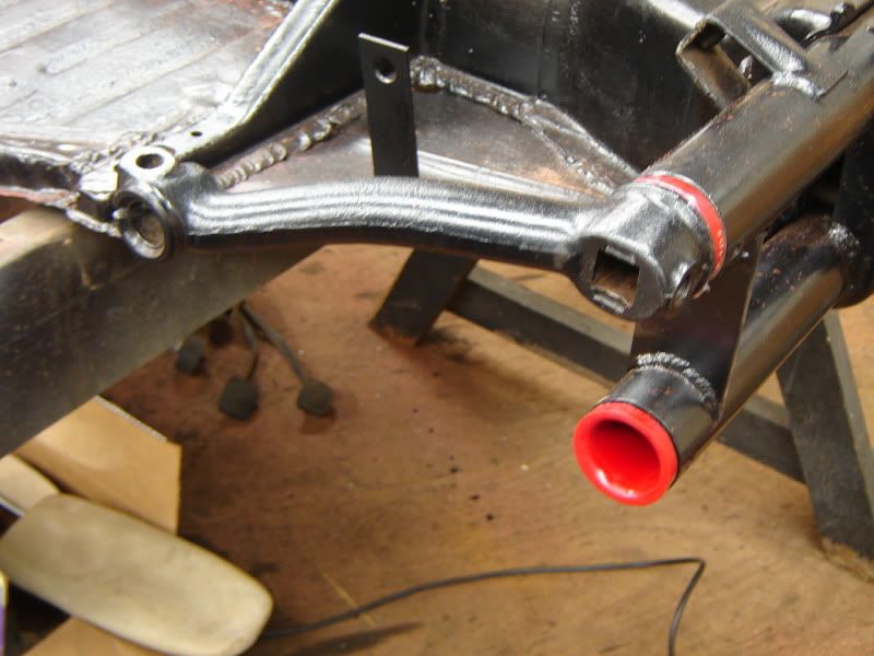

I decided to use the urethane bushings but they are like most products out there... THEY SUCK! I have to grind the outside and then beat the hell out of them to get them in.Then use a roll of sand paper so the arm will slip in, well it doesn't slip in you have to force it. I'll get it together but it will slow me down.

Have you used the Energy Suspension parts before? If so, how do you like them? I only ask because I was considering getting their tranny mounts, since I need to get some. And then I saw those beam kits and saw the prices aren't bad. Over at the samba, some members had said that they are harsher than the OG style rubber, and the beam pieces wear quicker..... but then again there is always negative comments if using anything other than German for most things.

I have used the trans and engine mounts. They transfer a lot of noise and vibration. I got away from them, I had a terrible time with clutch chatter and I think these type mounts were part of the problem. I'd stay away from them. After I run these bushings for a while I'll see if I will use them again but right now having to "machine" them to be able to use them is a big draw back. I think this may be my fault not the products. I may of egged the tube when I added a support near the end of the tube.
