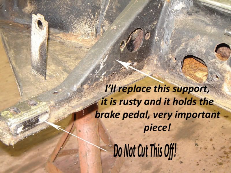

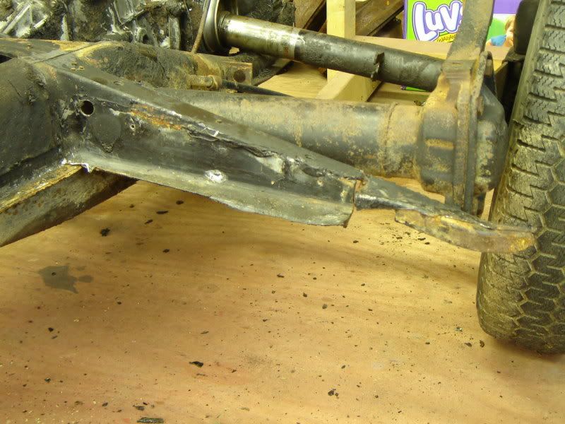

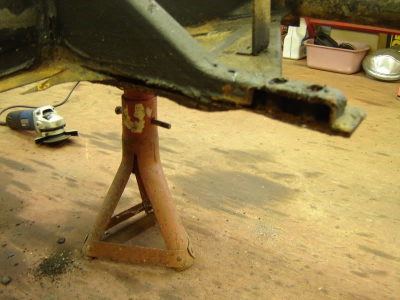

Started cleaning the pan for pan halves. I found a couple things that need to be replaced but this will make up my mind on which way to go with it.
The piece that goes over the tunnel is rusted on both sides and someone cut off the support for the pan.See pic....
Replacing pan halves is not fun but requires elbow grease and sweat!!!
Hammer and cold chisel to knock the old spot welds loose.
I'm still not sure what to do about this area. This support was on the new pan half but it was cut off, why? Beats me!
I may build a piece to attach the pan to and then weld it to the support at the back. If you have old pan haves laying around I would like this piece. I'd take those and the new pan and fix it right! The other side is the same. So I'd need both sides. Other than these issues this car is solid. I'll need to replace the lower A pillar hinge on the drivers side of the car along with a patch in the wheel well.
