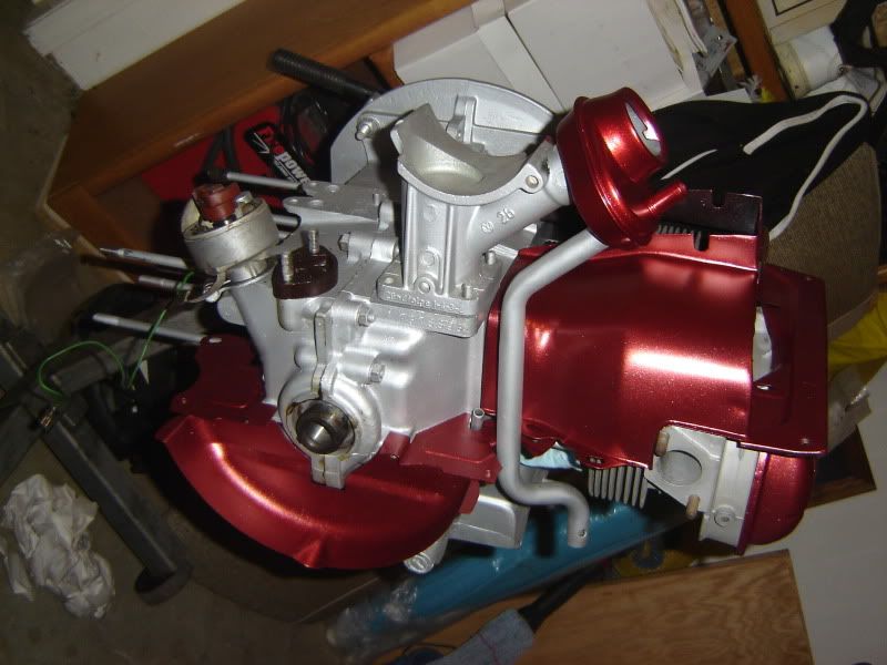

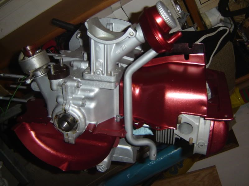

Oh and here is just some test fitting of the tins.
