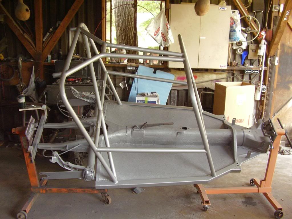

Last Saturday me and big bro went up to Athens and picked up a buggy (Thanks Shane) damn good price. Very Happy It does have some issues, the pans are toast, passenger side of the tunnel is rusted out and several holes drilled in the body.
So Sunday we started the work. Got the body off and the pans cut out. Built a tube chassis and cut the bad part of the tunnel and patched, put in new pans, then built the roll cage.
The goal is to have her on the road by the end of August at a cost of under $1500. Shocked

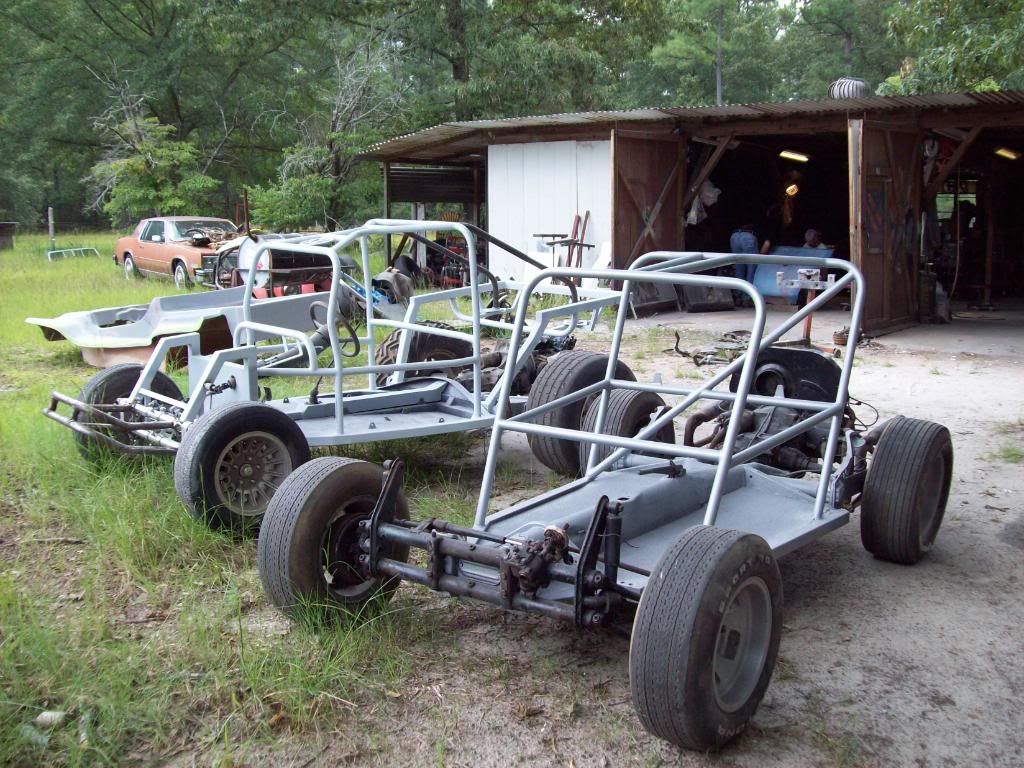

Post by Joe on Sun Jul 05, 2009 8:35 pm

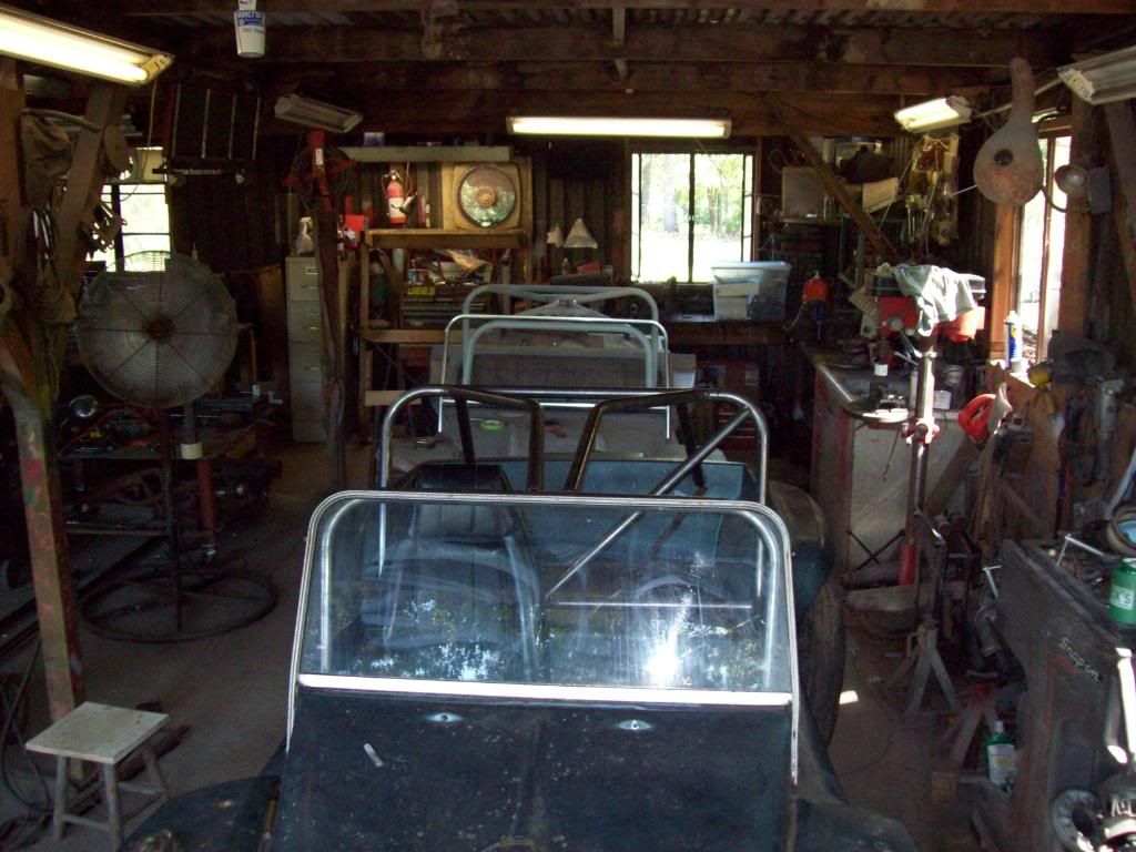

Post by Johnny on Mon Jul 06, 2009 8:32 pm
My bay in the shop is getting full........ Laughing

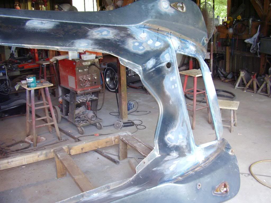

Thanks, Been doing alot of body work the last few days. I noticed the paint was bubbled up in several places around the back and over the tires. So I started sanding and found about 75 holes from the size of a pencil to a dime filled in with bondo. I got it all out and started putting fiberglass back in. Hoping to finish it today.

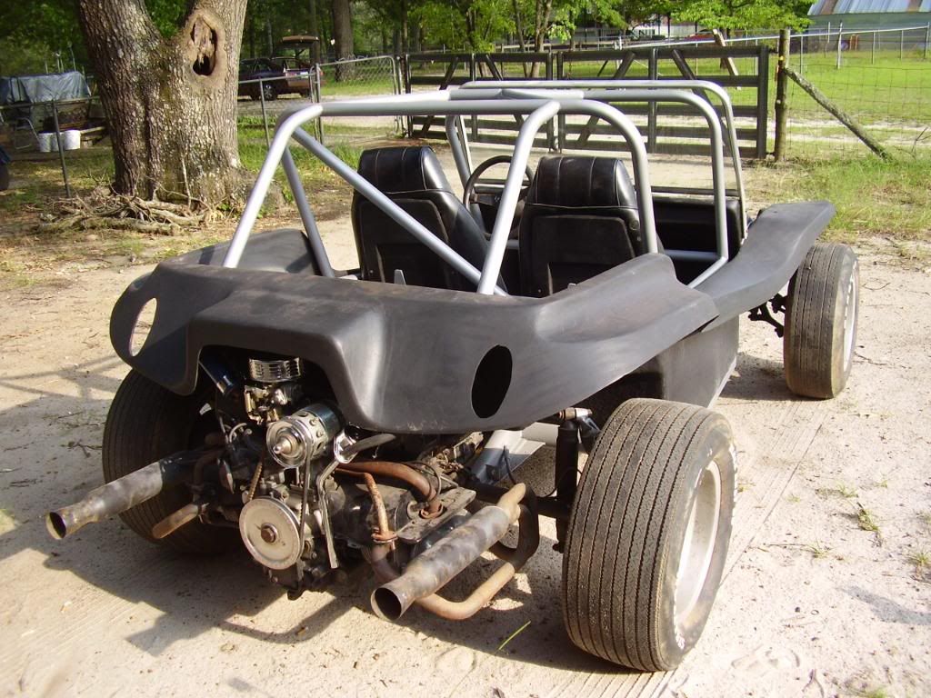

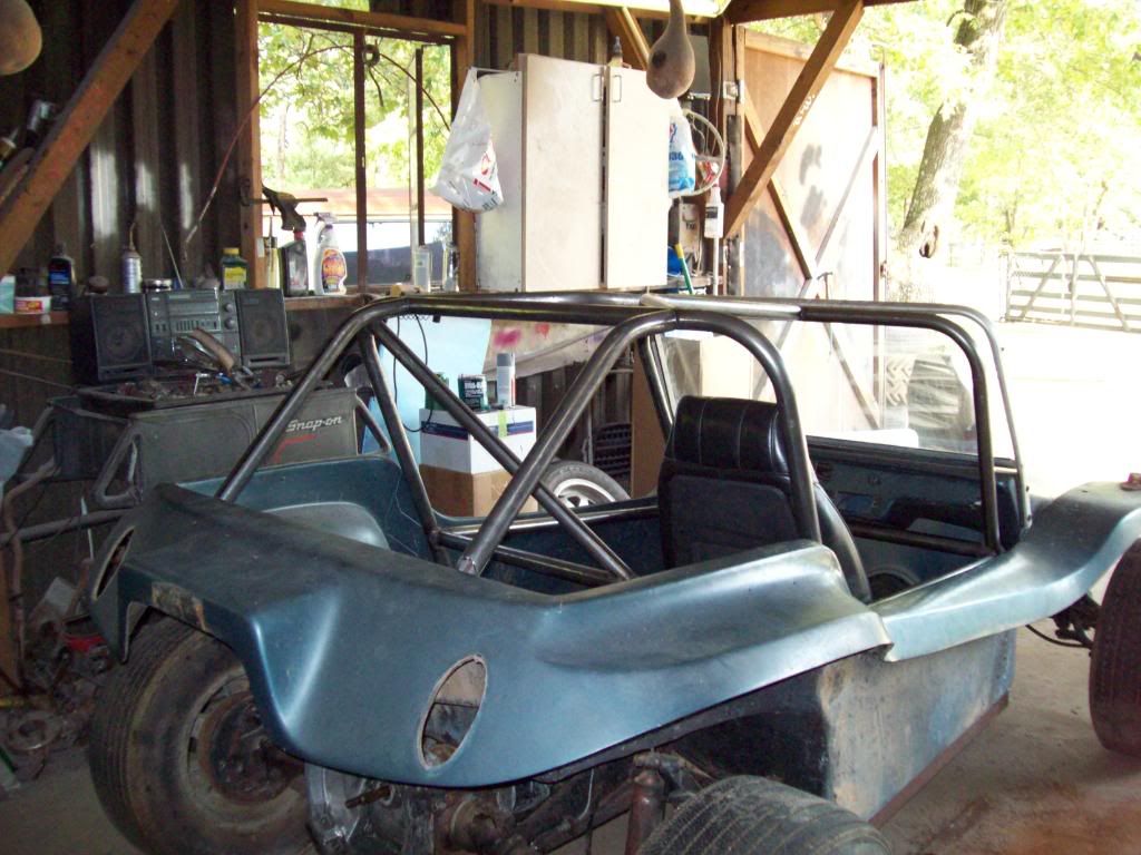

Post by Joe on Wed Jul 15, 2009 10:09 pm
Here are some pics from the last few days

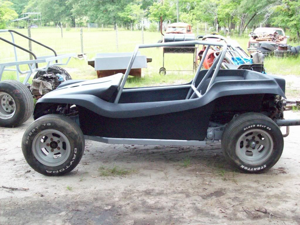

Post by Johnny on Sun Jul 26, 2009 5:53 pm
Not in final paint yet but looks better than when we brought it home....

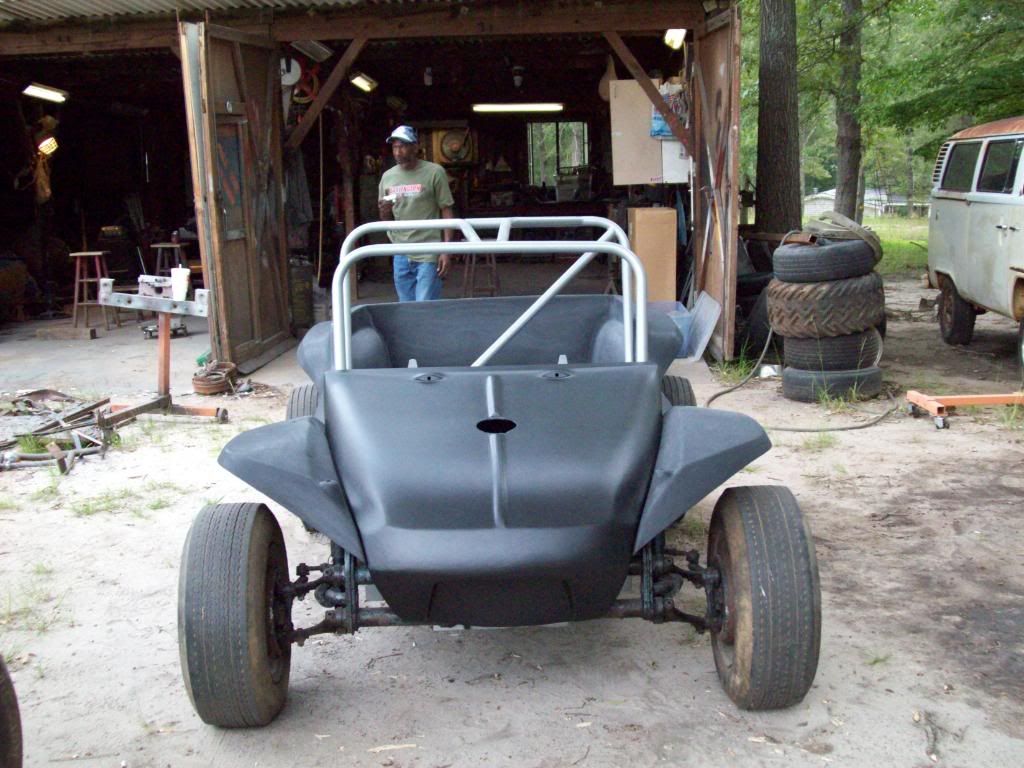

Post by Johnny on Sun Jul 26, 2009 5:55 pm
Side by side look close to the same....

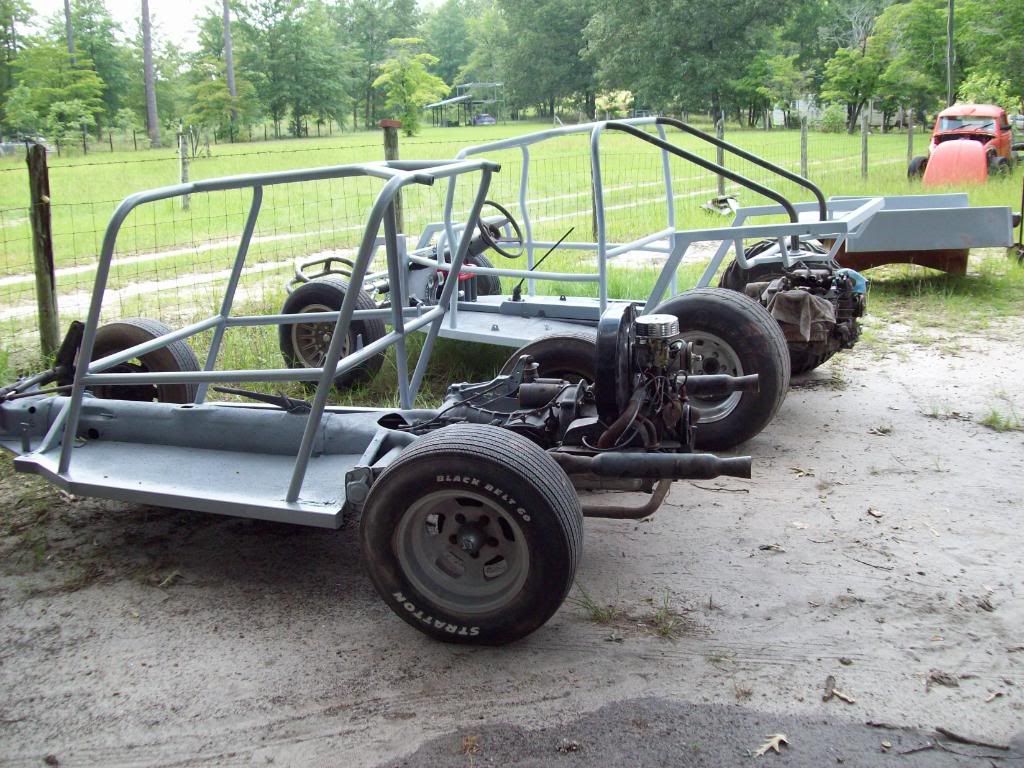

Post by Joe on Wed Jul 29, 2009 7:33 pm
Got a few more things done

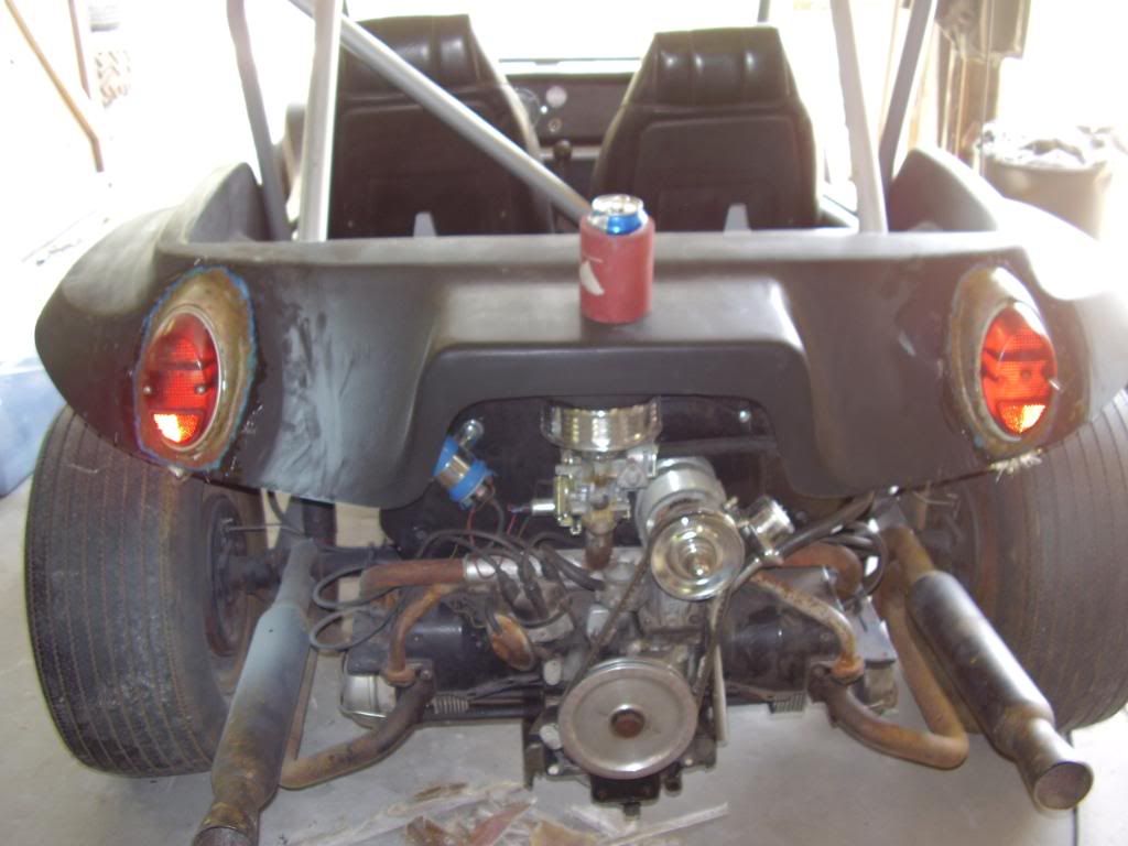

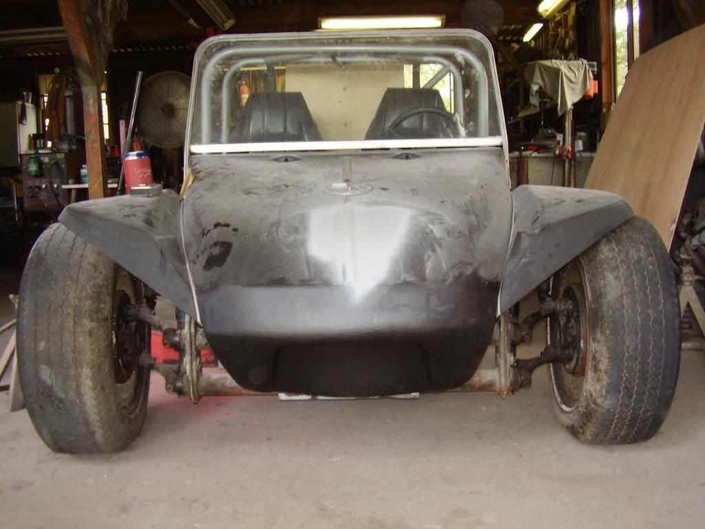

Post by Joe on Tue Aug 11, 2009 8:19 pm
A few more pics from the last couple of days.
Tail Lights molded in.
Back seat area boxed in, now just needs the padding and vinyl.
Narrowed the beam 4" and put in adjusters.
Before
After
