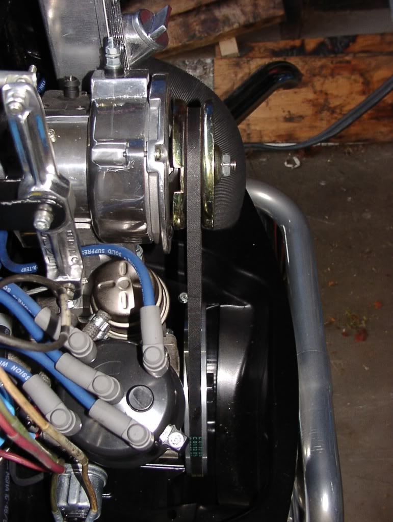

Unfortunately I have seen a lot of alternators built incorrectly. Those pulleys have to be in alignment. Yours is absolutely not right. If the fan rubs when it is aligned, then something about the alternator shaft is out of whack. There is a bushing behind the pulley that should keep the pulley in alignment not matter how you space the fan. About two alternator fan hub spacers is about right normally. Look at the picture I borrowed from the internet. Notice how close the pulley is to the alternator.

Post by JWILL on Wed Mar 08, 2017 8:52 pm
...well I have two of the spacers that go behind the pulley. I could try grinding one of them down Question
